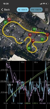

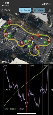

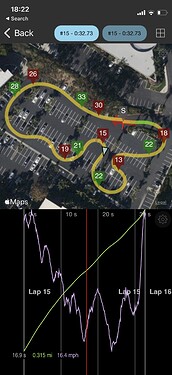

Saturday 2023-09-30 Intro2Speed SD
THIS BOARD IS REALY FUN
First day with a binding. I felt way more confident on the board.

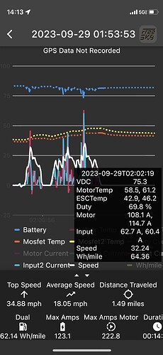

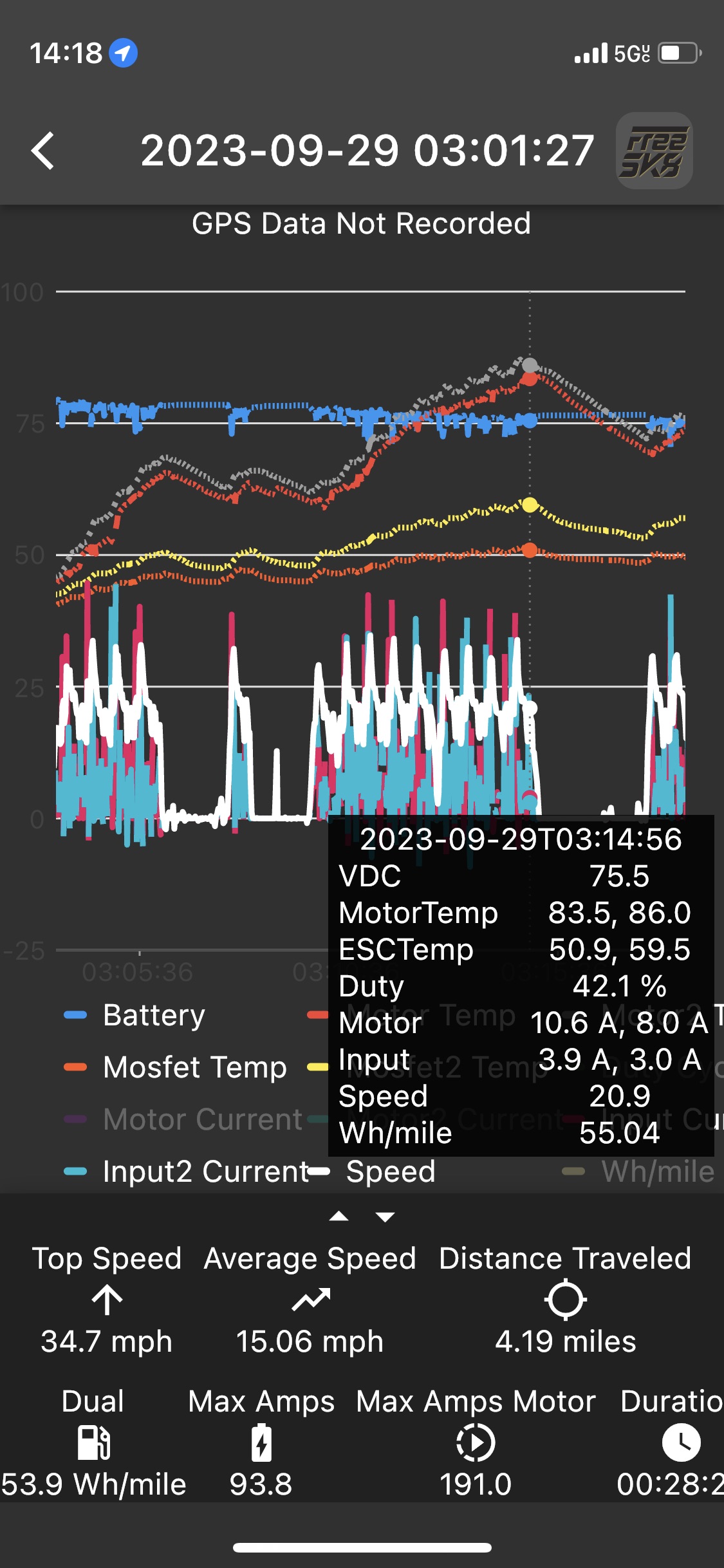

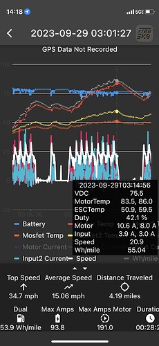

I think this thing is a contender. Tho I only hit 9.8kw and my times were beat by @ShutterShock, Reggie (v5#16), and Jack (16kw bro on srb trackpack) and myself on v5#3. it feels pretty damn good. it was also at a traction disadvantage tires wise, and I loaned it out to Gialong and didn’t get to set a better time on it which I think i could have.
This course had a long straight that I should have gotten more pull on. but my confidence in me was low today. :smiley:
v5#1 (vesc) early runs v5#3 early runs v5#3 warmed up runs
34.60 34.74 32.73
9.8kw
motor temps up in the 80c range.
Gialong ran a lot more laps in a row than me on the board, and temps got up into throttling zone. hmm. probably means they’ll get hot at an AVS style race too.
