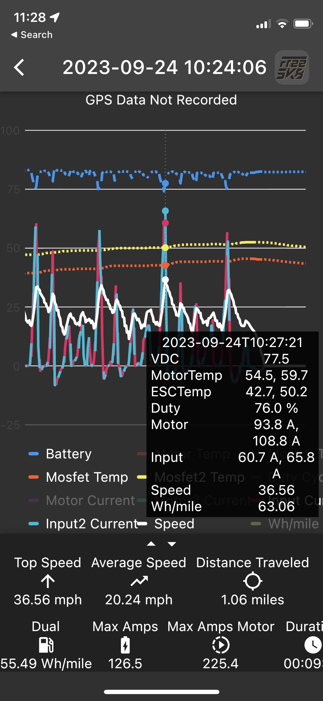

I didn’t end up using all the motor amps (150/side) peak was 130A. and battery peak 54.5A (on one side. for some reason robo was back recording single side. )
It still felt a bit slow to deliver power out of a corner. but since i wasn’t maxing motor amps, this could perhaps be something throttle expo tweaking could fix.
of more concern, it felt a bit like the throttle ran on a bit sometimes when you let off. So I’m going to try swapping out the OSRR/uart remote for a GT2B so it’ll be more the same as my v5#3 castle setup.
Track sessions are a bunch of 2 - 5 min run, before pausing.
temps were not bad. and cooler than the street run temps.
Motor temps got up to 73c (161f)
Esc temps up to 46fc (115f)

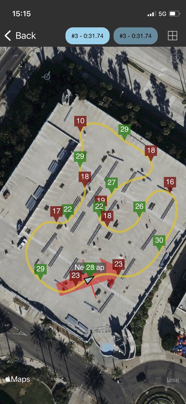

v5#1 (vesc) 33.06s
V5#3 (castle) 33.03
SRB SS#01 (single motor, hobbywing max) 31.74
SS#1 has 45A rear tires, vs 50A i was running on the other two boards.

me V5#1 me V5#3 mario on super spine
33.61 32.66 29.72
didn’t push new amp heights. more flow less slow corners into straights less aggressive riding.

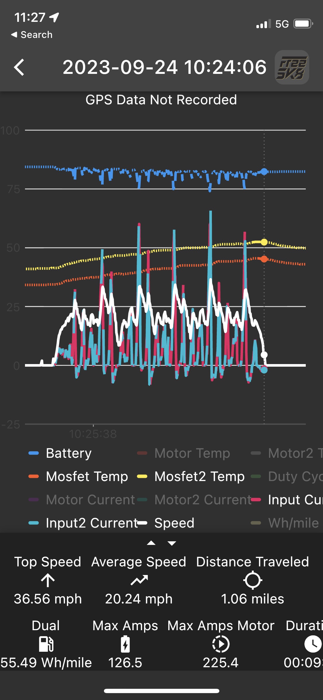

last Sunday 2023-09-24
ran chi track. ( see Chicago | T-Race - Global Electric Race Challenge )

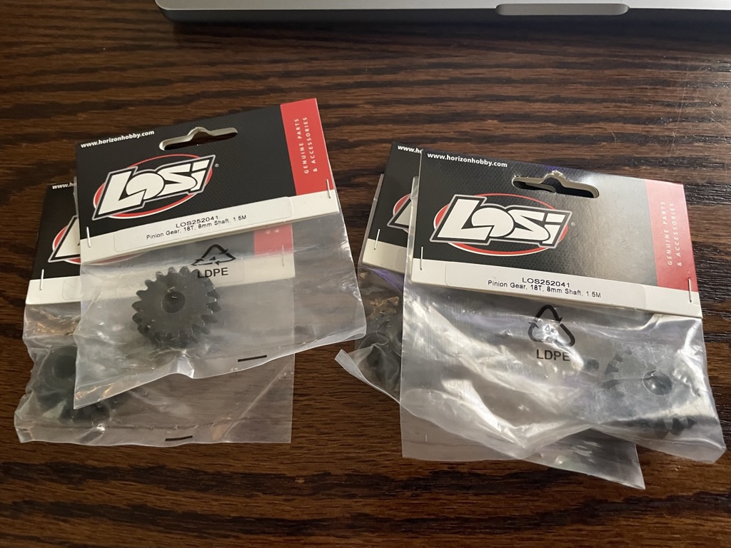

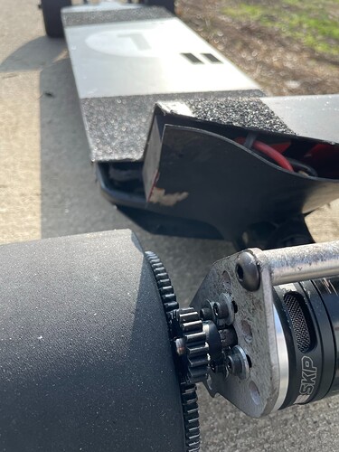

EDIT: first time out with new gearing 18T/78T down from 21T/78T

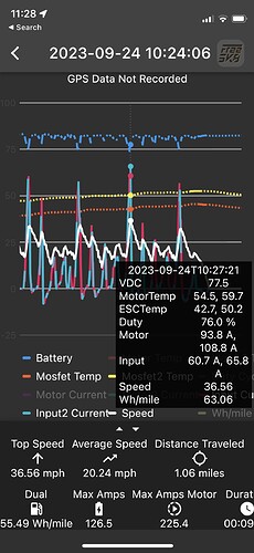

motor temps getting 60c - 75c on 5min runs. definitely climbing the whole time. This might explain why the street run got to higher temps I just rode longer without a break. (Edit: or it’s the better gearing keeping it cooler this time) plus i still hear @Tony_Stark in my head saying i’m gonna cook em. xD

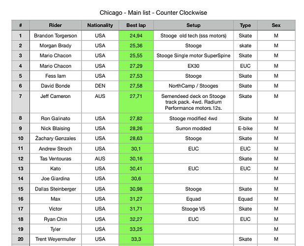

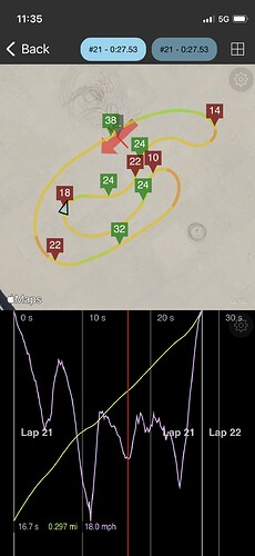

best laps v5 vs v5:
still didn’t put the goofy footed binding on.
it felt even more of a handicap on this track. and it shows in the best laps comparisons.
v5#1 (vesc) v5#3 (castle)

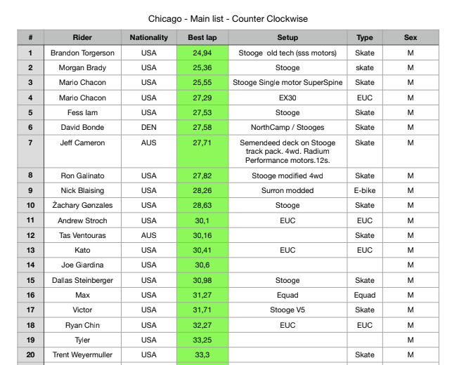

30.74 27.53
30.74 would currently rank 15th.
hey i beat @dskate :P, there you go. vesc beat out castle. just joking, not a fair comparison, @dskate’s time was from a fun run at night sesh
i peaked 9.8kw on v5#1

Did you ever change the gearing?
OH crap Yah I updated the gearing, forgot that update. this sunday was the first trial of it.
18/78T now with 49mph top speed.

This is shockingly close to my bn gearing haha
