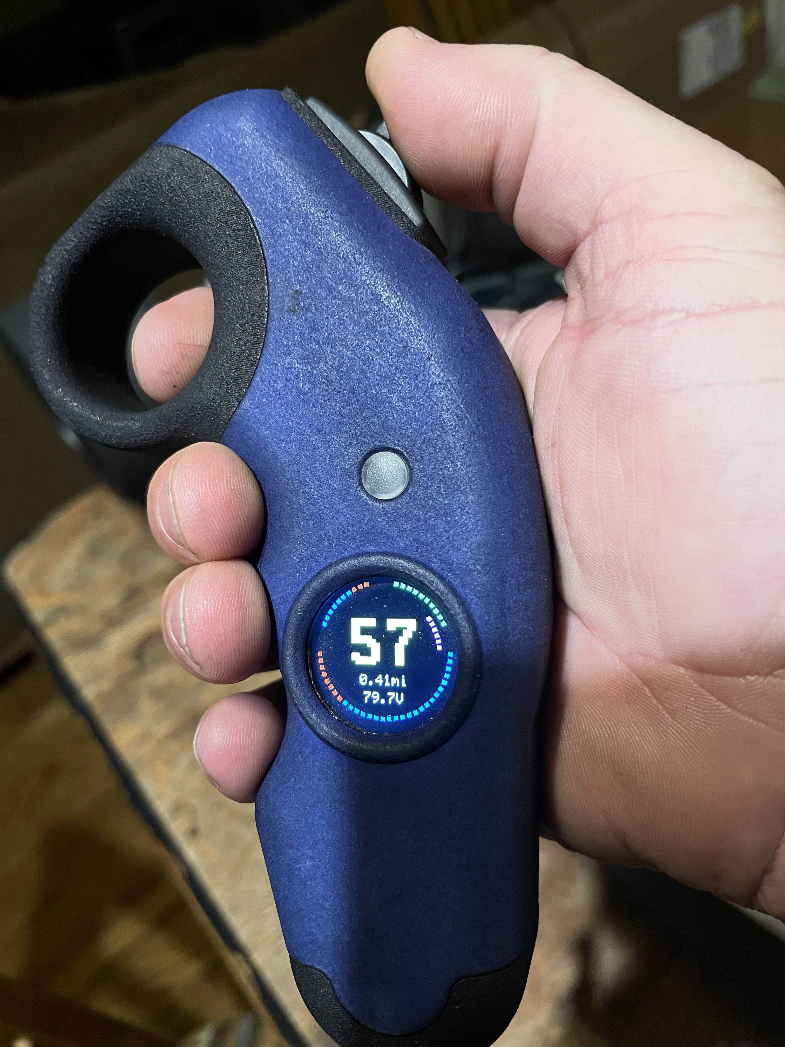

 no load speed of 57mph is quite a bit more than the 49 top i was expecting.
@DEEIF are you sure these are the 151kv? and not the 173kv? @Skyart any way to tell?
yes tito.
The teachers say their kv on the face that you bolt on
hmm. have to wait till next time i pull it apart. they hvae 40mm to 30mm adapter plates covering that spot.
