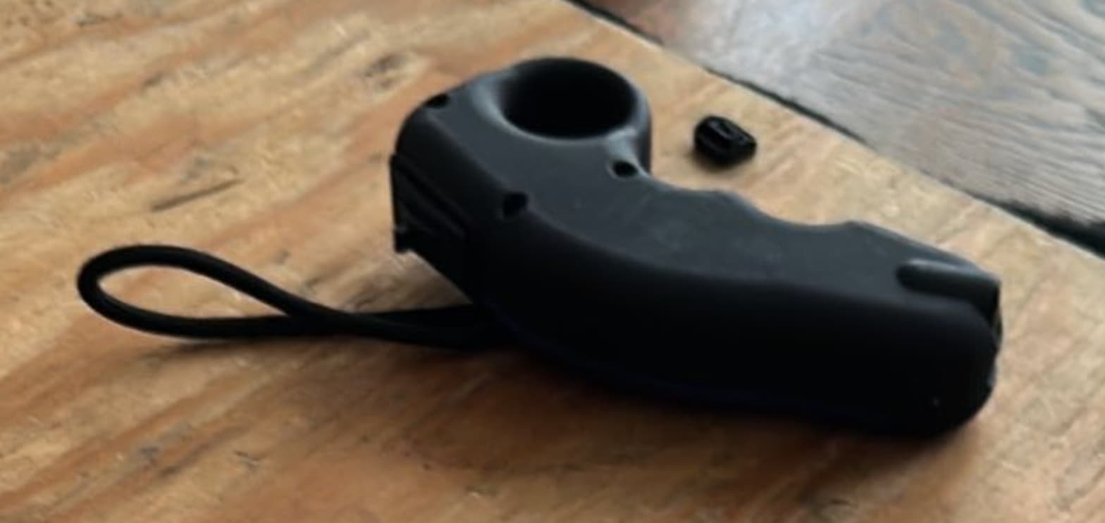

well, today’s testing was scuttled because I left my remote at home and drove to san diego with the board.
strangely, no one had a OSRR to borrow.
Time to put in a backup puck receiver.
Oi…talk about rotten luck
Check your PM :slight_smile:
