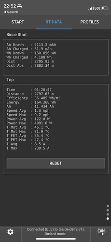

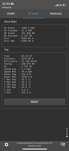

Primary side shows stats for both sides, so not much reason to set that for the secondary side.
How is primary side determined?
you’ll note in these two examples, wattage is 4k/side. if primary were showing stats for both then one side should be 8k, and the other 4k no?
also the two sides distances are just off by the gear ratio difference that was misconfigured.
2797/4.33*14.33 = 9256.584 so the distance stat also isn’t reported for both sides by a ā€œprimaryā€
so i don’t think this example shows a primary showing data for both sides.
but i do find this confusing:
so i feel like there must be some way vesc_tool reports for multiple ESCs combined.
The side with the Bluetooth module, only that side will be populated with gear ratio etc. after detection.
For me it always shows total board power, not per side.
Highest I’ve seen is 5500w, and there’s no way I’m doing double that on a 12s board with constantly overheating motors :sweat_smile:
Why you got to @ me like this :joy:

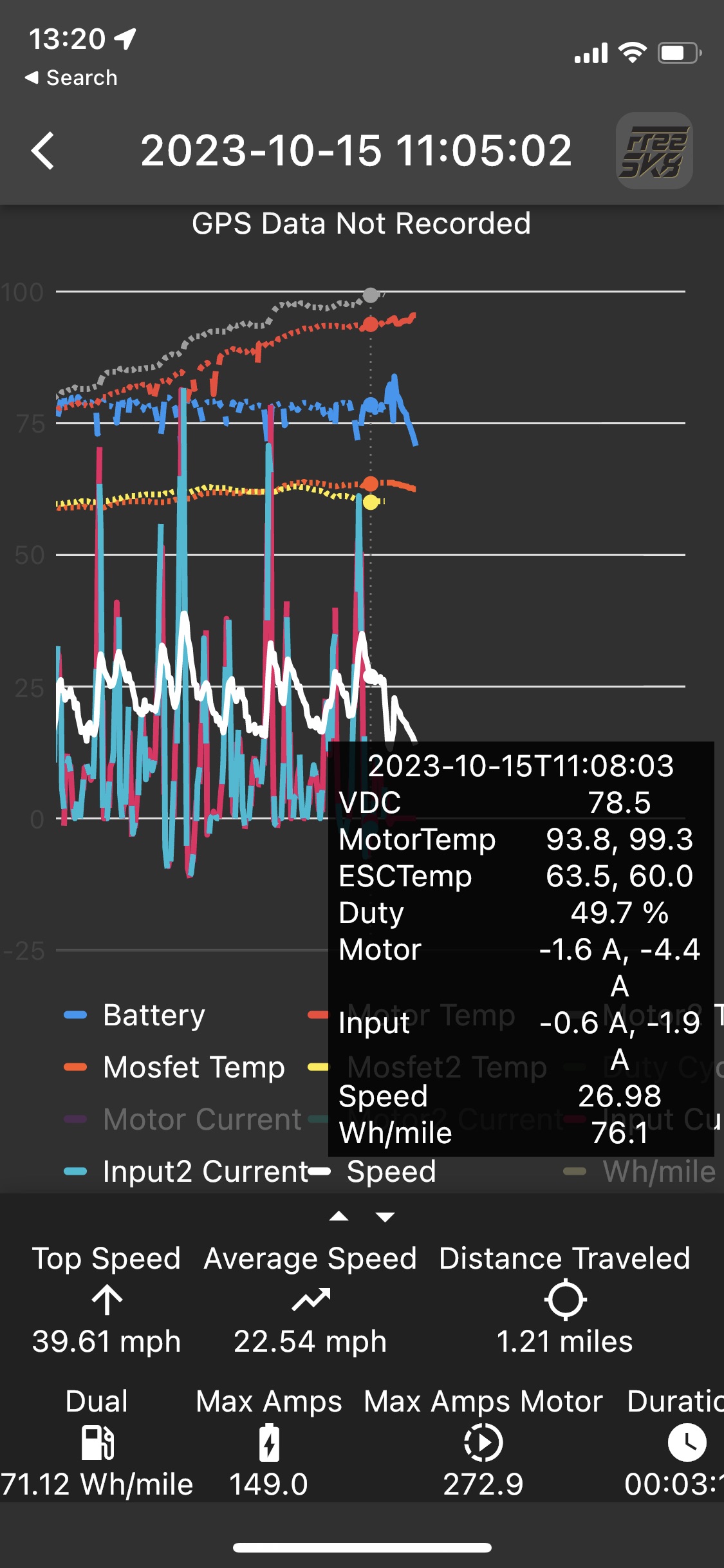

I’ve got vesc tool app screenshots from after racing Ankle Wreacher, and all four esc report a max power of 8~9kW, but each of the exact reported powers are different by a few hundred Watts.
If it was reporting the total of all four VESC’s shouldn’t these numbers be the same?
But I also don’t think I was pulling 32kW…

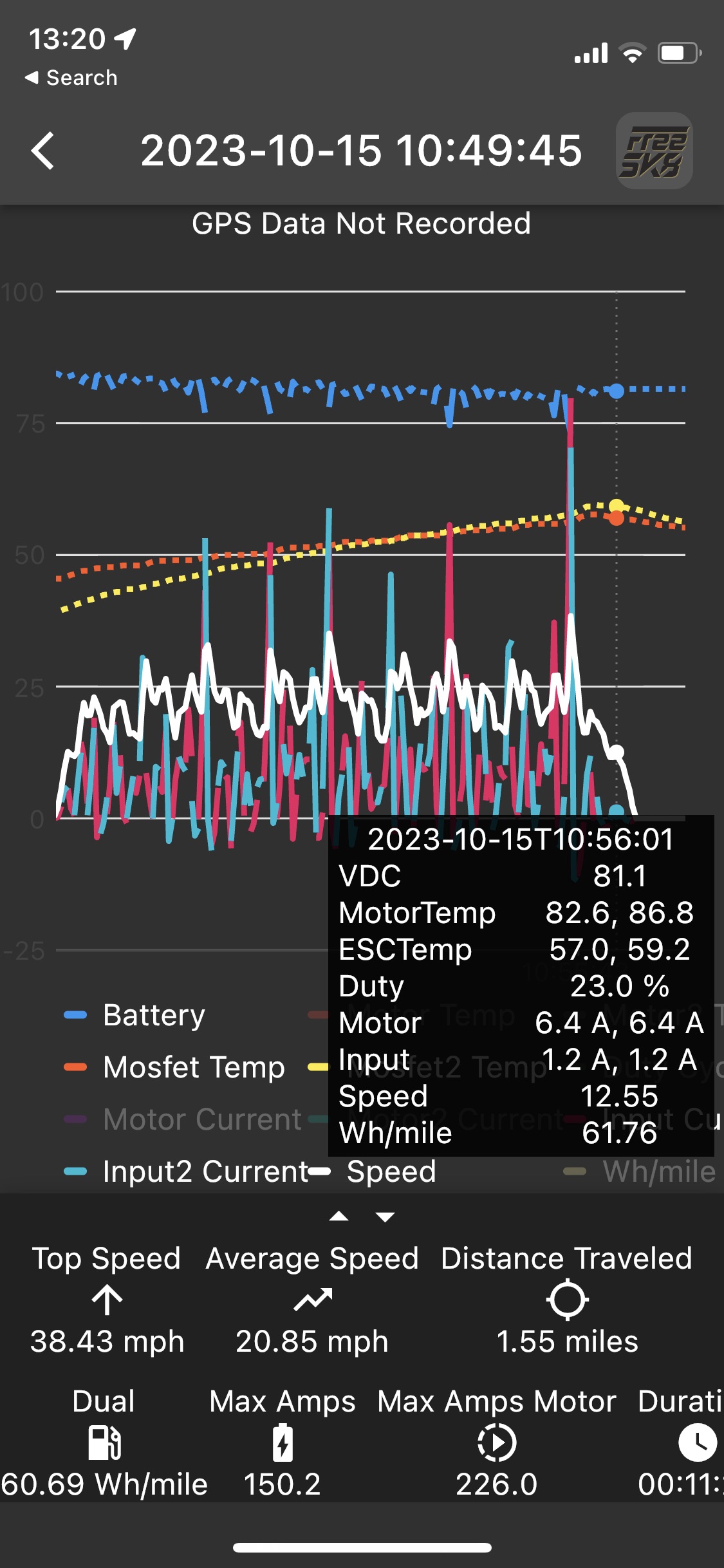

I pulled harder but stil peaked only a combined 273 motor amps. didn’t bump against the 150A/side
feels good. v5#3 still feels more punch. not sure why if i wasn’t hitting these limits, feels like i didn’t ask it for more.
was too hot, and the day got away from me, and I only did track riding no specific drag. before breaking things… ( see below. )
motor temps and iron losses.
Motor temps got up there on this bigger track and a hotter day, 80c - 99c :hot_face: :sweat_smile:
ESCs seemed to do ok. peaking 60c
also peaking 71 wh/mi

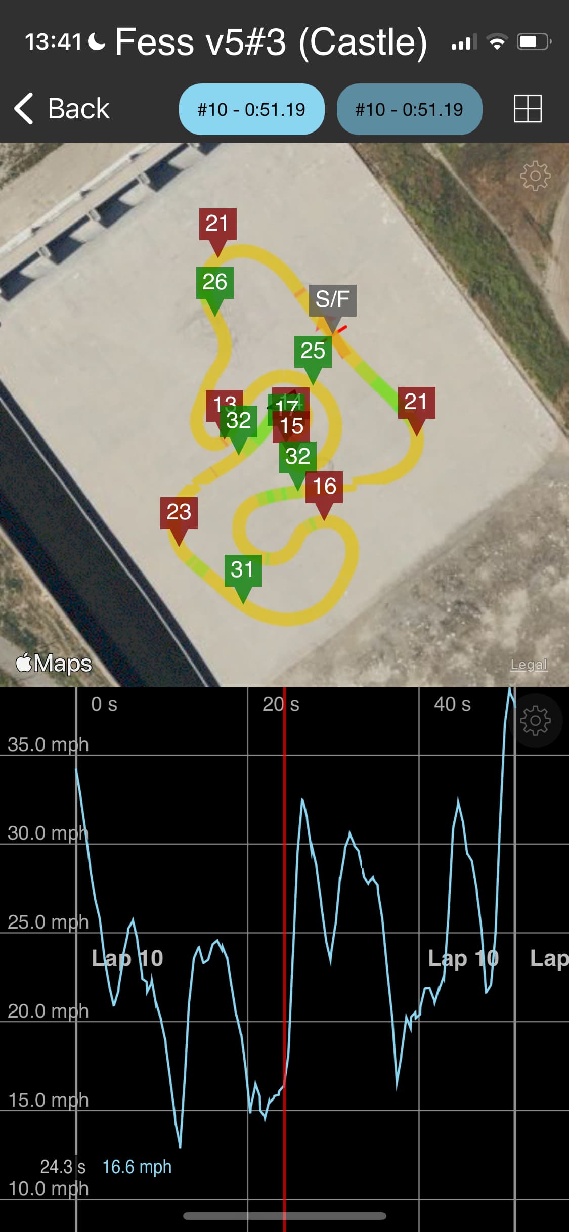

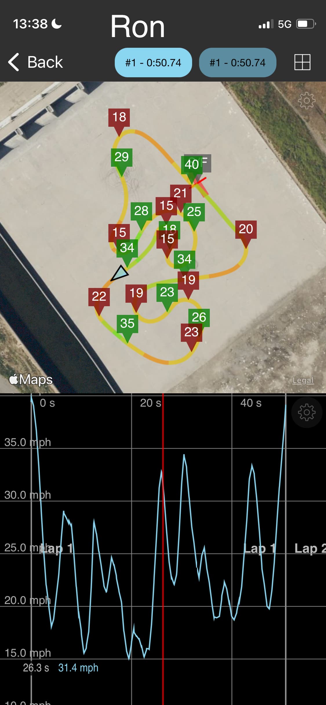

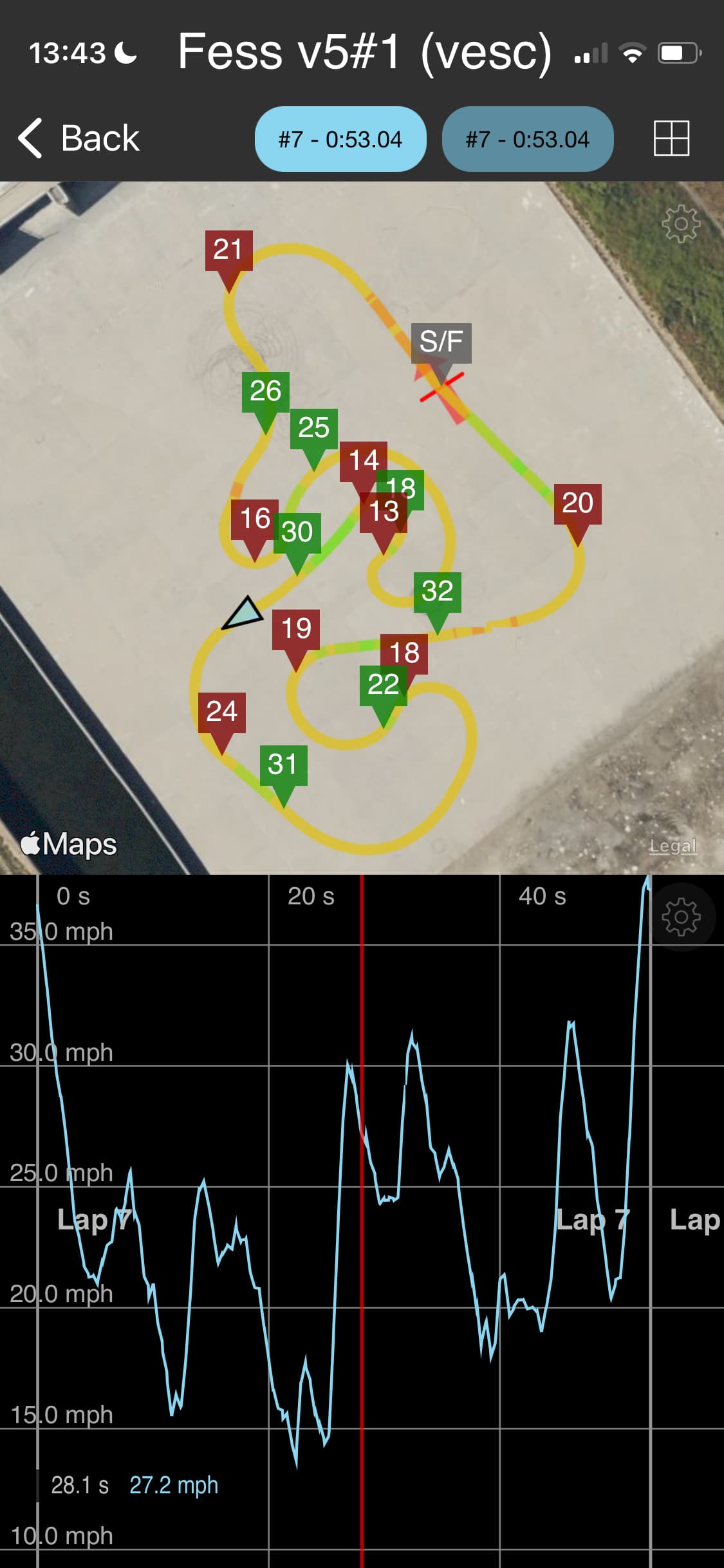

best laps
v5#1 didn’t get a chance at more warmed up laps. but initially it had top spot vs v5#3
fess v5#1 (vesc) fess v5#3 (castle) @Ruxx v5#10 (castle) @MetroLinkX4 (ron) v5#8 (awd vesc)
53.04s 51.19s 49.80s 50.74s

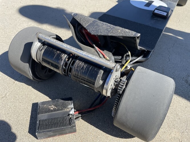

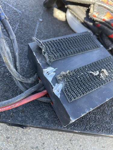

So i received the board with the ESCs temporarily mounted with dual lock velcro and a strap rear around the foot stop. I told myself once i got it going i’d come back and mount it with bolts. I kept kicking the strap off so from the very beginning of this thread i’ve been running without it. and everything was ā€œfineā€
then promptly forgot to get back to mounting things with bolts.
until. i took this thing up the dam wall. and… had to coast down. dragging some clanky metal. behind me.
No @MoeStooge gears were harmed in the eating of this heatsink.
Suprisingly. I plugged everythign back together. and it all continues to work. yay.
@DEEIF’s didn’t seem happy. xD said ā€œthat’s what the strap was forā€.
makes sense.
sry @DEEIF will make it up to you somehow.

my first bunch of laps got me dialed in on v5#1 (vesc)
I actually then felt very uncomfortable switching back to v5#3 (castle) throwing my balance off in corners till i adapted again.
So… I really think Familiarity Bias is a huge thing when trying to compare these two things.

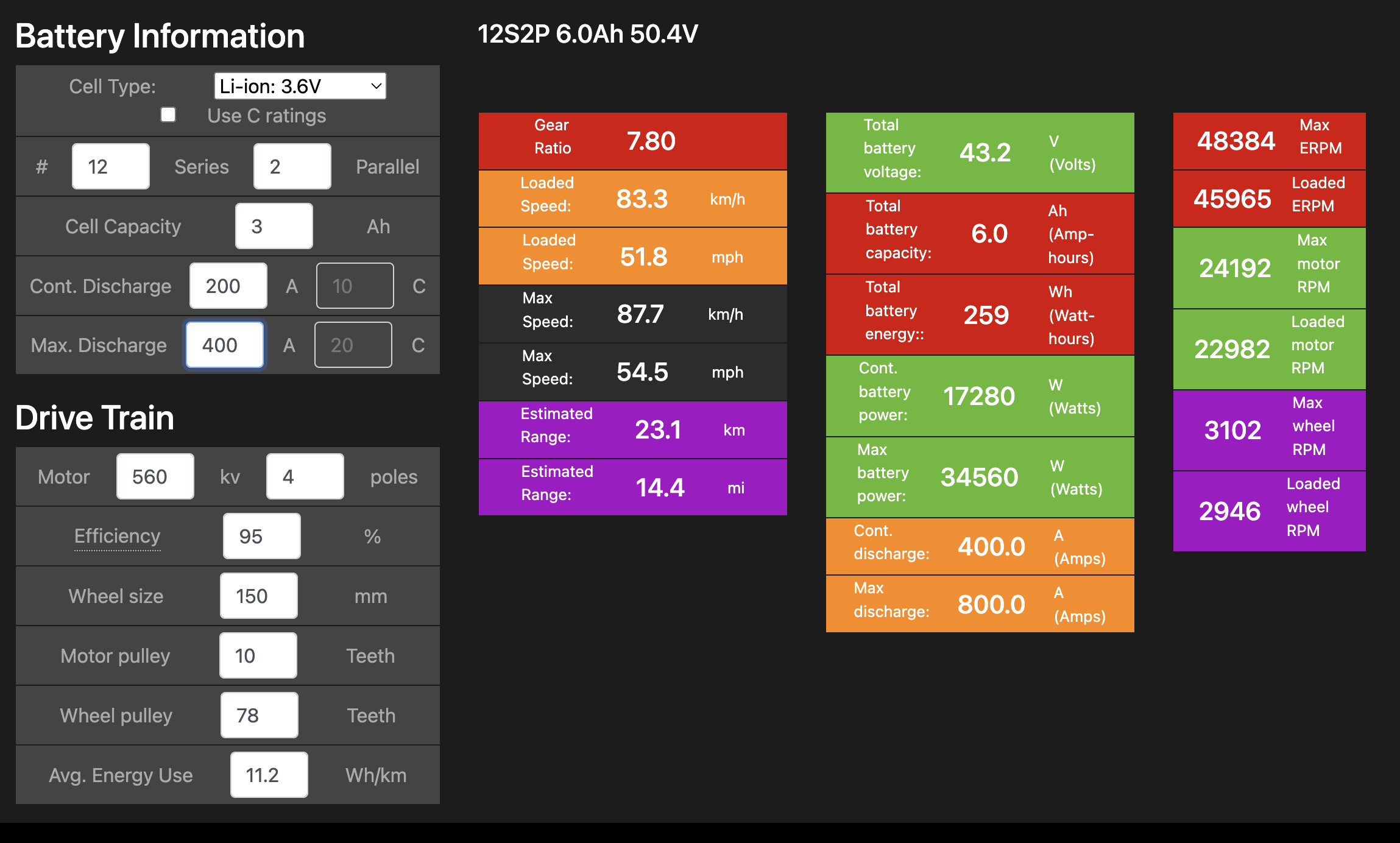

could maybe get up to 12s with 10t/78T gearing and the 70125 hobbywing motors. and still be reasonable. (though i really wanted to leave those 10T gears behind they wear fast. )
Then a pair of go-foc 300s at 12s could deliver the watts? they might be able to do it at 8s even. which would help gearing.
