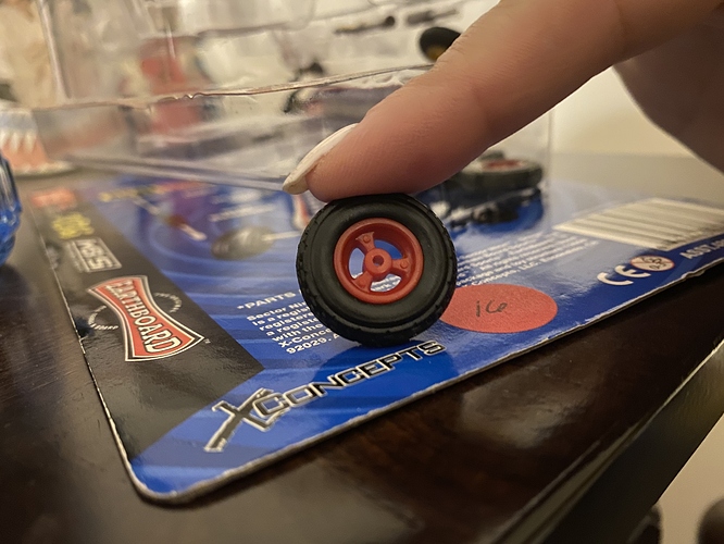

These were not a very good ride.
Trim your nails Mike. Ladies don’t like that.
