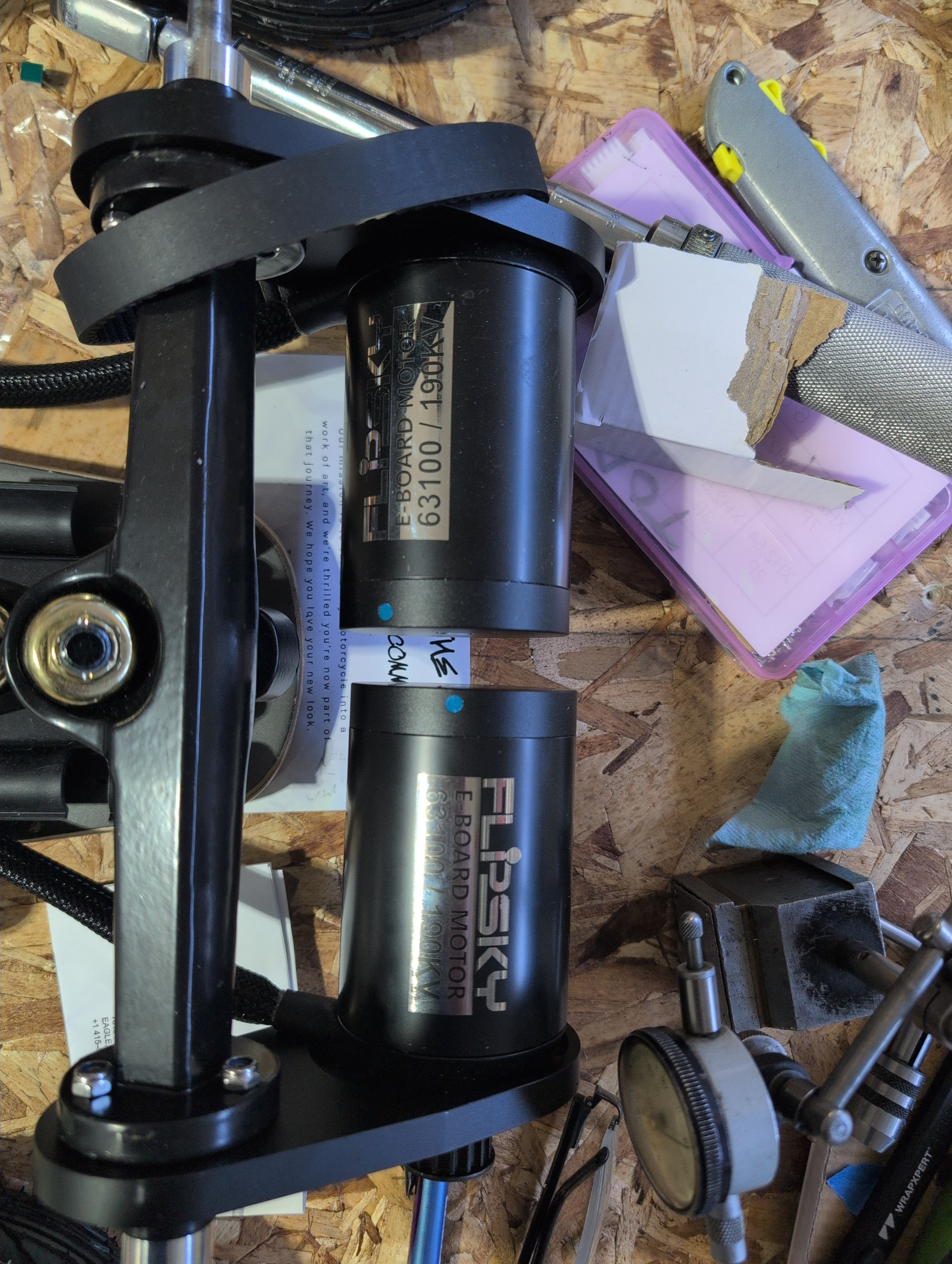

Parts I have:
  1. D100s ESC
  2. (2) 63100 190kV
  3. 16 T gear
  4. 60 T wheel pulley
  5. 15” DKP trucks
  6. 175mm Pneumatic tires

Do you already have motor mounts for your trucks? Do you know if the 63100’s will have clearance to fit next to each other on those trucks/mounts?
63100 seems like a lot more motor than really necessary. 6384s are a more common motor size and unless you get non flipsky motors the stator size doesn’t increase enough to really provide a higher amperage rating - iirc flipsky only rates the 63100 5ish amps more than the 6384. Maybe it could get you a little more thermal mass? Hopefully someone who has played more with those motors in a direct comparison can chime in?
These 2 homies are right. I give my mushroom stamp of approval
Yeah get the 6384. Larger sizes tend to have more issues over time.

My understanding is the 63100 yields better torque. Speed is not my goal. If I can get everything together and just ride it, then can determine what my likes and dislikes are.
I’ve had really good luck with Flipsky 63100s. They’re screamers, but they perform well when they get hot.

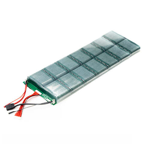

Thanks for the recommendation, placed my order for the Odachi V2. :call_me_hand:Now, need to find a 14S4P battery and BMS… suggestions are greatly appreciated.
Please chime in on your thoughts about this battery.
14S4P $725.00
These are legit
Only thing is they don’t come with a smart BMS.

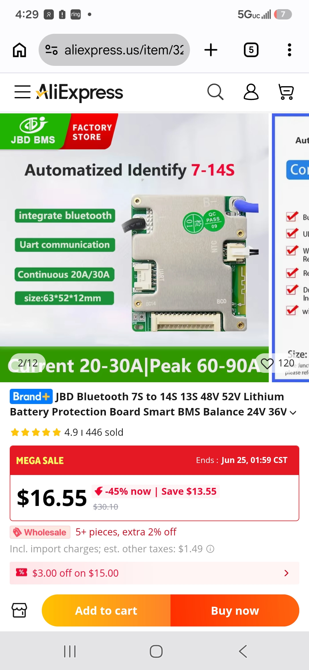

Which smart BMS do you like. I’m still a little confused about discharge bypass. Is this a preference or a stand practice?
Most of us bypass the BMS for discharge.
And only use it to charge, balance, and monitor cell groups.
Jbd I think is the new go to.
It’s tiny and doesn’t need a separate Bluetooth dongle.
https://www.aliexpress.us/item/3256806084484349.html?src=google&snps=y&src=google&albch=shopping&acnt=708-803-3821&isdl=y&slnk=&plac=&mtctp=&albbt=Google_7_shopping&aff_platform=google&aff_short_key=UneMJZVf&gclsrc=aw.ds&albagn=888888&ds_e_adid=&ds_e_matchtype=&ds_e_device=m&ds_e_network=x&ds_e_product_group_id=&ds_e_product_id=en3256806084484349&ds_e_product_merchant_id=639729577&ds_e_product_country=US&ds_e_product_language=en&ds_e_product_channel=online&ds_e_product_store_id=&ds_url_v=2&albcp=20542171667&albag=&isSmbAutoCall=false&needSmbHouyi=false&gad_source=1&gad_campaignid=18545443176&gbraid=0AAAAAD6I-hGumAixI3Q3SHVPjxxVMvMVw&gclid=CjwKCAjw9NjRBhATEiwA_p2J8RIxx7TWSmKnnM_HHwbRmObaY7B5gLWScG0PEwJa584W-mI3m0lI_xoCB_kQAvD_BwE&gatewayAdapt=glo2usa
Good discussion here Discharge via BMS or Bypass BMS? [SRO]
and plenty more under the search button
