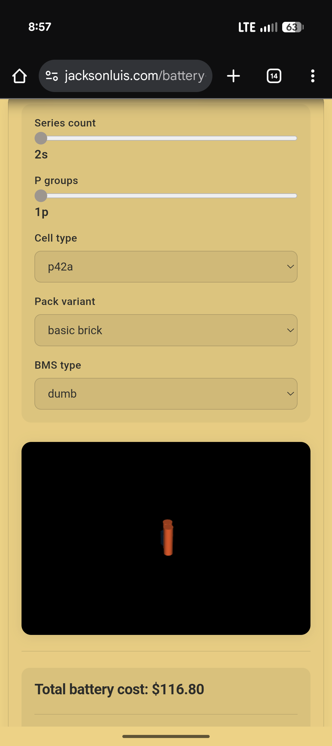

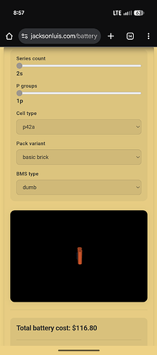

Prices for packs can be estimated using my Battery Quoting Process. This tool is nowhere near done and may give you prices higher/lower than what we will agree on at the end. Made by @unknownuser, so if you hate it yell at him.

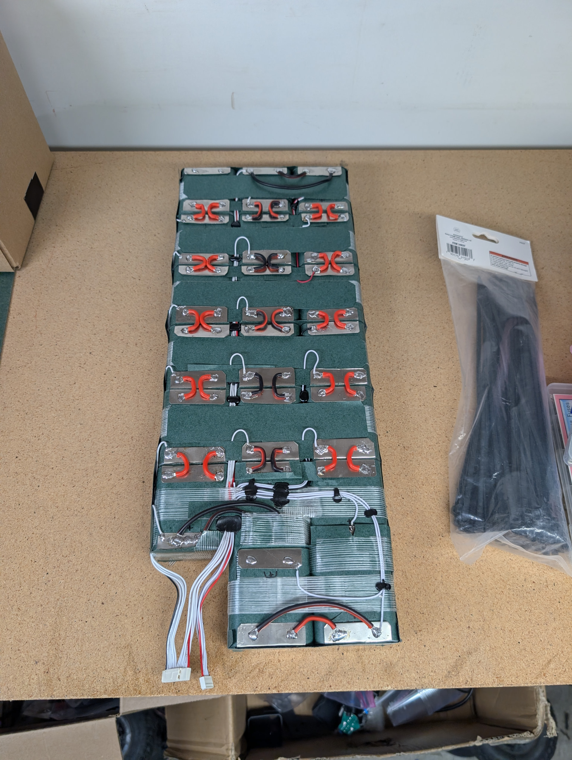

Delivering this pack to @unknownuser soon.
20s6p RS50 pack
You should probably figure out which user you’re delivering this to
I will gladly volunteer to be a @user of this pack.
Cannot promise to use it nicely tho.

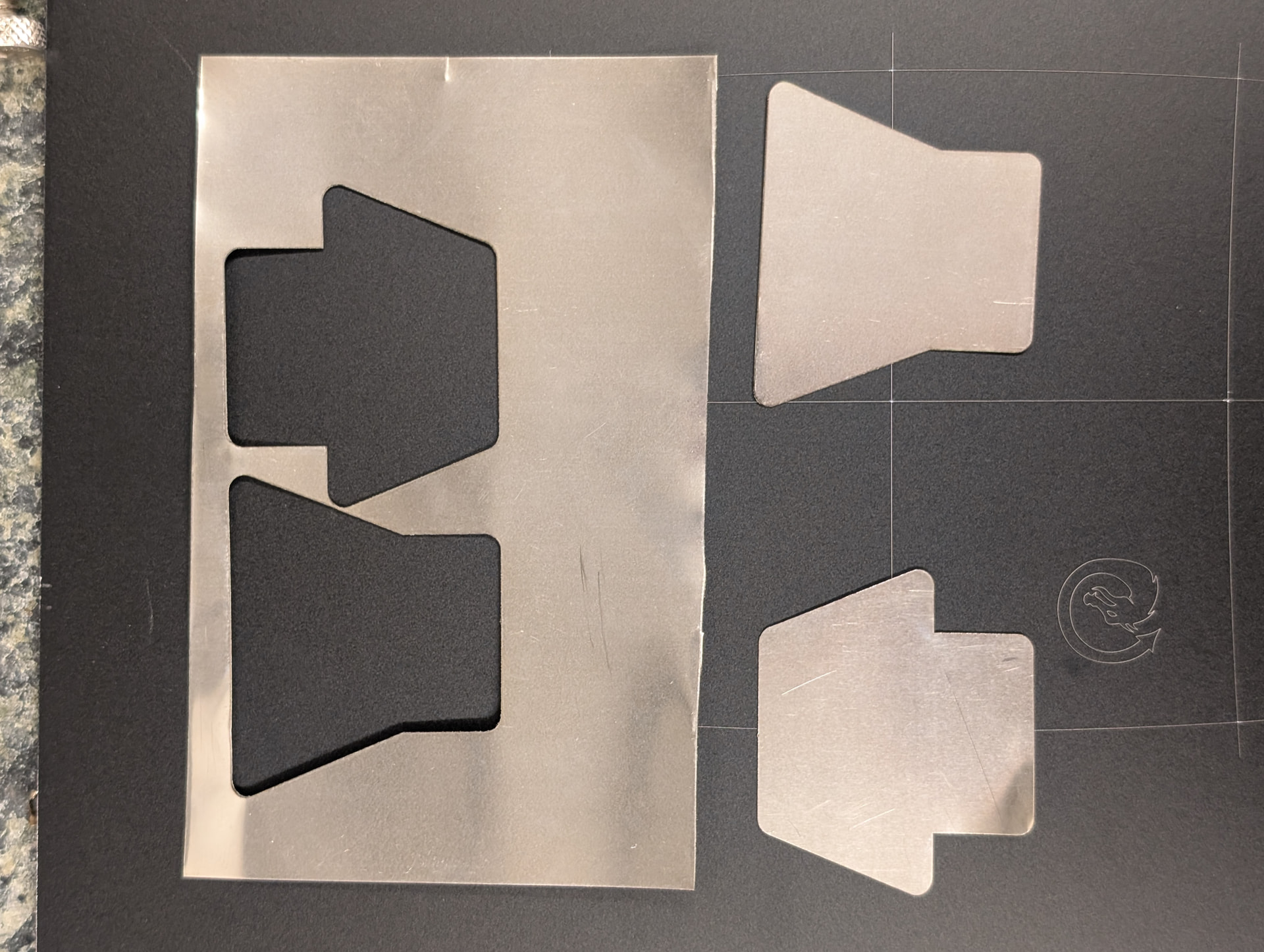

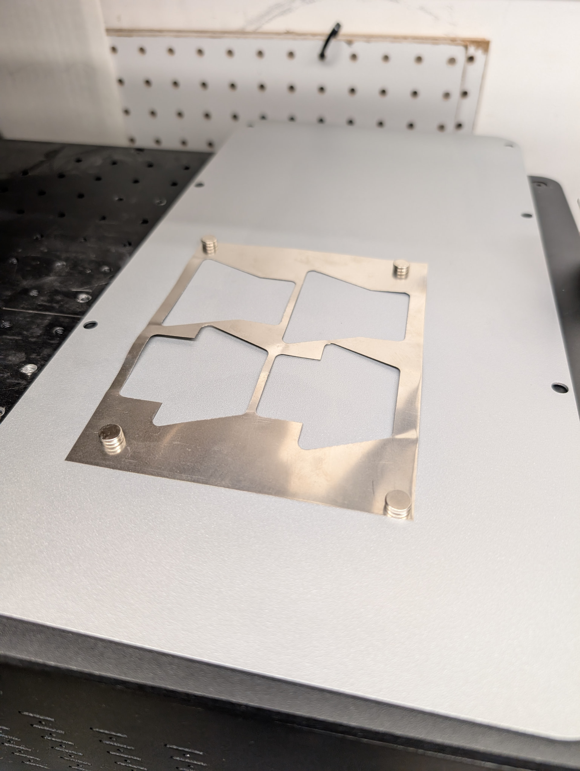

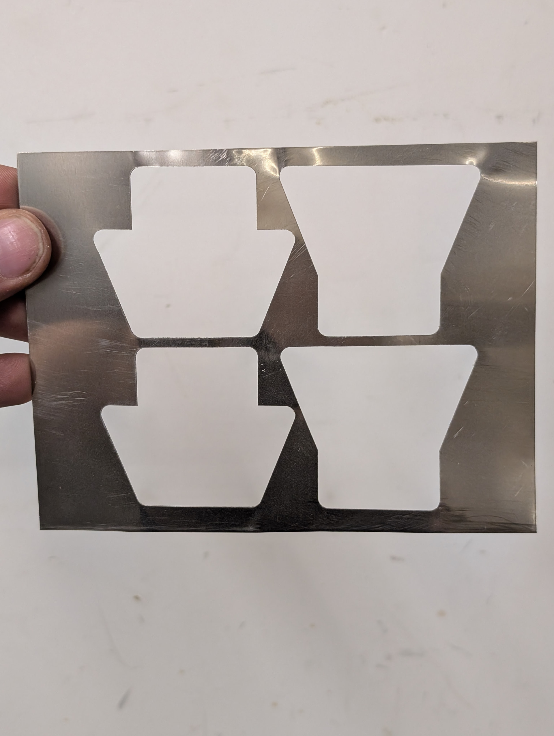

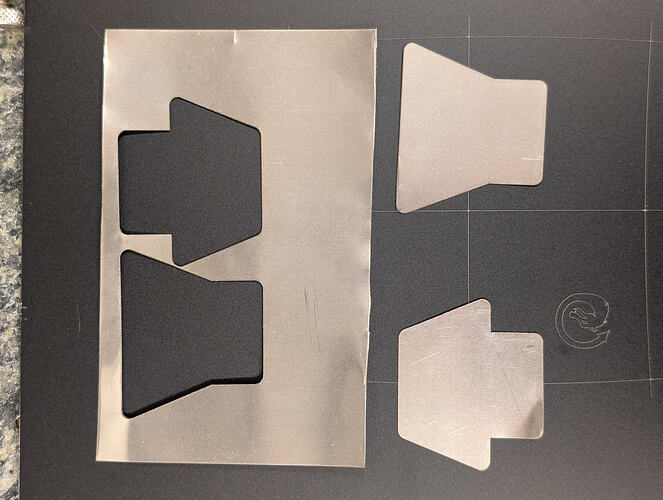

I got a crude laser cutting setup working. Next is a 20S5P ‘Denali’ pack for @yoyotinker . I hand cut the nickel for my Denali pack and it was torture.
Looking forward to it!!
How many passes does it take?
why did you choose sharp corners if you’re cutting with a laser? :thinking:
Have you tried holding the copper down with magnets?
Considering it is the Denali pack, I claim ownership of it. Let me know when you can ship it out.
OMFG DUH why haven’t I thought of this. Doing this asap.
10-20. Lower if I can keep the nickel flat.
Rounded corners, cleaner cuts.
Hell yeah :ok_hand:

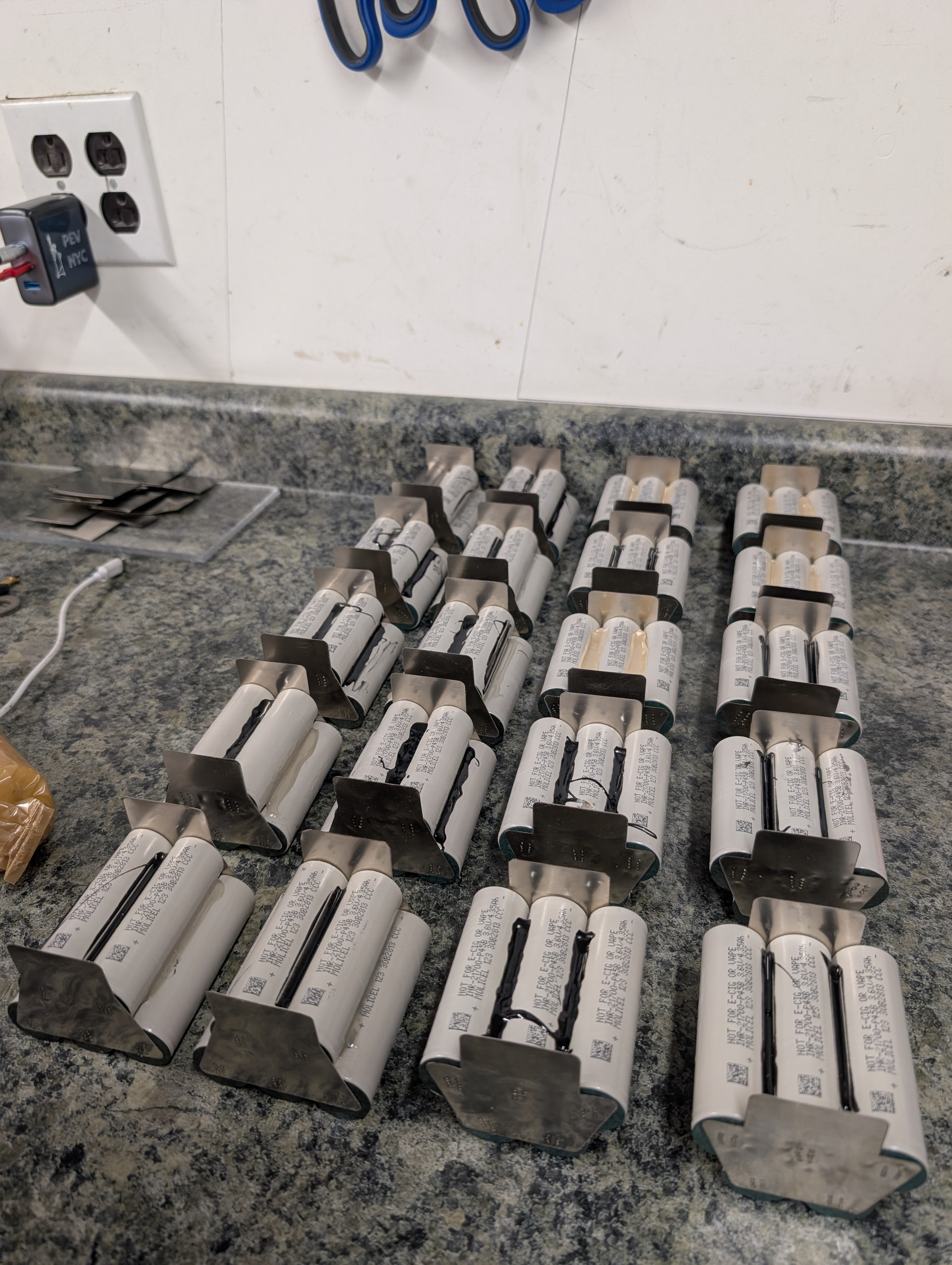

Got the process down for 4x parts at a time.

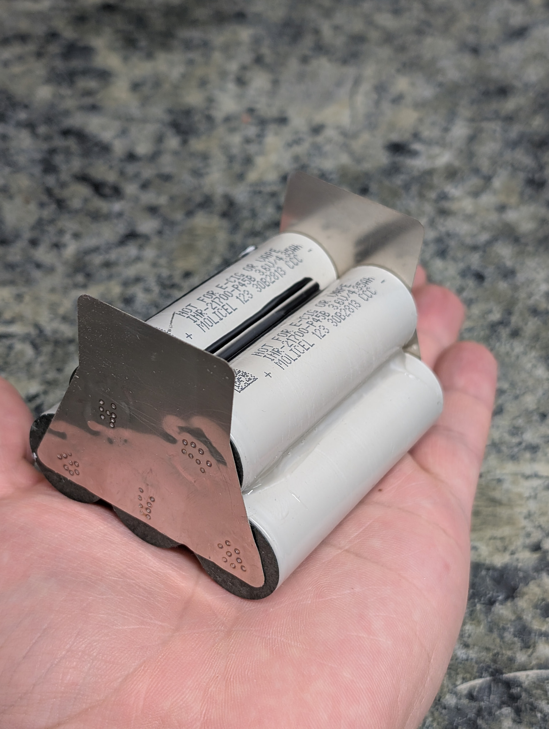

Ding welds are done
