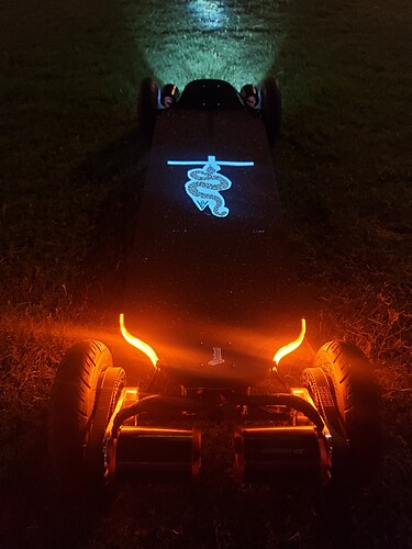

here the set up:
fluxmotion deck & enclosure
2*63100 140kv motor from ant innovation
@spintend vesc
16s6p molicel p42
matrix 2 oil slick
rockstar hubs
inbuild headlights & taillights

also did a light panel, which can controlled by spintend vesc (connected 12v extend port )

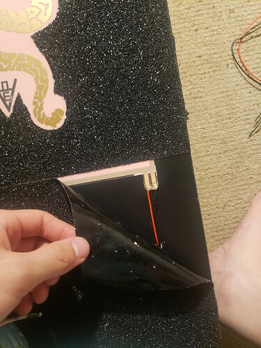

Couldn’t find pictures for light panel, but basically it just a light panel under the griptape, with cutted patterns.
here is how to operate the pattern lights
How did you put the griptape on and have it be flat?
that light panel are really thin, stick the light panel first, then cover the rest by using griptape.
Do you have a link to the light panel? And what did you make the graphic out of? So you don’t even notice any slight bumps? I am planning an iron man theme and I was going to go with a custom griptape and have the arc reactor in the middle but I guess I’ll cut out the arc reactor griptape and it would be so cool if I could put this led under it!
