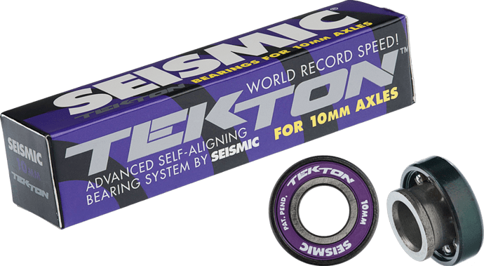

10mm bearings on street wheels not lasting
Looks like Seismic Skate has a steel bearing version with built in spacers that is much more reasonably priced, $40 for a set of 8 is not terrible.
The bearing spacing in urethane wheels is a standard at 0.400", or 10.16mm nominal. 10mm spacers will be sliightly too short. That 0.16 makes a difference, itā€™s the difference between preloading the bearings and not. I made a batch of 10.2mm spacers if needed.
6900-2RS bearings will inherently not last as long as 608-2RS because theyā€™re smaller bearings and have a smaller load rating. Only way to mitigate this is to source quality brands and to really avoid preloading them when you tighten your axle nut.

I forgot about the seismic options. They have been around for some time but I have never once actually seen the 10mm built-ins in stock anywhere. The website does have a spring 2023 availability date tho. I donā€™t trust ceramics as I think they are over priced and not worth the safety risk but the steel version cost $40 still. A bit steep for my blood, especially since Iā€™d have to clean and grease out the box for better performance.
Another point against ceramics is the failure mode is way worse than steel. Ceramics can explode and bind where as steel just gets crunchy.
Take this advice, i had a bunch of 10.16mm spacers cut for me because i kept killing bearings and the problem evaporated, i had gotten some 10mm spacers from Amazon (bike axle parts i think) and the little bit of side load from being too short was making them blow out quick. Good luck

Boardnamics, doh, this will make a huge difference. I couldnā€™t find a good source of what the spacer should be and wrongly assumed a spacer sold for skateboards by a skateboard website would be correct. Do you have any spacers you could sell?
If not I guess I could use a 1.5mm and 0.1mm shim off McMaster to add to my incorrect 10mm long shim.
