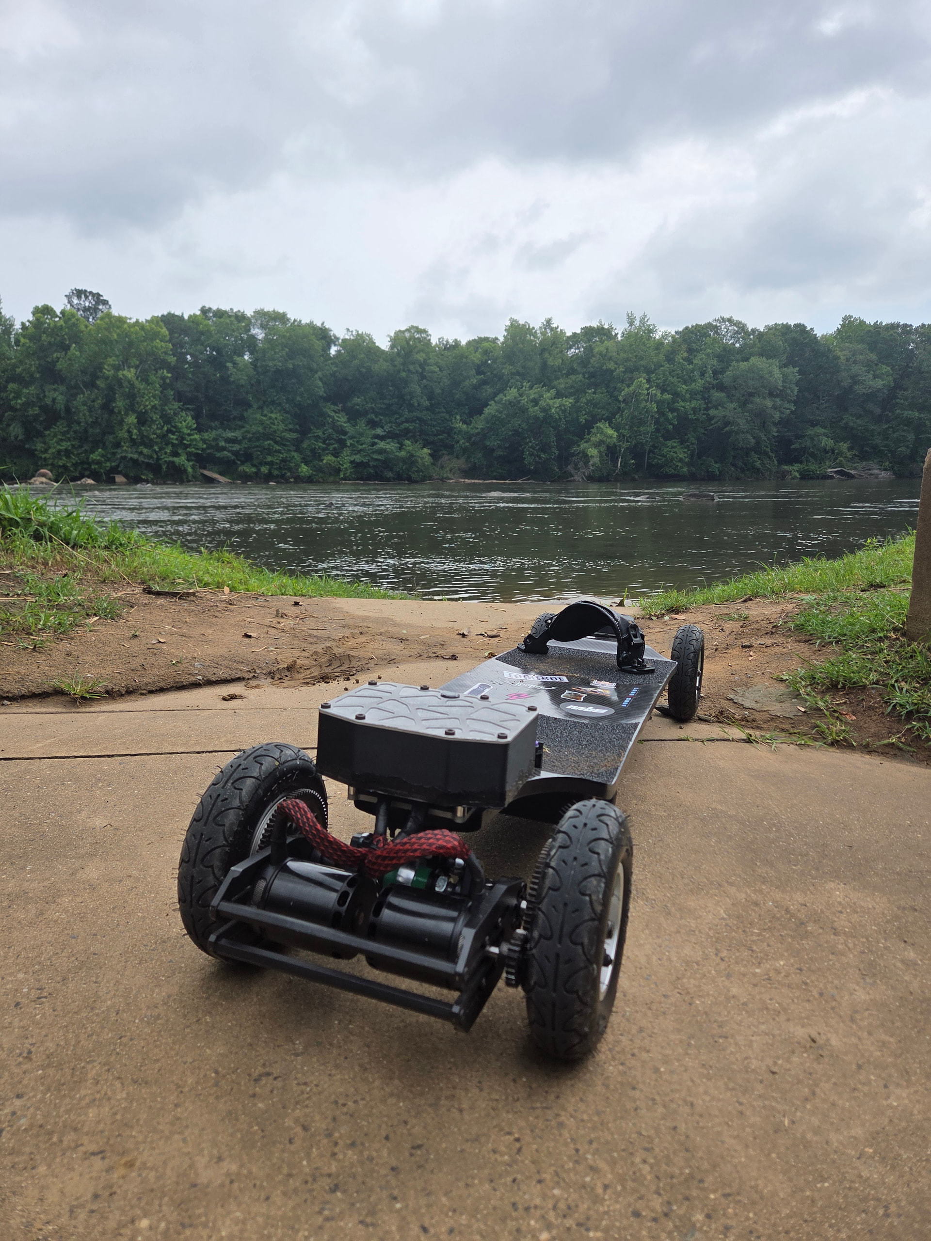

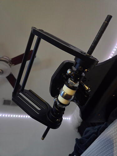

Building my first diy board, better to go big or go home right?

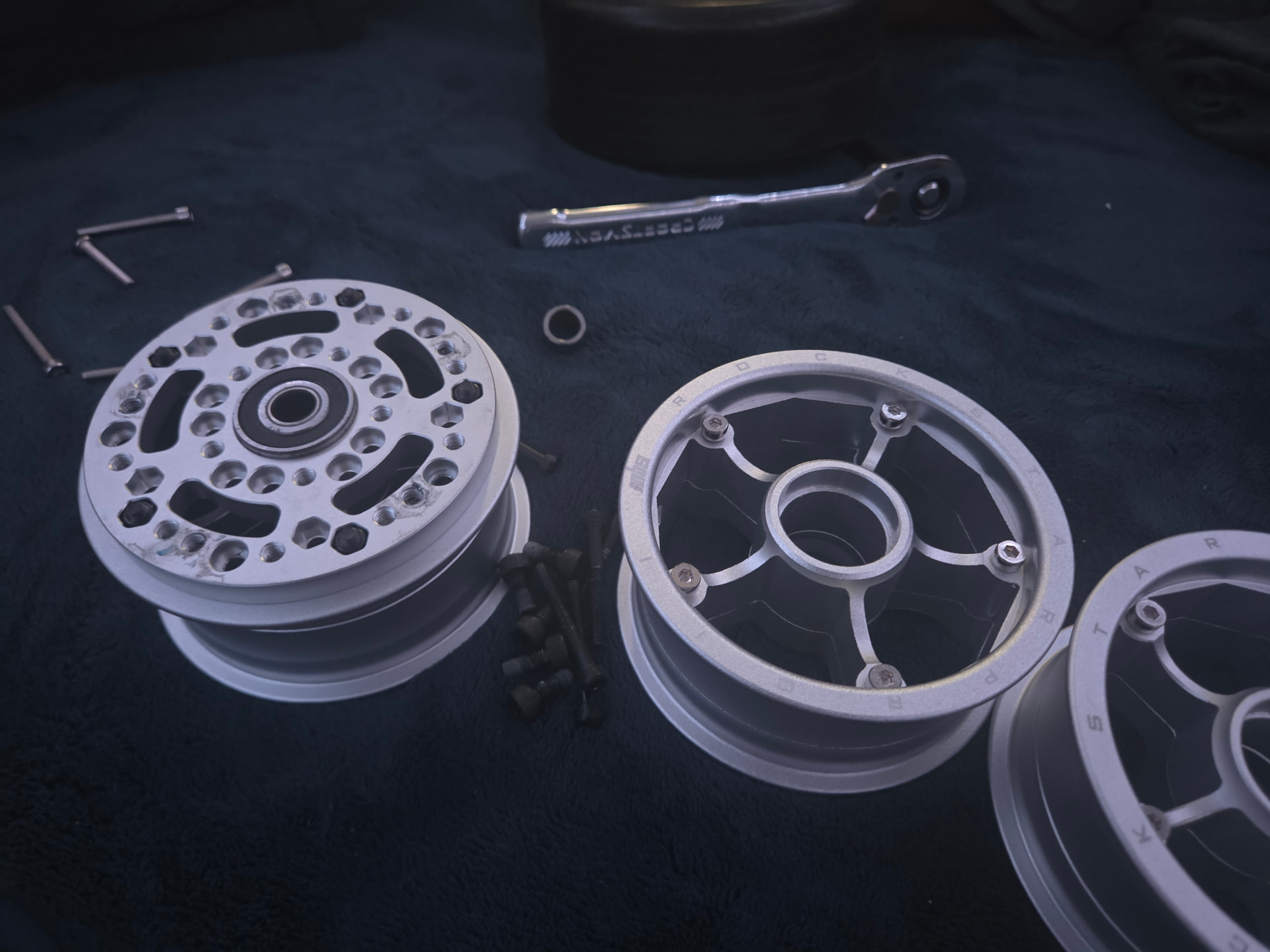

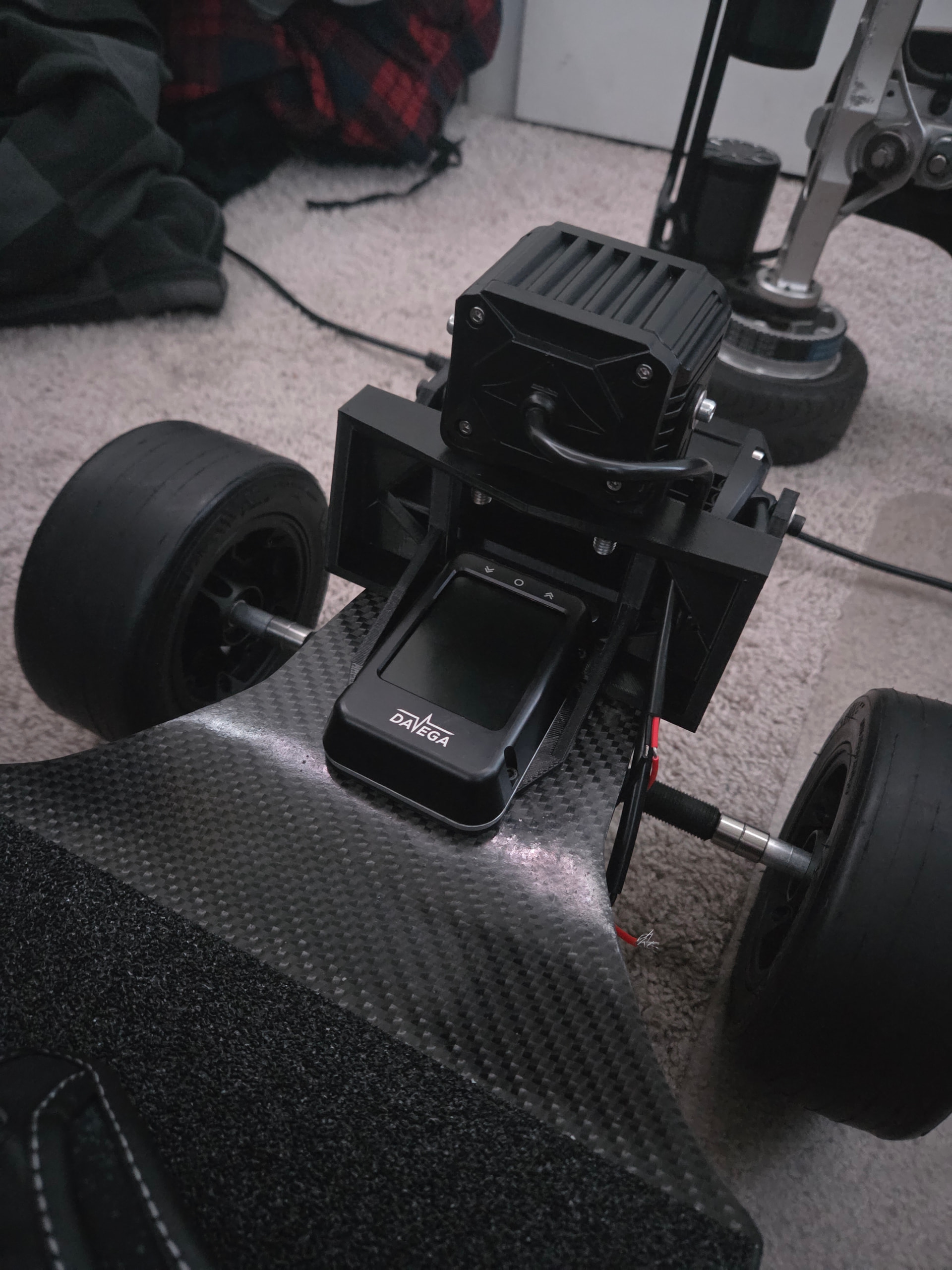

Parts list thus far:

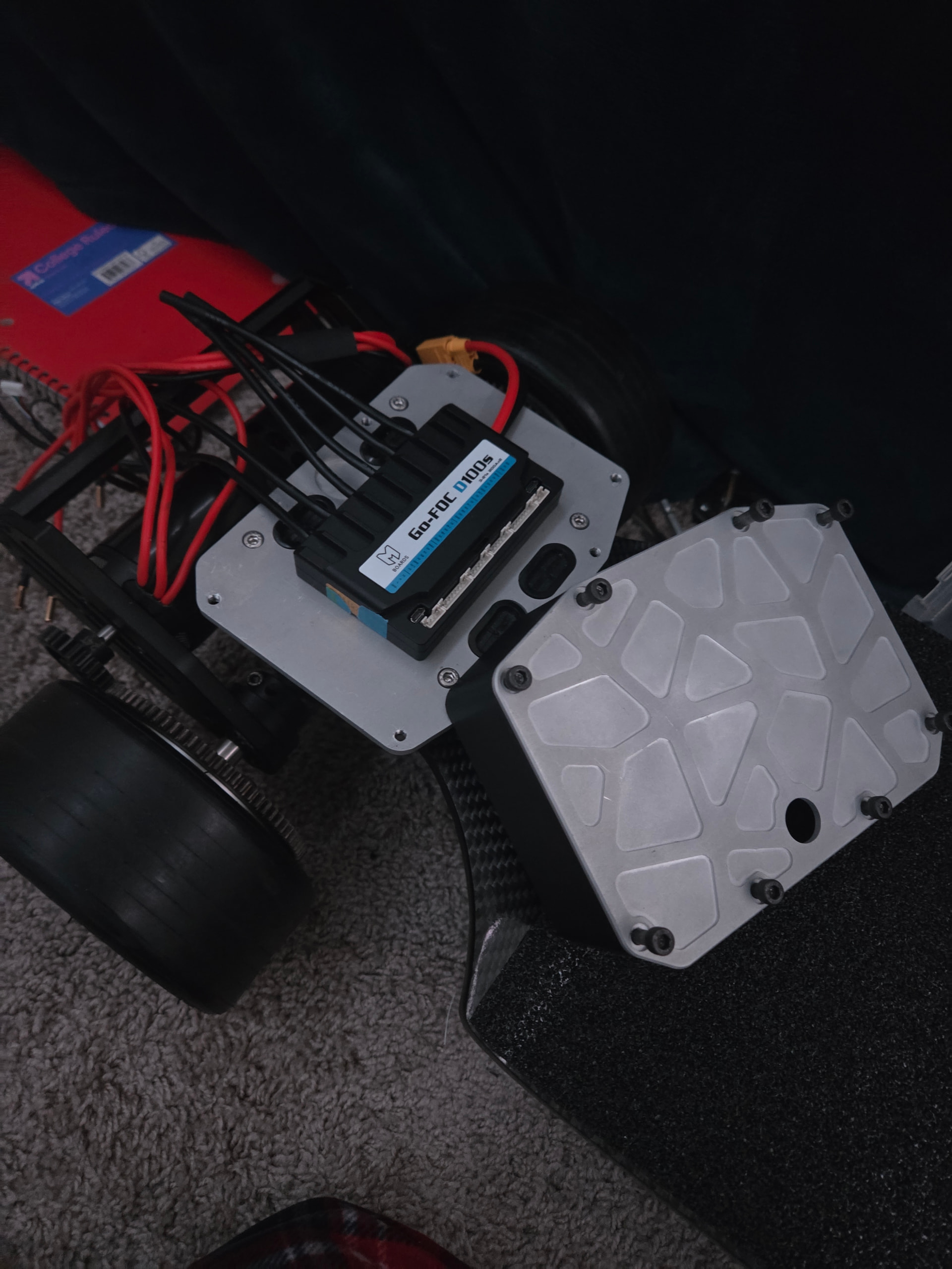

Go Foc D100s
Odachi v2 (with double stack enclosure)
MBS rockstar pro II aluminum hubs
200x50 kenda k909
Exposed gear drive (SRB’s 78t wheel gear and 24t motor gear that I DO PLAN to swap as I changed wheels last minute), mounted with linnpower’s adapter plates
Mad’s 3 link trucks
Efreedom esc enclosure
Hoyt puck 2.0
2x radium 6485s 138kv

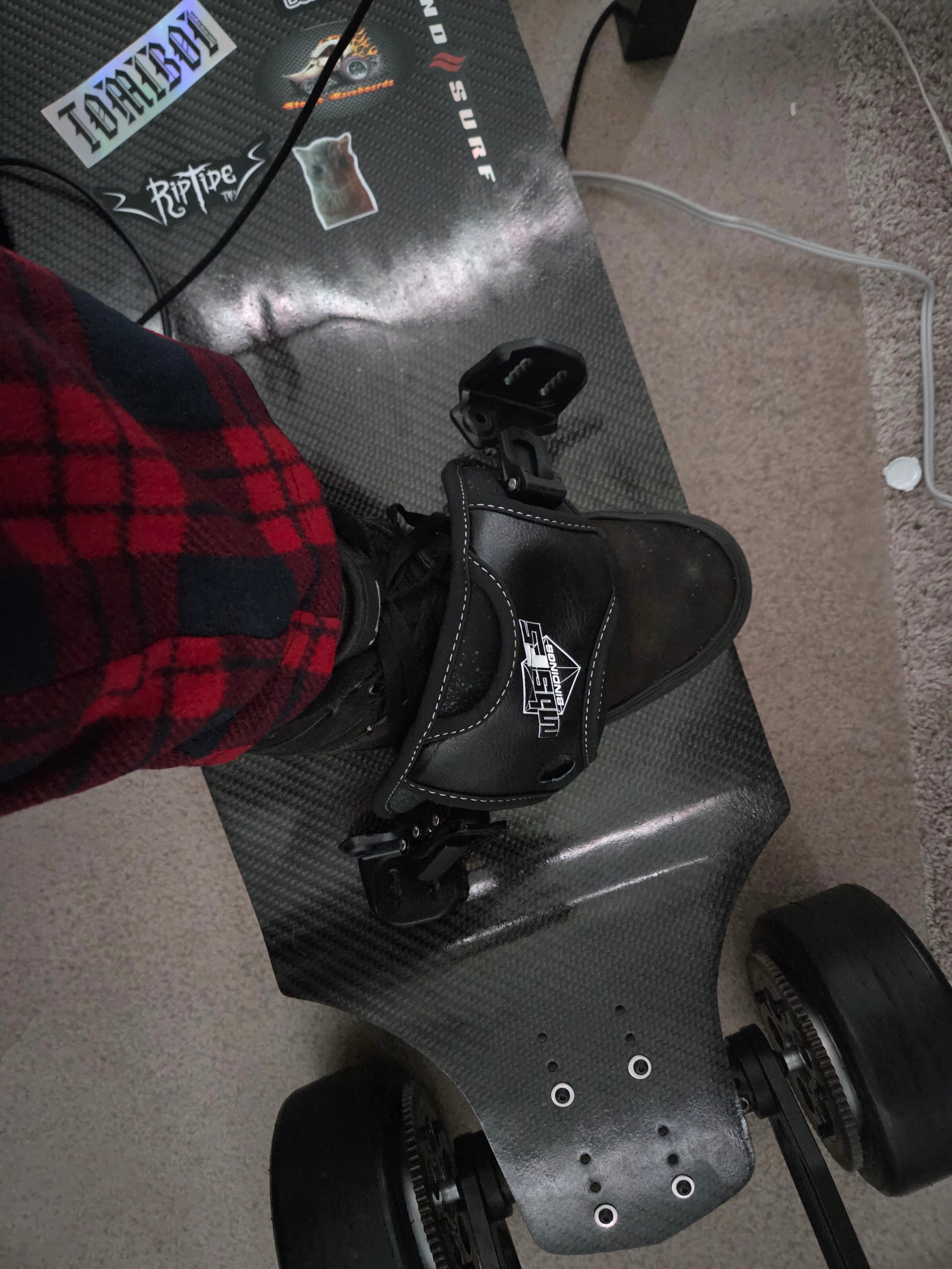

MBS F5 binding on the front
Linnpower’s footstop+3d printed surface extension
Vicious grip

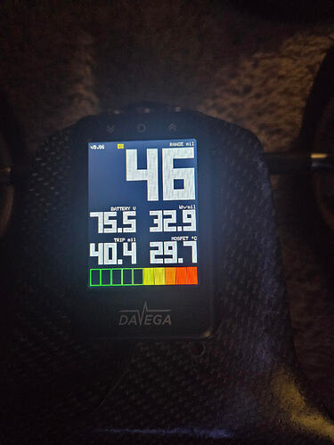

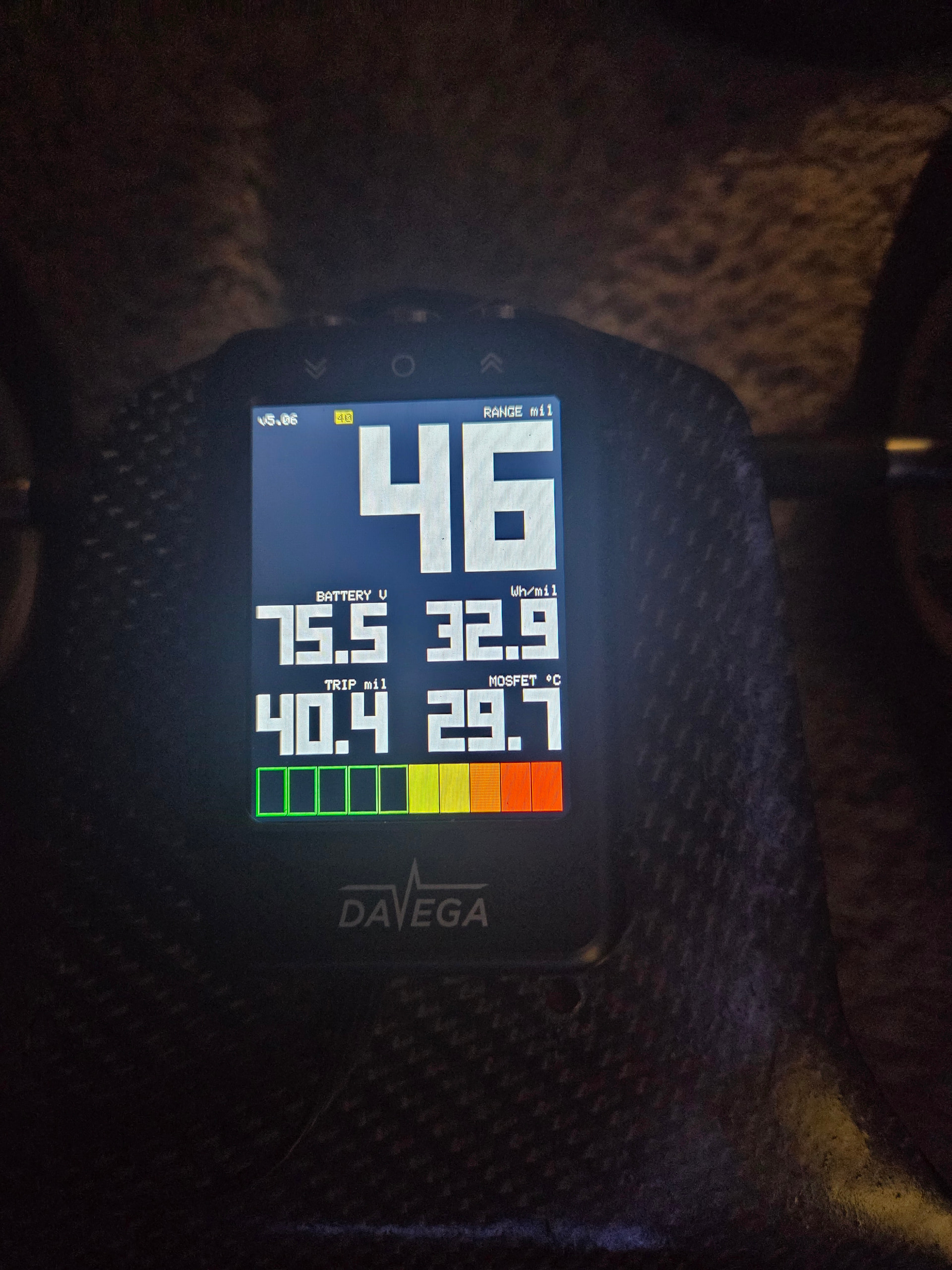

Davega X telemetry display

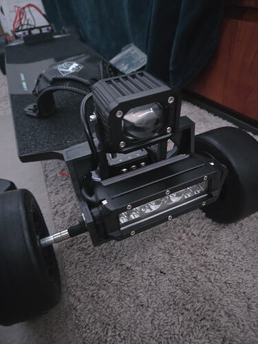

A 12v line powering a floodlight+spotlight on the front, and red LED strips in the rear

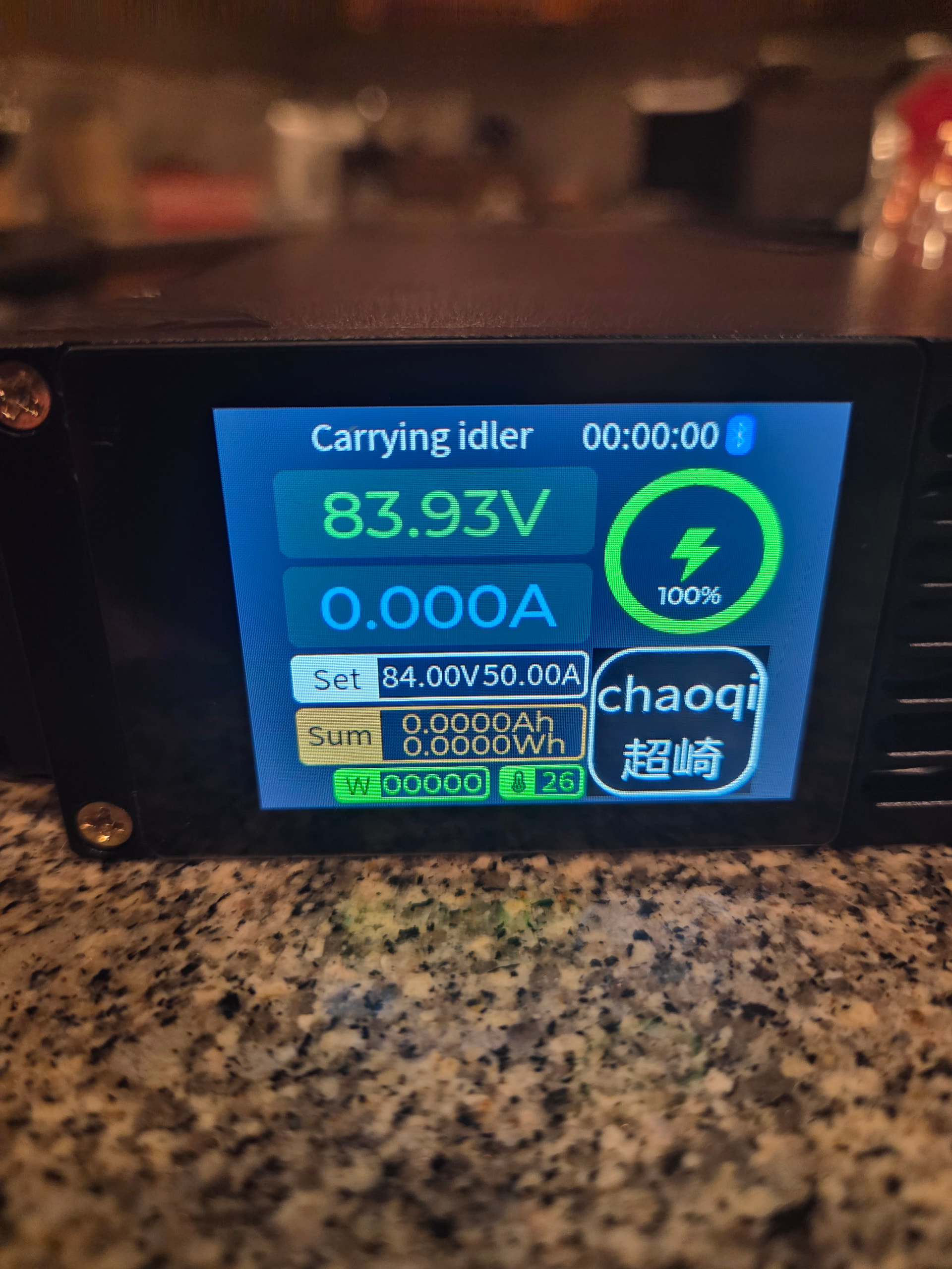

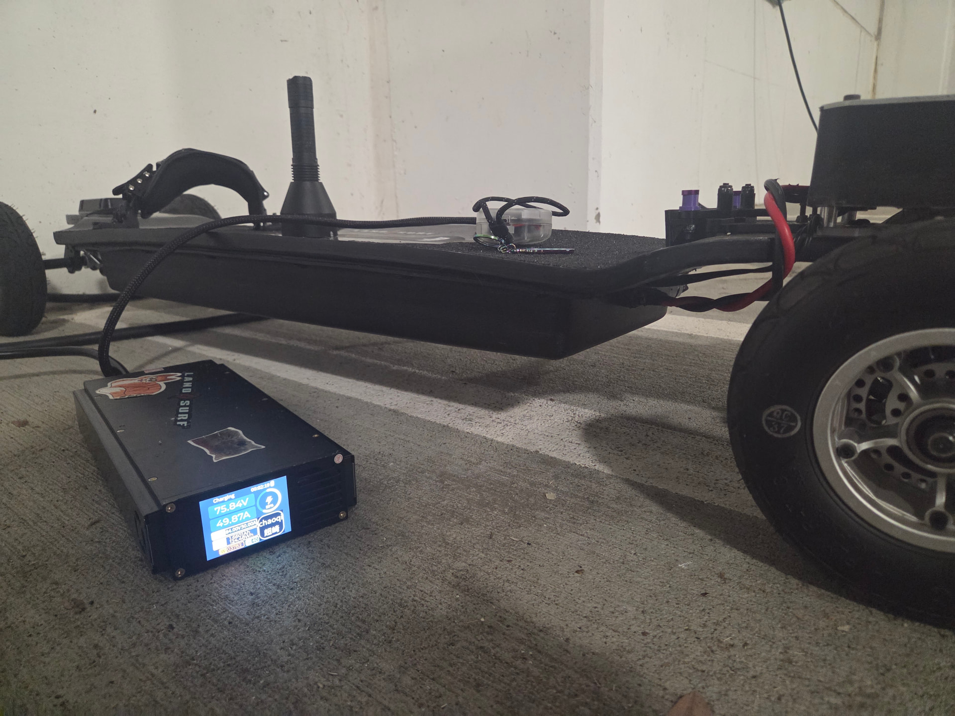

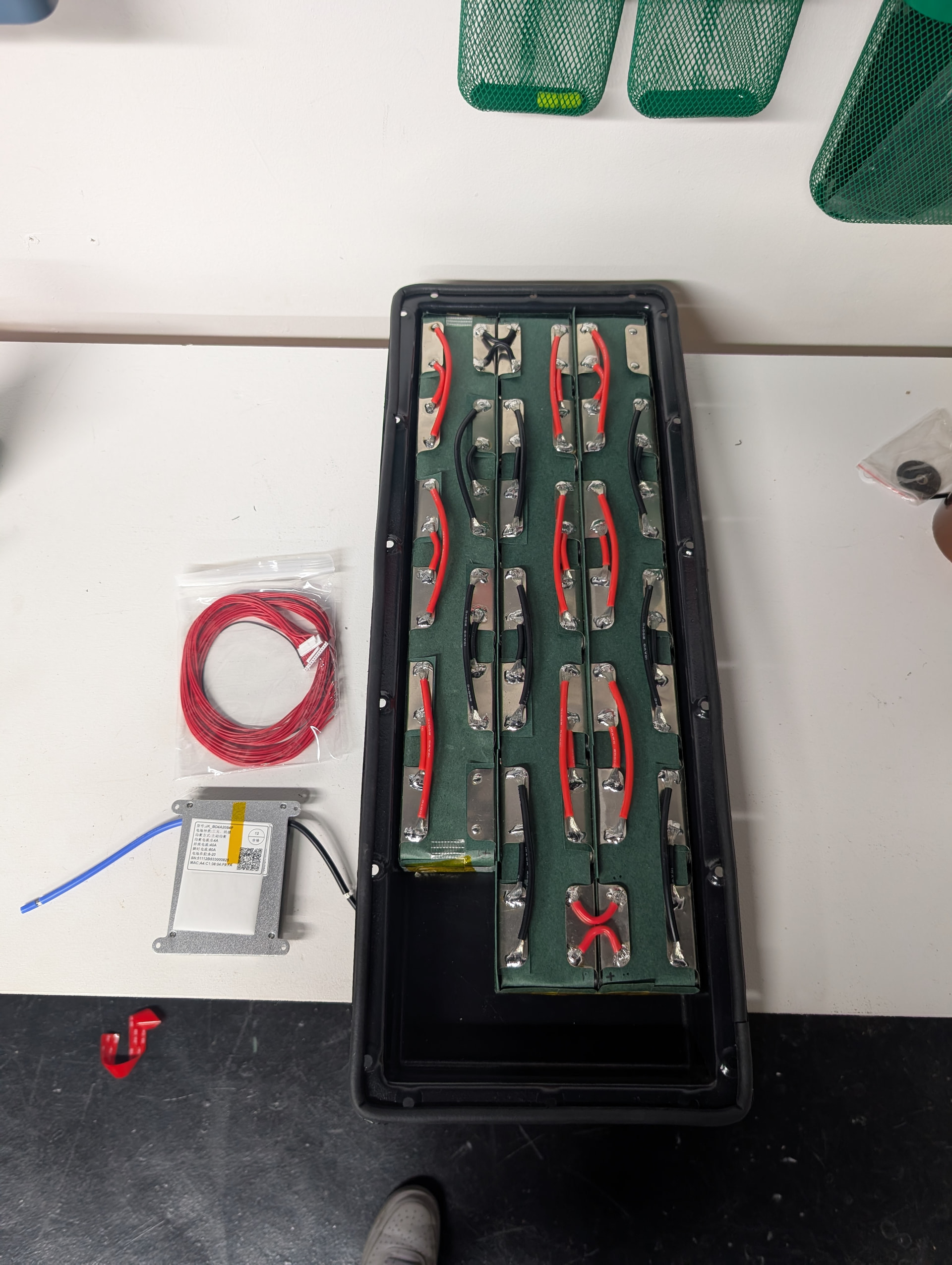

A monstrous 20s8p eve50pl battery being made by @jack.luis as well as a ridiculous 50a charger
…and gallons of loctite
I’ve been working on it since the beginning of 2026, and I hope this’ll be an upgrade from my current nomad n1 I’ve been rocking for almost a year now :wink:

Ooop. I’m shipping your pack out today or tomorrow. Really hoping for today :crossed_fingers:

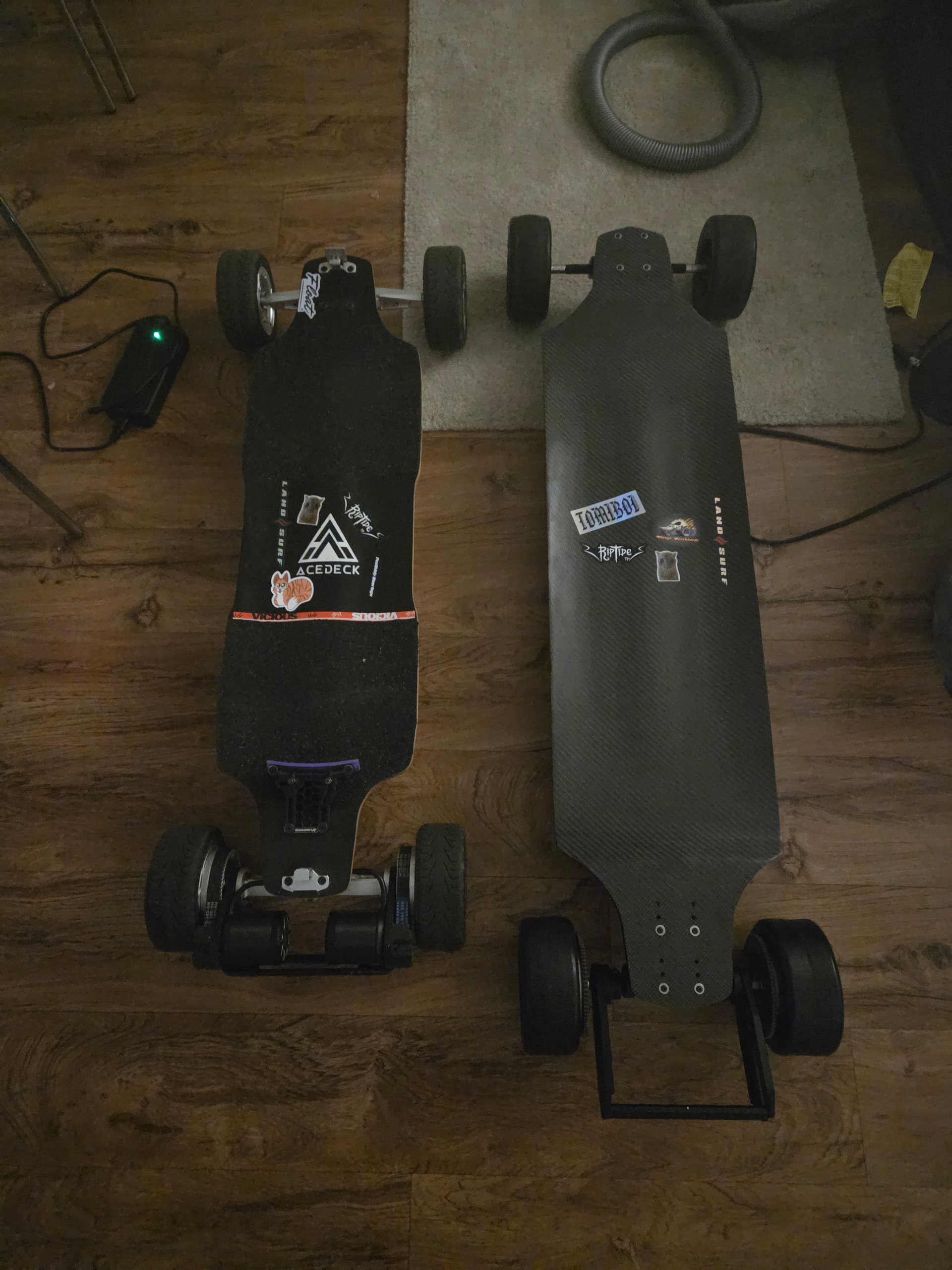

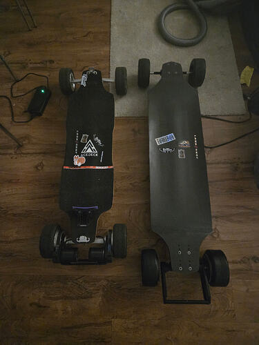

Lil bonus content for ya
Definitely got some practice hours ahead of me, switching from dkp to 3 link is a massive difference. I can’t even bring myself to use mode 3 on my remote yet, and even mode 1 is a rocket ship from standstill. Also incredible range, not only from the massive battery but the gear drive has almost no drivetrain losses and will roll down all but the flattest ground.
