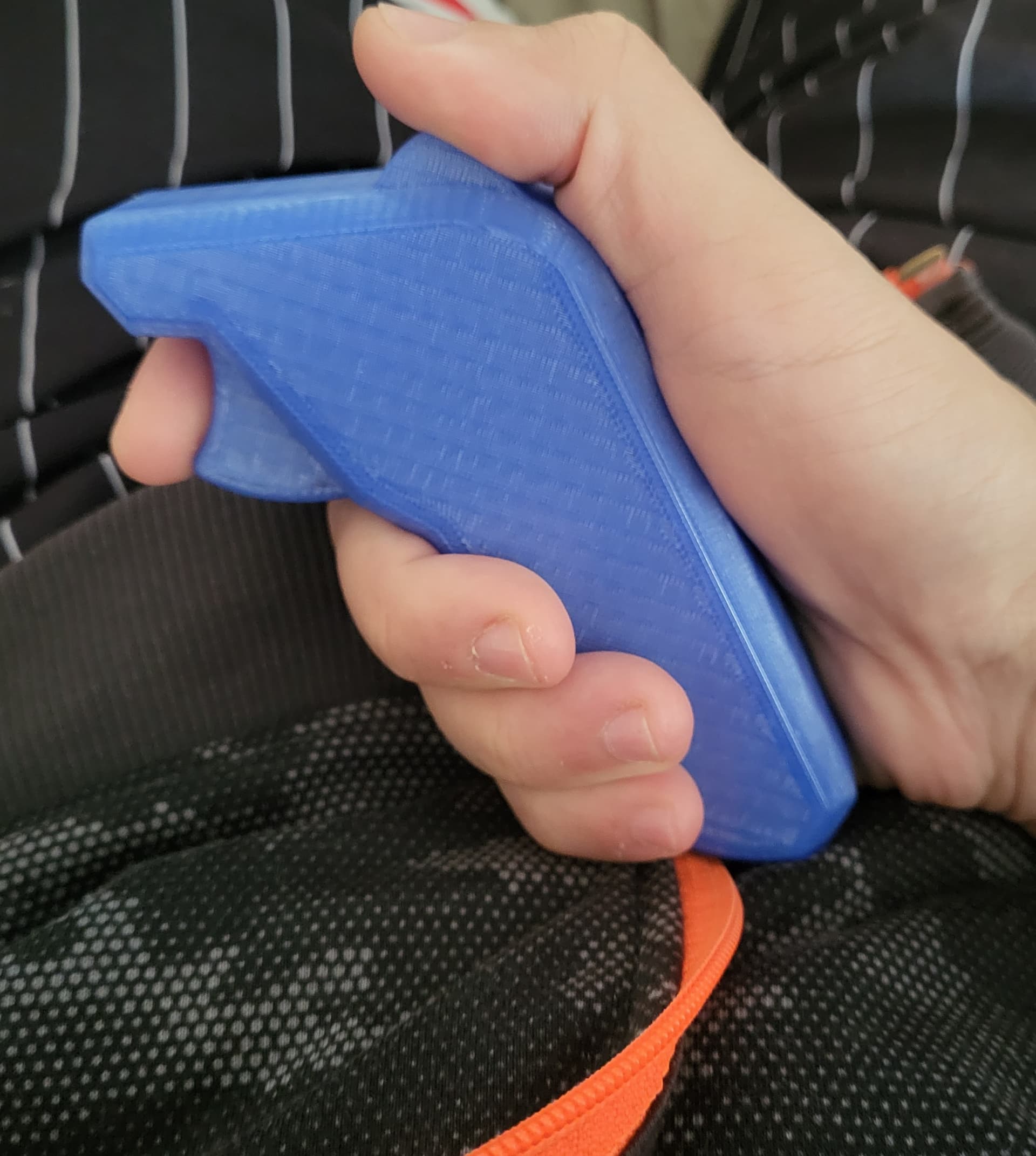

This is just a quick sketch but I think this is more or less the maytech shape. The actual shape will be slightly different after a proper sketch but triggers and grip should be the same.
Then I recreated the Evolve R2 shape to be more 3d printer friendly and It feels good in hand as well.
When I get the maytech remote I will be able to compare them and go from there.

If I could add to this, don’t try to implement any ā€œrampingā€ or transitions in the remote code, just send the realtime signal. The ESC can ramp or do whatever it wants in its own code. If it needs to go from full throttle to braking in one tick, then that’s fine.
Depends what mode you’re in, but in some control modes you will be going backwards. Others will keep the brakes on but you can move a little but. Other modes will slowly start reversing. But either way the remote continues to send a full brake command the whole time.
Yup that’s gonna be my core approach but still need some tiny dead band for the braking. Applying random brakes caused by sensor noise wouldn’t be nice :smiley: I need to inspect the internals of maytech and may be I can go with pots instead.
IMHGO deadband is better handled on the other end. It’s annoying to me when it’s done in the remote firmware and isn’t adjustable.
The remote’s primary job is to transmit the user’s control input. Interpreting it, IMHO should be done on the other end. And not having two things fighting over cleaning up the signals, resulting in mushy response.
:smiley: ok but there’s this slight detail in split trigger version. Unlike all other remotes, this one has not one but 2 analogue readings. Meaning that you have to decide which one is actively being sent to the vesc at any given time. In order to decide on that in the code you have to give a tiny slack for the braking or it will prematurely intercept the go command and take over which is a huge problem. Yesterday I made some tests with oh49e hall sensors and its jumping around like crazy. It can yield better results with 5+samples but still it will jump around tiny bit after the calibrating the zero point(resting position).
