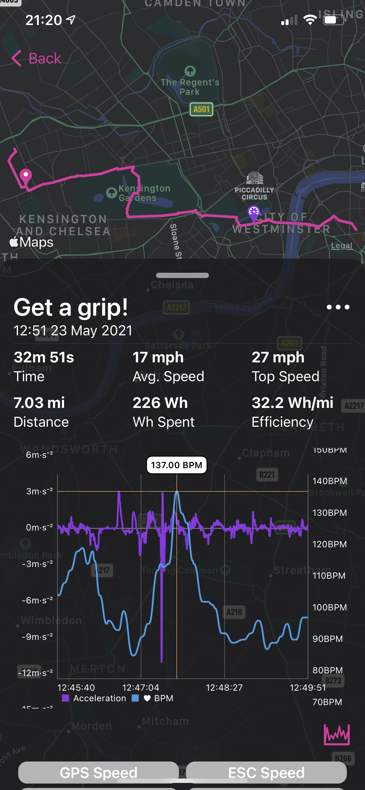

Yours Truly (VESC/UNITY ride tracker) is now available for free on the App Store!
App store, version 1.3.3 build 3
When I don’t allow location permission for the app it doesn’t happen, then all text is readable
I think this is fixed in the beta.
Will release in the next few days if I don’t get any serious bug reports.
Can you spot when I aquaplaned? :sob::sob:
