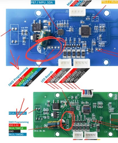

Will upload the firmware to my gh and post the link asap. I’ve seem to have hit a bit of a bump with proceeding with the FOC firmware. I wanted to flash the sideboard first, had a spare one so tried it (had an stm32f103 on it), unfortunatly i could not erase the chip, JFlash lite would not allow it. I suspected voltage issues, rewired some stuff, and ended up accidentally touching the 12v to the 3.3v line, and fried the sideboard… Then took a spare hoverboard, that one had the GD32 IC on the sideboards. Unfortunately same issue, unable to erase the chip.
Would you happen to know a solution to this issue? I’m using a jlink edu, and my sideboard is blue, with a green radio ic on a separate pcb that is mounted on the sideboard using headers. Silkscreen says: 2015.11.30 Ver 3.0

@Zuen How to Unlock MCU Flash · EFeru/hoverboard-firmware-hack-FOC Wiki · GitHub

I tried the ST-LINK route, it allows me to disable the readout protection → however only when using connect under reset mode. Then I was able to clear the memory. But now the st-link utility does not allow me to flash the chip, it just throws a: programming error @: 0x080000000. So I guess i’m going to have to rig up and arduino + MPU6050 this evening.
Kind regards
@Zuen Is the wiring sequence correct? =)
On the side boards there is a different sequence for connecting wires

My sideboard looks newer, can’t post pictures, but its the sideboard that also has the bluetooth audio amplifier on it (which i desoldered). They come from a spare hoverboard that has a single ESC, and two sideboards. I’ve figured out the wiring, st-link can read everyting on the chip, and erase it. But for some reason it failes when flashing → I did the unlocking.
Jlink complains about not beeing able to download RAMCode
ST-Link complains without an error, just failed to flash
The funny thing-> I am able to individually set bits in the flash memory, write them, and they persist over a power cycle. So flash memory is ok, programmer is ok, wiring is ok… There’s just something in this processor that disallows dumping the .bin file on it via st-link.
@Zuen I also had the same problems with firmware … out of 3 boards, only 1 flashed (and still didn’t work, something was wrong with them), so I think it’s the right choice to make a custom side board.
