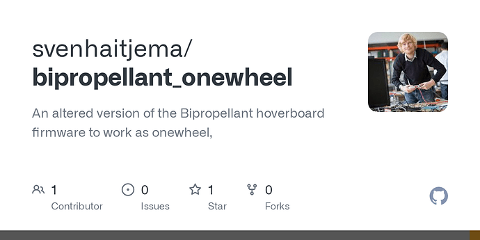

@Vfear here’s the github of the bipropellant firmware, updated to work as a onewheel, the pushback needs to be changed to be fully safe, it oscillates now.
github → svenhaitjema/bipropellant_onewheel

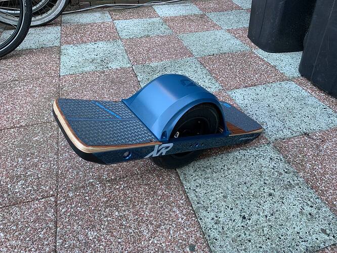

Since my forum status is upgraded i can now finally post a picture of my onewheel :slight_smile:
@Zuen Cool

Yes there are a couple of repositories that could work for you depending on what your hardware setup is. If you have an original sideboard and the non split hoverboard motherboard (so 2 esc on 1 pcb) you could try the changes i made to the bipropellant repo, you can find them here:

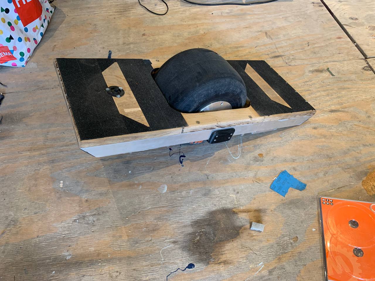

Nice, Yes I have my hoverboard parts ready and now I am trying to somehow cope with the overwhelming capacity of information. I don’t know where to start… I see that you posted your repo, Thank you for that, now I have to understand how to flash the mainboard. I can’t post the photo of my onewheel here directly, but here it is Album — Postimages
Hi @rimvis91, nice build! I’ll update the readme of the repo. Do you have an st-linkv2 or Jlink programmer?
If so, a good start is installing vscode + platformIO plugin, then clone the repo and open in platformio.
Then depending on the sideboard you have, you might need to update the baudrate and packet length in config.h. Then build hoverboard_6word and use either platformIO or stm32 st-link utility to flash the firmware.bin file. I can also post mine, but depending on how everything is wired up this might not work.

I wish I could help with the coding but Unfortunately, I know Zero about coding. I think I am going to have to wait for detailed instructions. I have a one-wheel hoverboard now and it is running I traded someone for this board so I did not construct it. here is a video going over my board About My HoverWheel - YouTube Idk if you can tell what I need based on my like do I have to get an ST link and a J link? Even though I am unable to help with code I can make things I have a CNC, Co2 laser and a good size filament printer. I would love to make this board operate more like a one-wheel then I will design a plywood case for it like this https://www.youtube.
com/watch?v=691zY2msFBs. If someone wants to hold my hand through this I will make them footpads or something like custom plugs for the power ports.

With the FOC firmware, the motor(s) make exactly the same sound as a onewheel XR, it’s very noticable when changing driving direction, I can’t really describe the sound other than small current clicks that go through the motor. But i’m confident that this is the control mode used in the XR. I will need to experiment with the field weakening, to see if the motor can be sped up while maintaining balance capabilities.

Thank you I now completely understand. I can not wait until the FOC code is available but until then I will be going with just the motherboard which sounds like a big improvement. Do you notice more range after flashing the motherboard? Also, I was serious about making parts if there is a need/want
Thank you for the parts offer :wink: I would like to know how those nice footpads are made, mine are way less nice :stuck_out_tongue:
