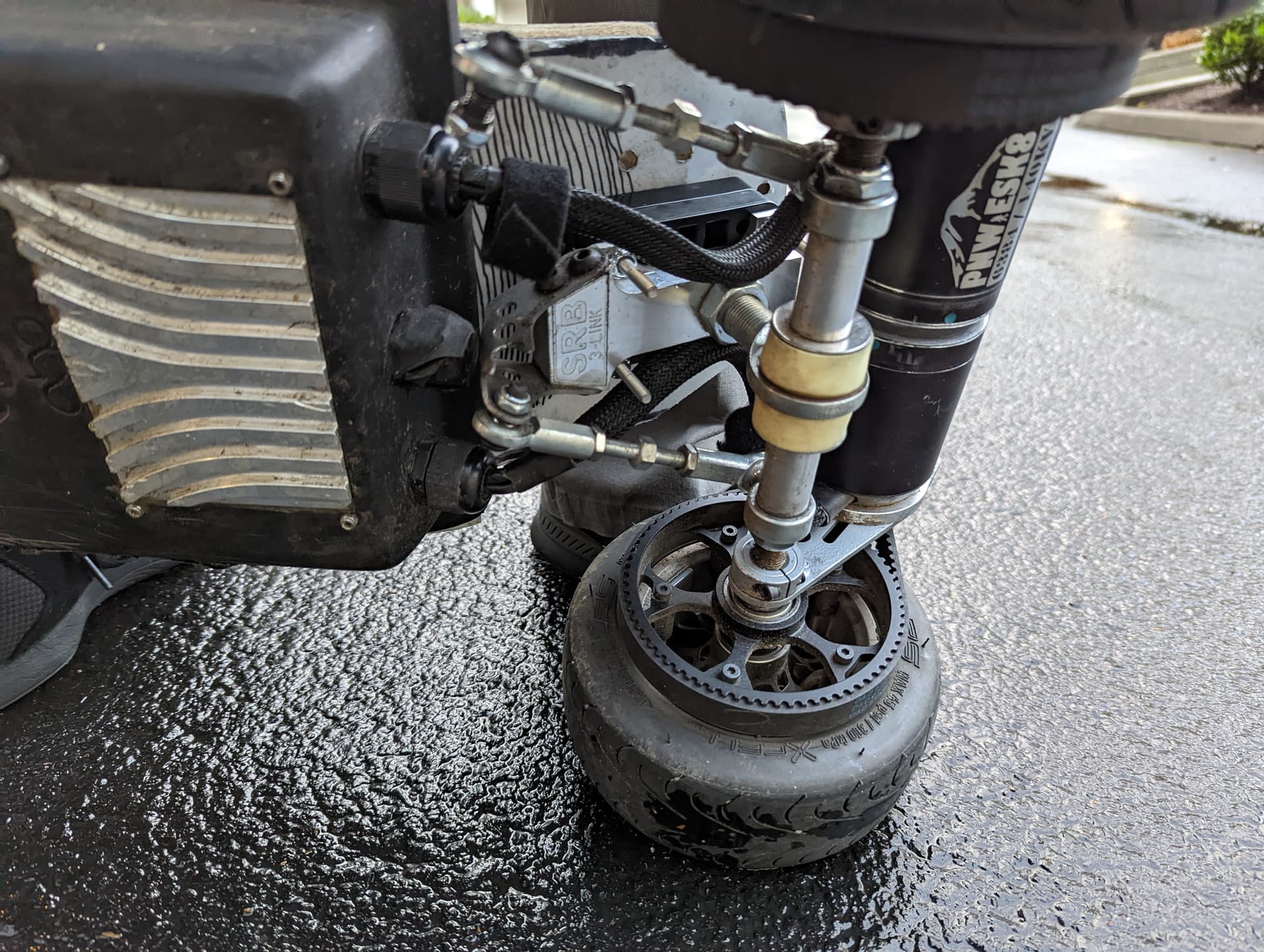

Here’s the time I broke a control link on my 3links at about 35-40mph on a trail during SNR and ate shit… Really fucked up the Board on this one, crushed my OSRR also!
This left me fucking pissed and feel fine with 3links… Maybe one day I’ll revisit HD 3links. Don’t worry I have more 3link carnage as I move through my pix :slightly_smiling_face:
I refurbished those motors as part of my 100d+ / reacher experimenting. :smiling_face_with_three_hearts:

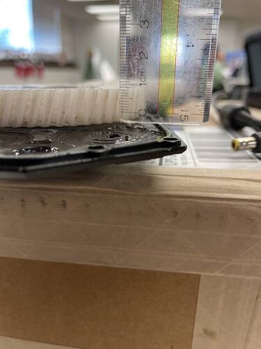

Maybe not completely broken… Buts shit is stretched the fuck out!! Beyond usable. In pix, old vs new, same number of links
