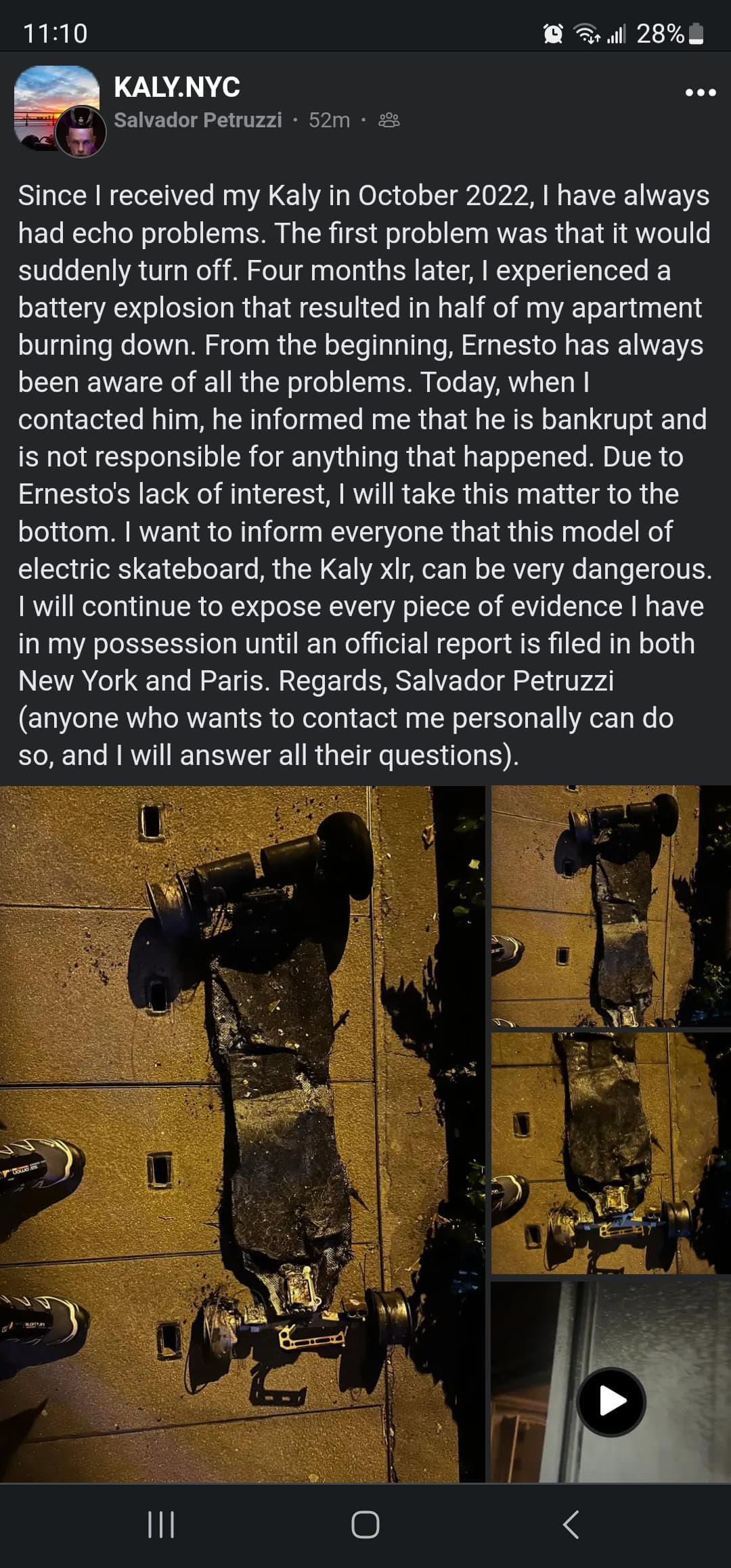

Kaly saga continues.

Most or your drain is caused by the buck converter for the stabilizer. Remove that or get something that cut the power to it when not in use and most of the drain will be solved. The ubox drain is very minimal, specially for this big battery.
You should replace the battery.
Really late to the party but… oh man… XLR’s switch doesn’t cut the power to the stabilzer?.. thats messed up…
These packs have a bluetooth smart BMS no? Can you read the bms using XiaoXang or another bms app? What voltages do you see?
In all likelihood your battery is stone dead and most likely the battery pack is toast. Anyone with sense and knowledge surrounding these fire bombs is gonna tell you not to charge this pack and do not attempt to revive it.
