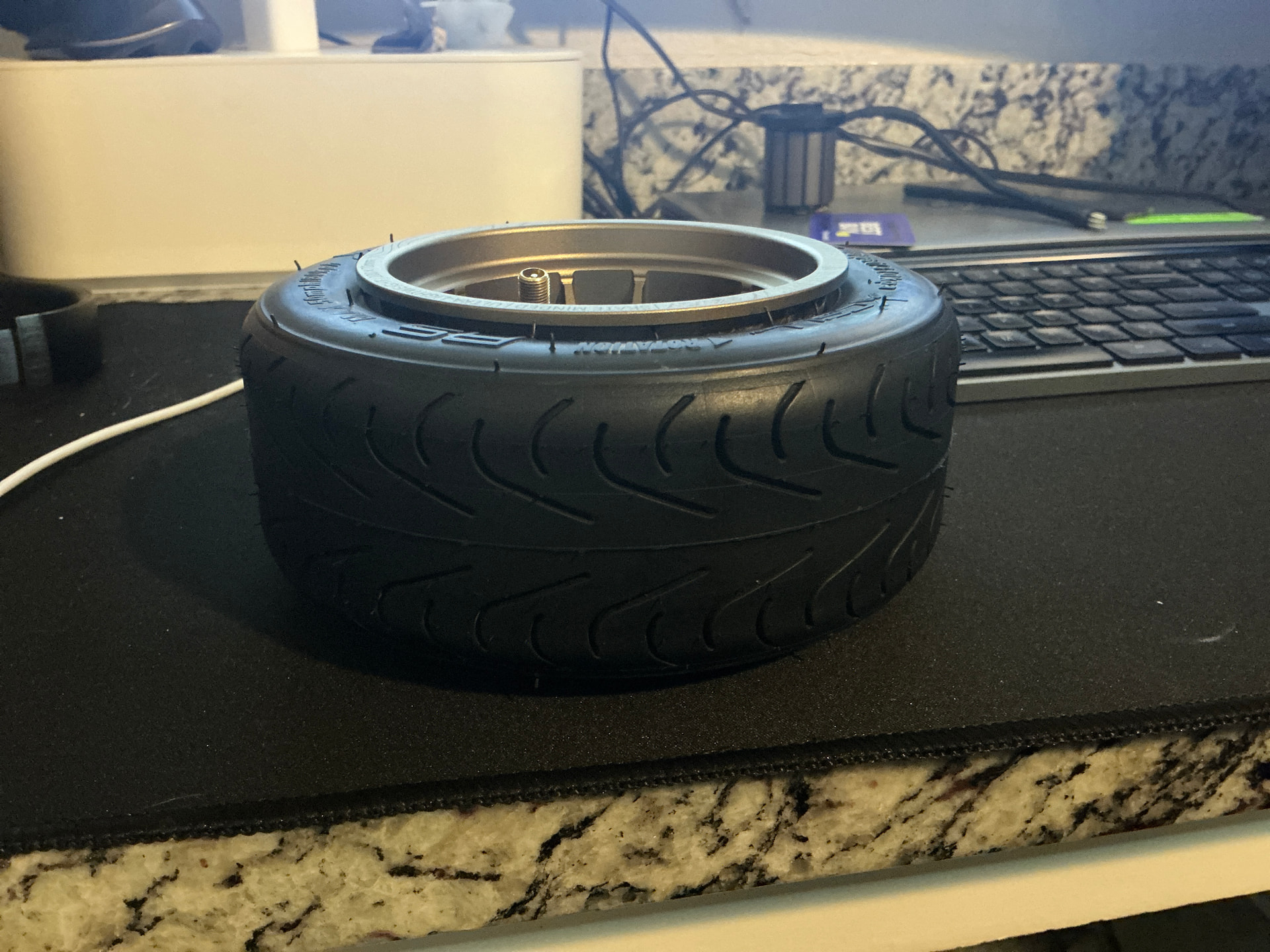

Maybe a weird question, I’m trying to install xcell on Exway’s new ACE Hubs below. The hubs are slightly wider than the tire. Hub is 70mm wide and the xcell tires are 62mm wide. Is there a way to stretch these or “bead” them ? Is that possible with tubed tires??
One of the issues I have noticed with the exway hubs is that the tire valve hole isn’t centered between the hub. It sits more towards the front of the rim so the tube sits at an angle when filled, causing it to wobble. I have brought this to exways attention and they just give me the generalized answer of incompatibility nonsense…
