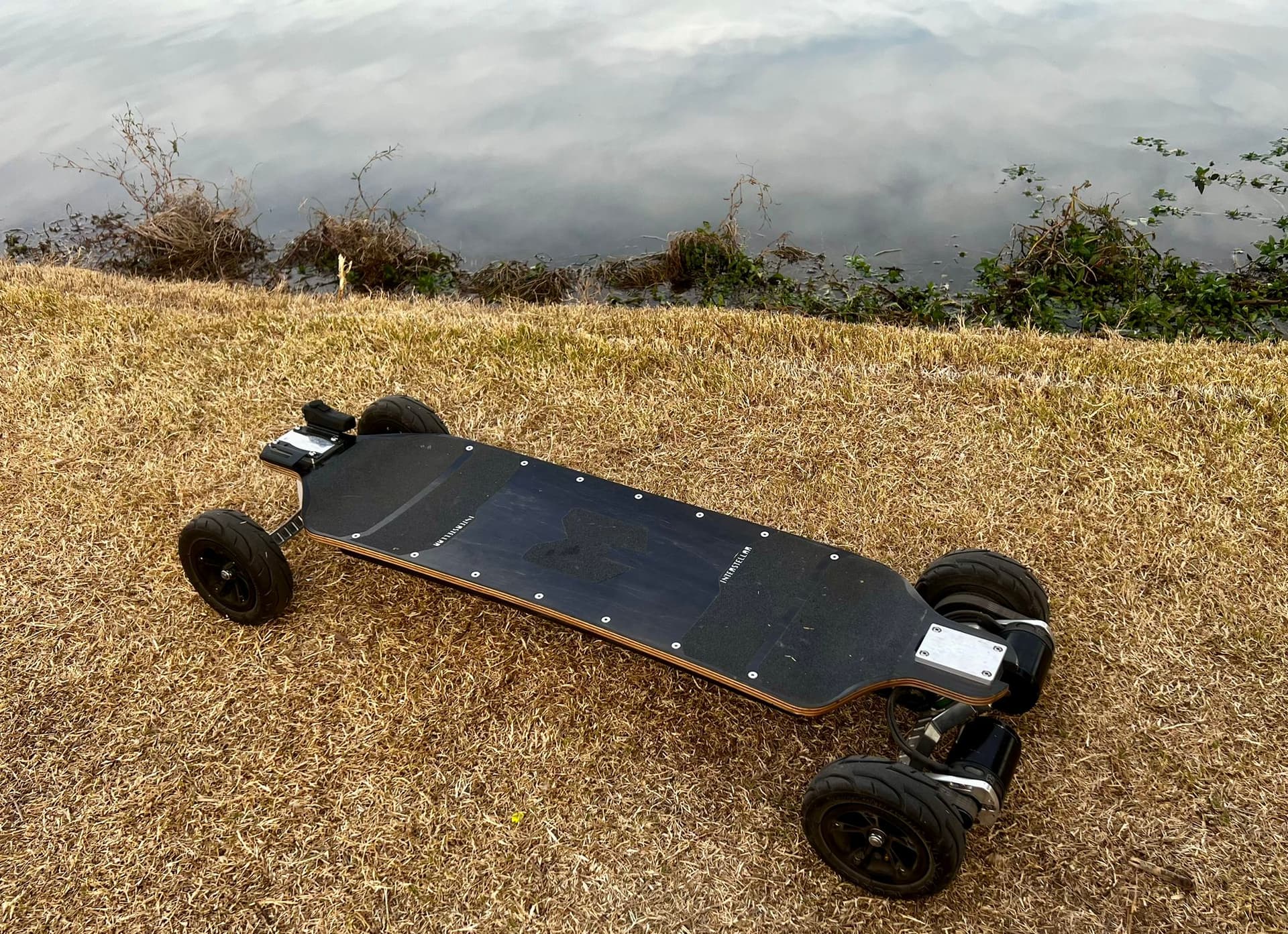

I’m selling my MBoards Interstellar 2.0+. It’s hands down the best board I’ve ever owned, but this hobby has led me to splurge on boards that are more than I actually need. My main use for a board is just commuting to and from campus, and this one is overkill for that. It’s unbelievably fast, but I only ride at about 20 mph on campus, so I think it’s time to let it go. I’ll switch back to my Backfire and use the extra money to help pay my tuition.
The board is mostly stock, except for the Shredlights I’ve added and the 90a cone bushings I swapped in instead of barrels since I’m a lighter rider. It comes with 2 SL-300+ front headlights and 2 Meepo taillights (currently not mounted). I’m also including a set of moderately used Mad Wheels V2 with 38T pulleys and belts.
Feel free to reach out if you have any questions!
Specs:
Motors: 6485 173kv Radium Motors
Battery: 846Wh 14s4p Molicel P42A
ESC: 200A x2 MakerX D100
Remote: Flipsky VX4
Trucks: 15-inch Nexus trucks
Deck: 39.5in x 10in | 7-ply Canadian Maple + Fiberglass
Currently, it’s geared for 43 mph but can be adjusted to go even faster. I typically get about 32 miles of range before the battery hits 10%.
Let me know if you’re interested or have any questions!
Price: $1600
Dropped to $1400
Dropped again to $1300
I need it sold by this week :ok_man:
Shipping from Phoenix AZ, would prefer meeting up in the valley.
Pictures:
