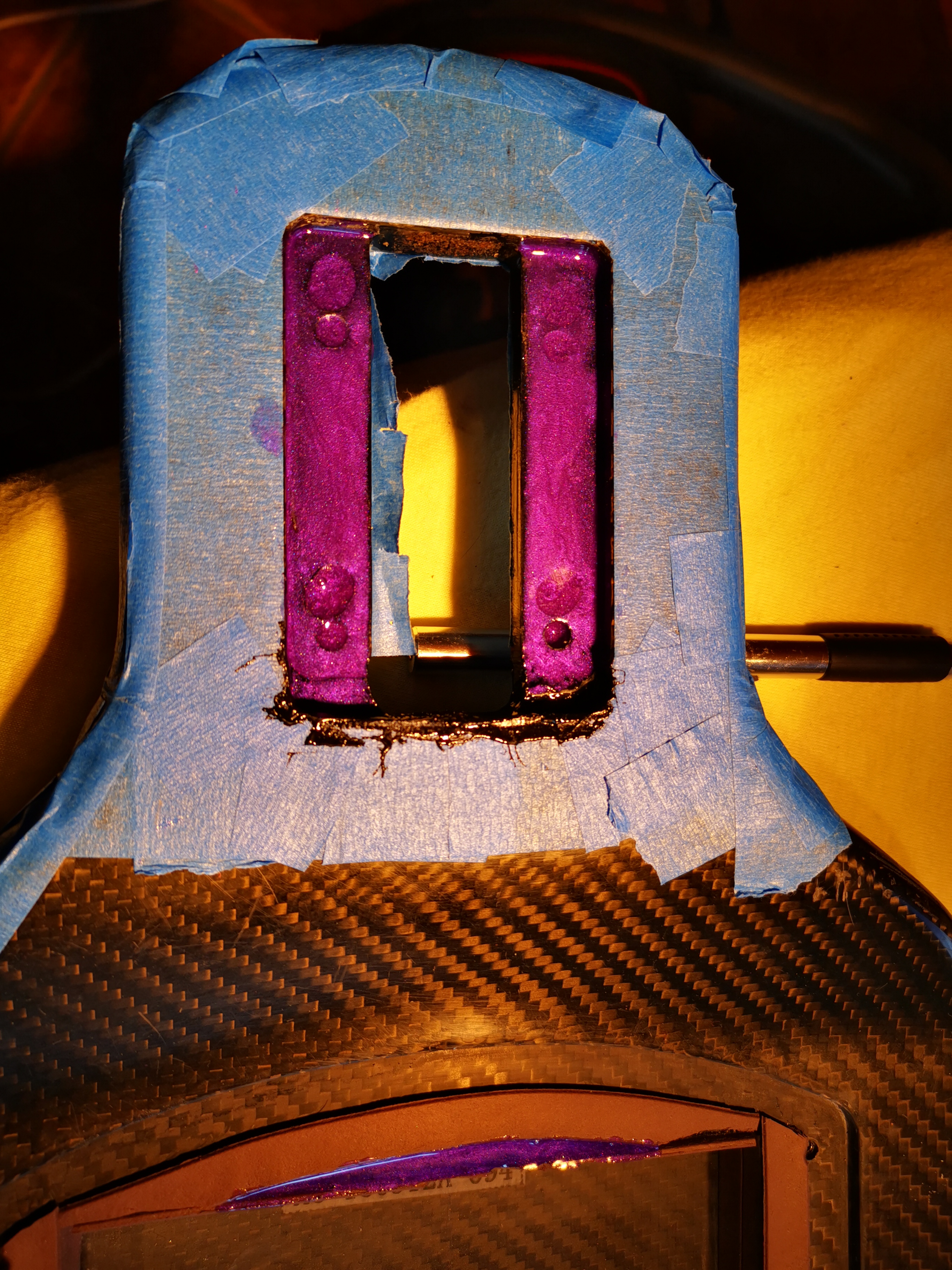

  • TB baseplates are not the same size as evolves so I had to route the board to accommodate this.
    This also exposed the foam core of the board so I used special glue for boat decks ( Sikaflex 290 DC)
    which is flexible, UV resistant, chemical resistant (including saltwater), waterproofing etc…
    Then used epoxy with some purple mica powder to make it aesthetically pleasing and to add reinforcement.

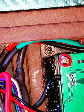

  • The wires coming in have also been sealed with A LOT of silicone
  • The ESC’s (i am selling 2 with the board, more of that below) and motors have been upgraded with MR60 connectors to allow higher current and less overheating.
    I have also seen many wires from the ESC have cuts from idk where but the silicon on them is really bad so I upgraded those as well from 18awg to 16awg (thicker wires).
    And because Brian has influenced me so much I conformal coated all the phase wire pads on the ESC lol. (the wires are very badly soldered from the factory and it my case i think that is what killed my esc because when i went to see the yellow phase wire was just floating around :neutral_face:)
    So nothing to fear here, I tanked this thing so much. I put months of work into this board.
    I want to add that I added silicon around the phase wires to avoid wires from rubbing and even detaching themselves even in the most unlikely of scenarios.

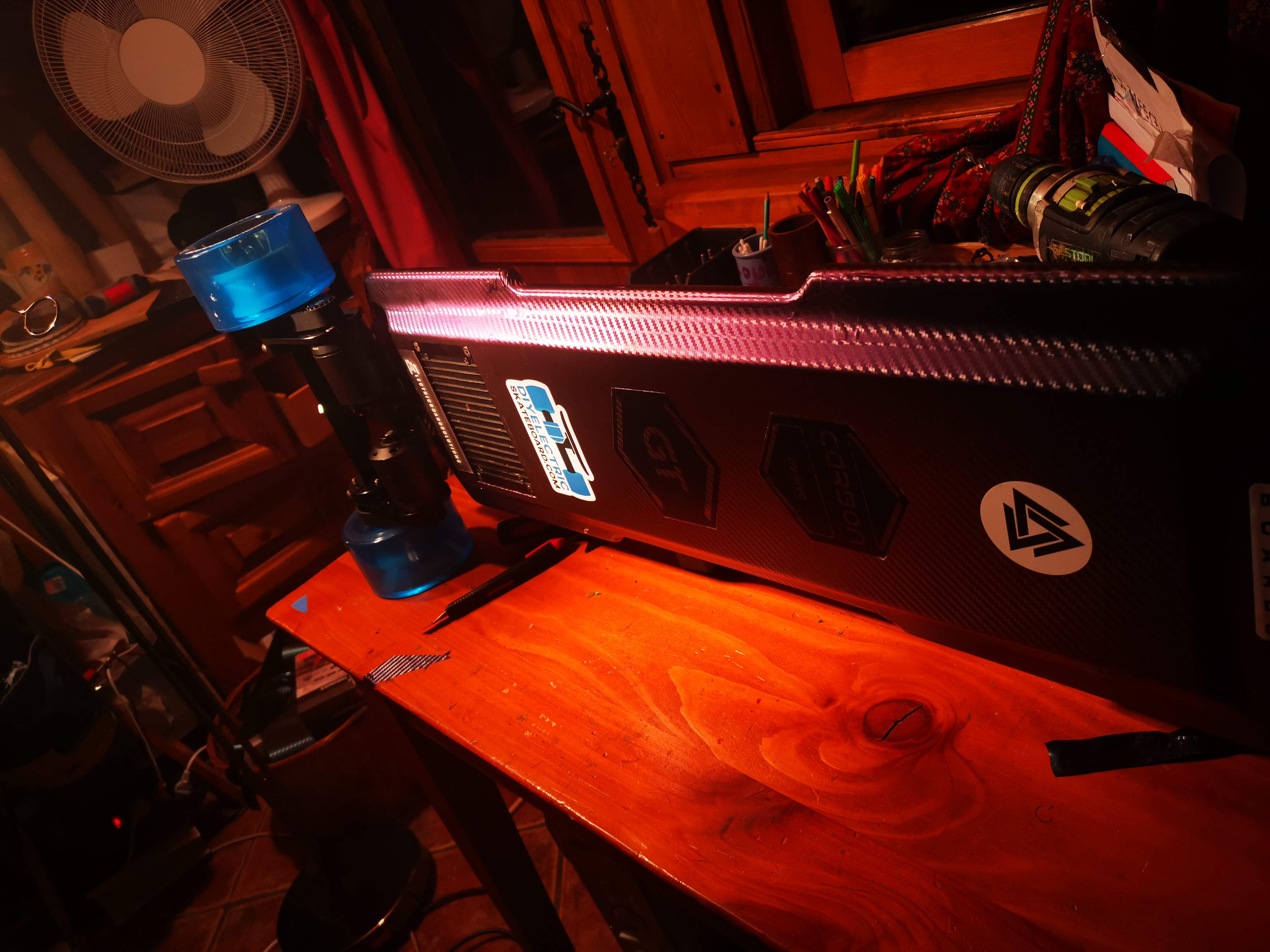

  • Carbonfibre wrap. Pretty boring deck and it scratches easily like any CF deck, so I put this chameleon blue/purple wrap. It has imperfections but you can’t really see them. It is super hard to wrap a deck like this with all the curves so I first did the and made it come down to the bottom then overlapped it by adding a bottom wrap. I will send pic for those who are concerned but this is just an aesthetics thing (some creases). It looks pretty awesome if you ask me :slightly_smiling_face:
    The naked deck does have scratches obviously but nothing unusual as you can see in the photos above.

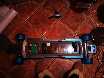

Just for anyone that comes here from eBay, here are some updates photos.
If you have any questions please contact me here or @Halbj613 (my friend which is the eBay seller)
I do see there are no photos of the screen of the r2 remote on eBay but it has only very light scratches (like a smartphone screen, only visible if you able the screen in a certain way, no big scratches… the remote is almost new, must have used like 5 times total.
Also the spare battery is now pictured below.
