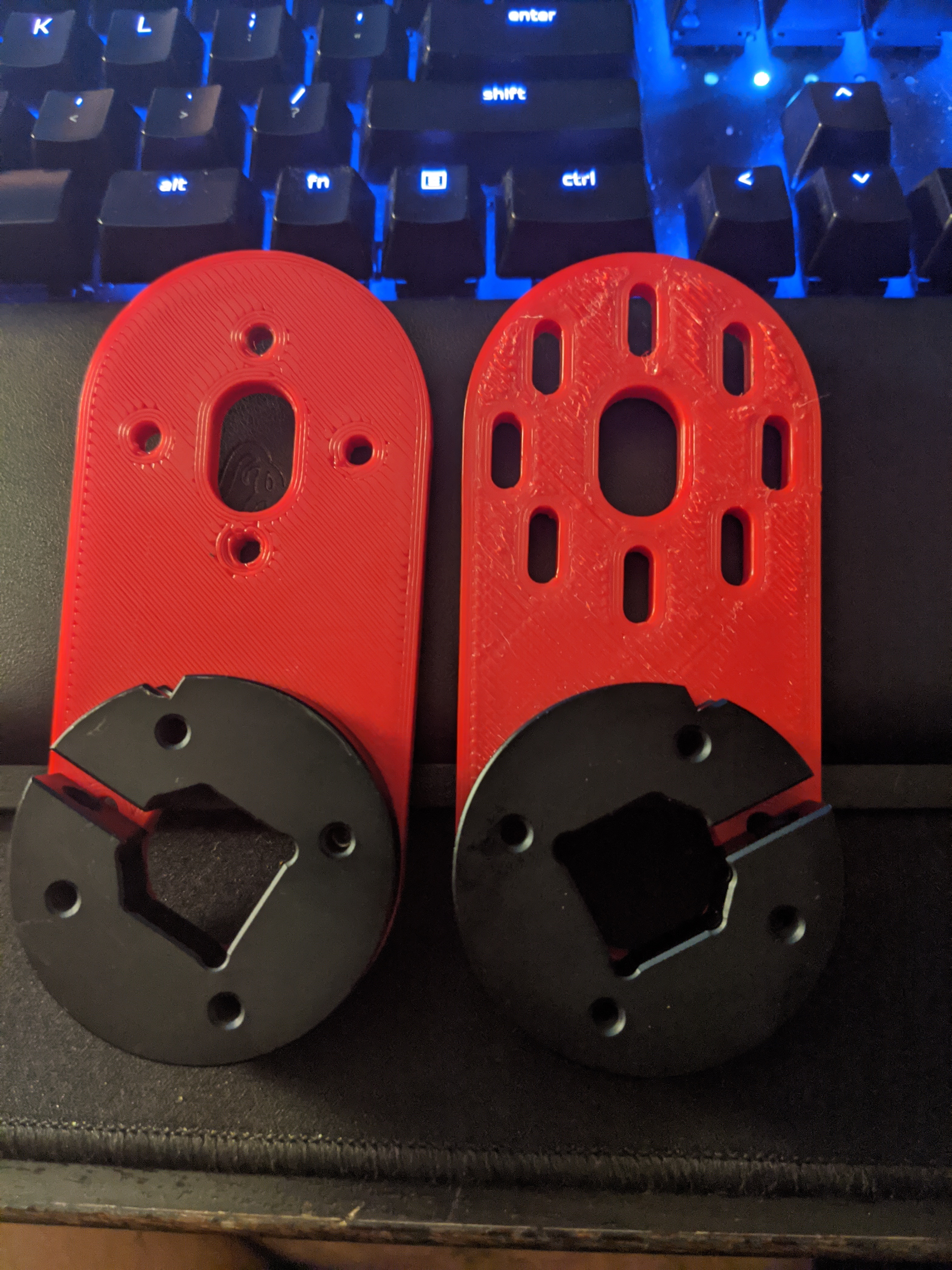

Me and @bwahl602 each have our own coyote project going. He 3D printed some custom mounts for testing purposes. Just need to get them machined.
Oh and these are 50mm fyi.

Gotta ask @bwahl602 he designed them.
Oke for sure. LMK if you guys want me to machine em
what are the thicknesses of the clamp and plate?

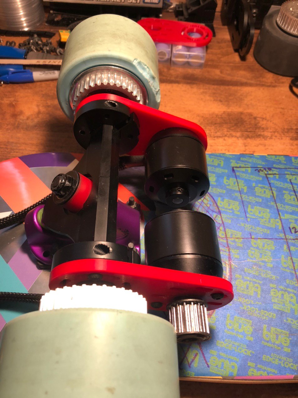

Oh those are @Boardnamics clamp and hangars. With his 184mm hangars you could easily fit dual 5055. The racerstar 5045’s are fucking adorable though. They’re super light.
sweet. yeh those 5045s look rly solid. again lmk if u want those plates machined, 1/4 inch I assume? those will cut out fairly quick
He’ll respond in a bit. I texted him. Yeah the idea for our yote builds were lightweight as possible. 6355’s are neat and all but they’re heavy little fuckers.

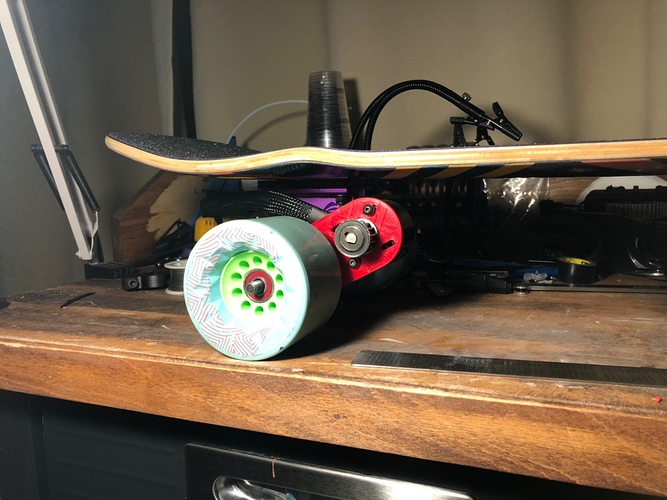

what is the length on those v4s?
yes def, in hindsight I prob should have gone 50mm. I am going dual maytech 6355
The clearance on these are solid.

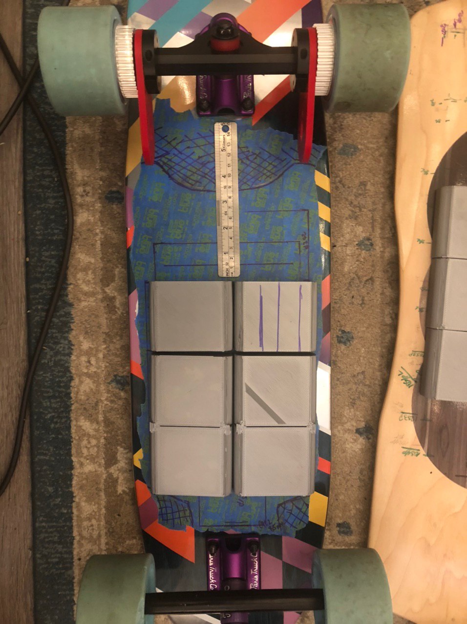

I’m jumping back on the coyote project and will get some more prototyping done this weekend.
I have strict build requirements for the coyote. Dual 5045-5055s, max clearance, 1/8 risers or none, minimum hanger width, 12S2P 21700 flat lay and room for the vesc.
Making them short and maximizing clearance is important, but the center to center distance is pretty close to the bkb mounts. There is definitely a cutoff where they get too short and the tooth engagement on the motor pulley is reduced and you can induce slip. I’ll take a look at the drawings this weekend, but we will definitely need a set made at some point and that may work out!

Absolutely. Yea 1/4 in or 6mm 6061 will be fine. They’re far from a final design. I’ll introduce some protection for the motors, cross bar support and design a pulley cover

My goal is sub 15 lb, 10 mi range and mostly a 23mph and under board. Oh and 25amps batt per side to make sure it stays peppy
