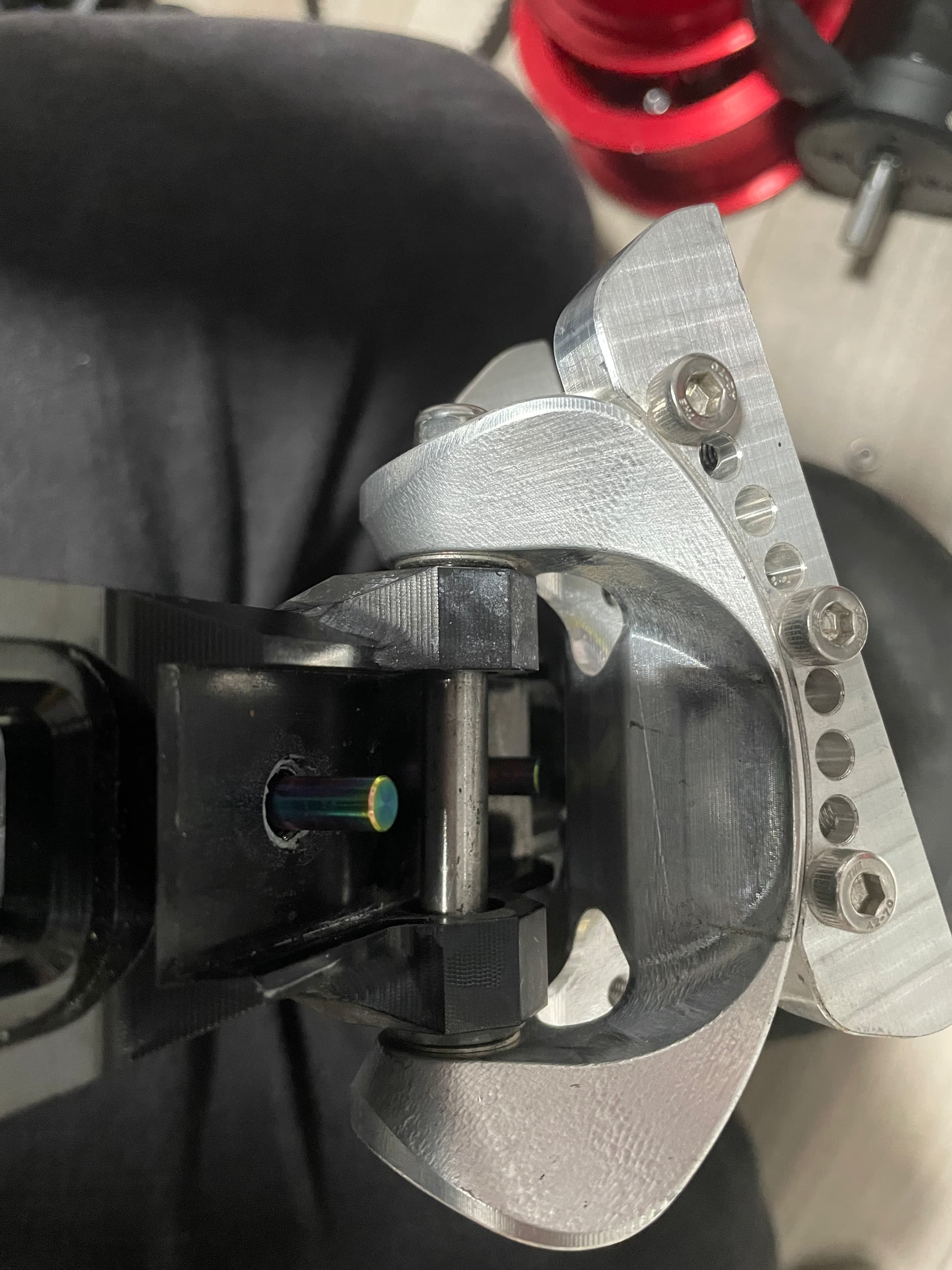

I know part of the problem is I have the GD’s mounted at an upwards angle, any lower they would almost be horizontal. The motors are just mm away from about the midpoint of the side of the V shape
So where the hand is essentially?
Yes correct, its the upper end/ corner of the motor is very close. Maybe I will just get a rear Luns truck when they are available confirming they would clear first. I would new batch 3 GD mounts to fit the Luna also
I want to say for use case these might help since you can adjust angles in the back as well but they are more wider :thinking:

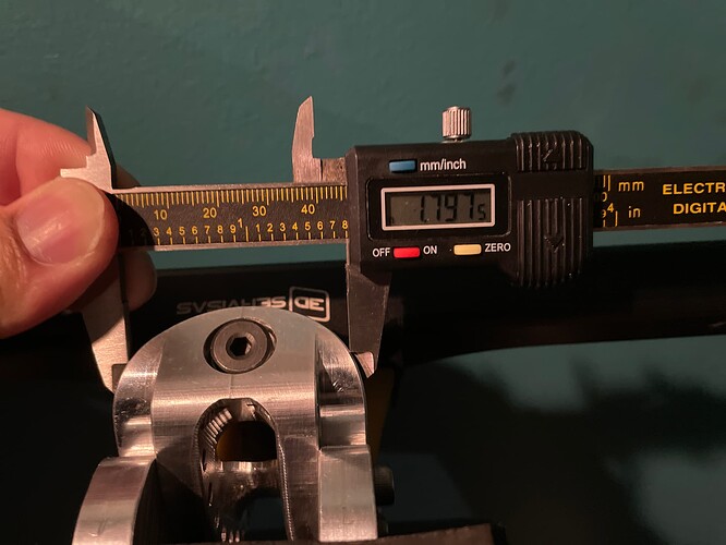

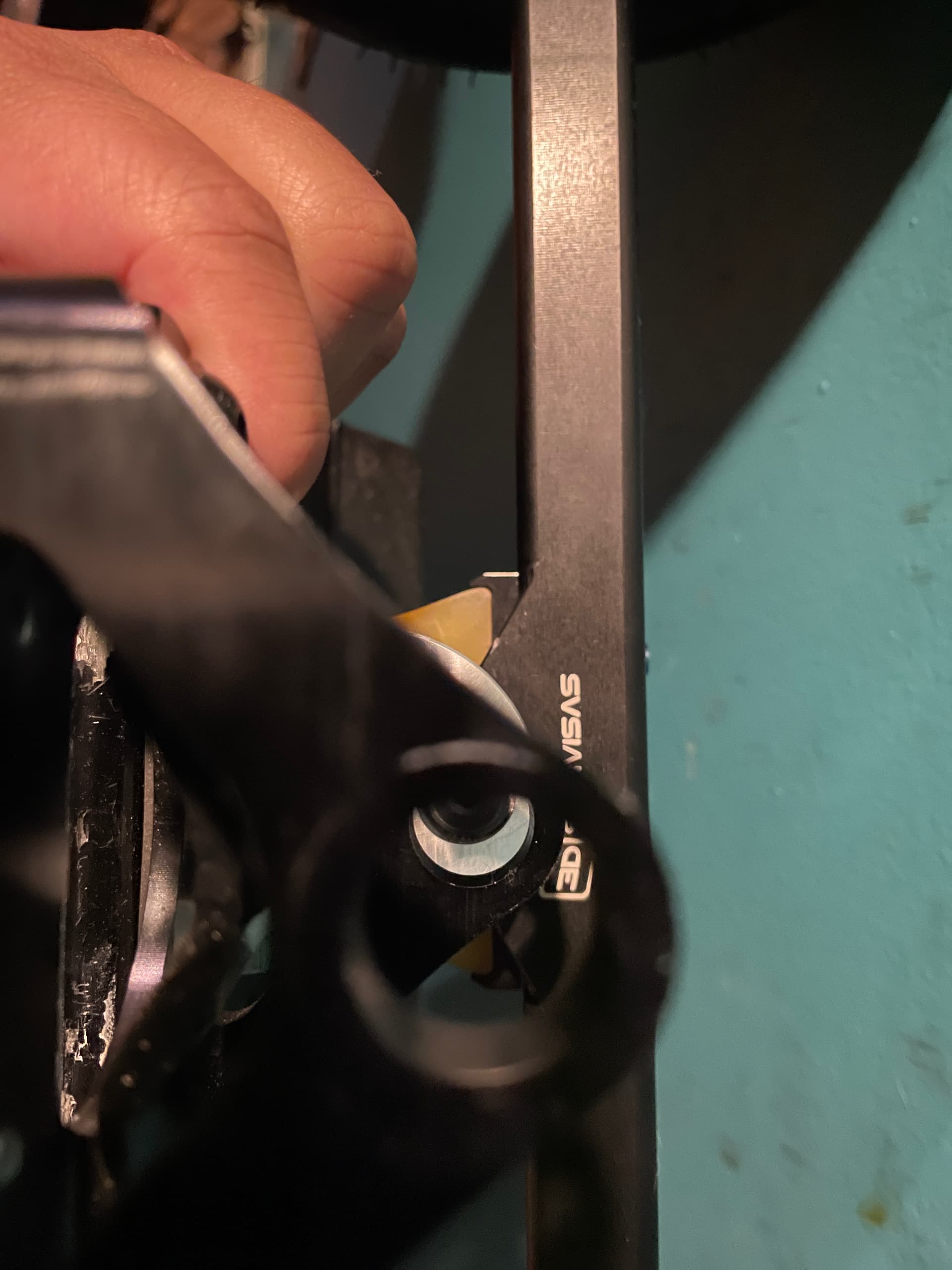

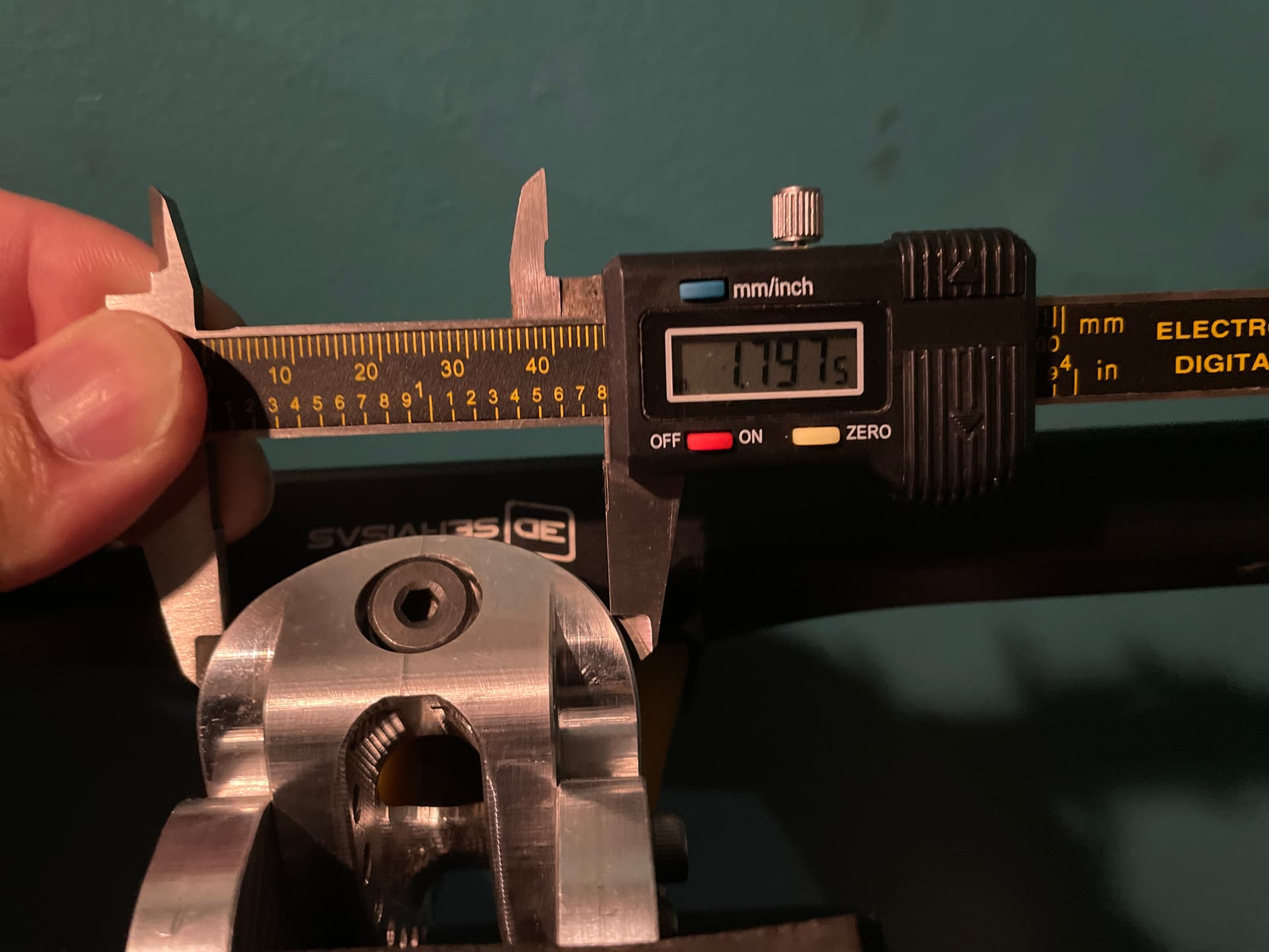

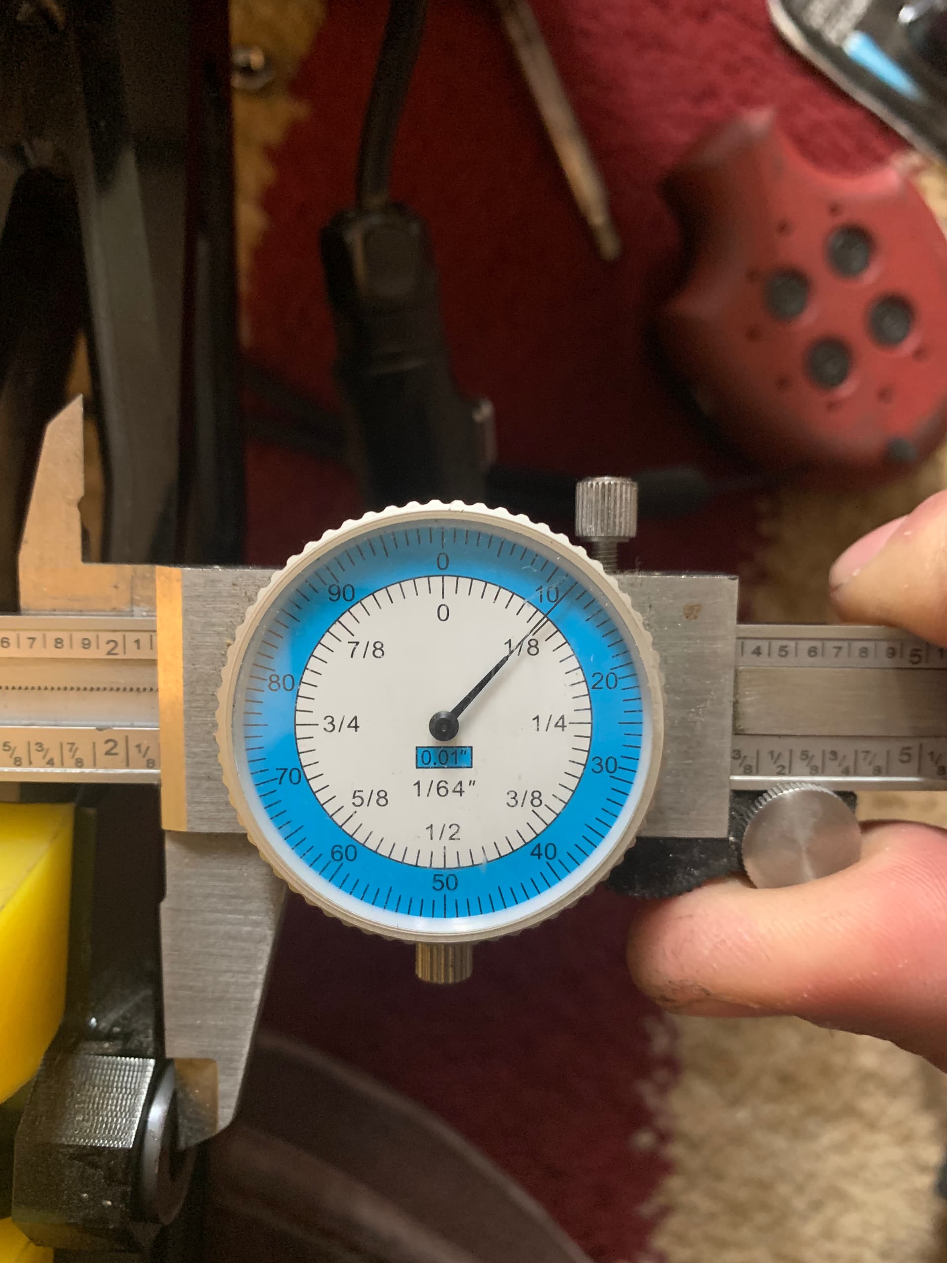

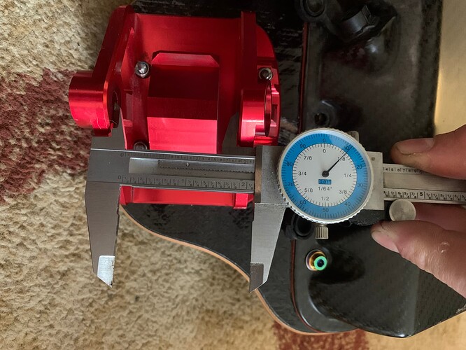

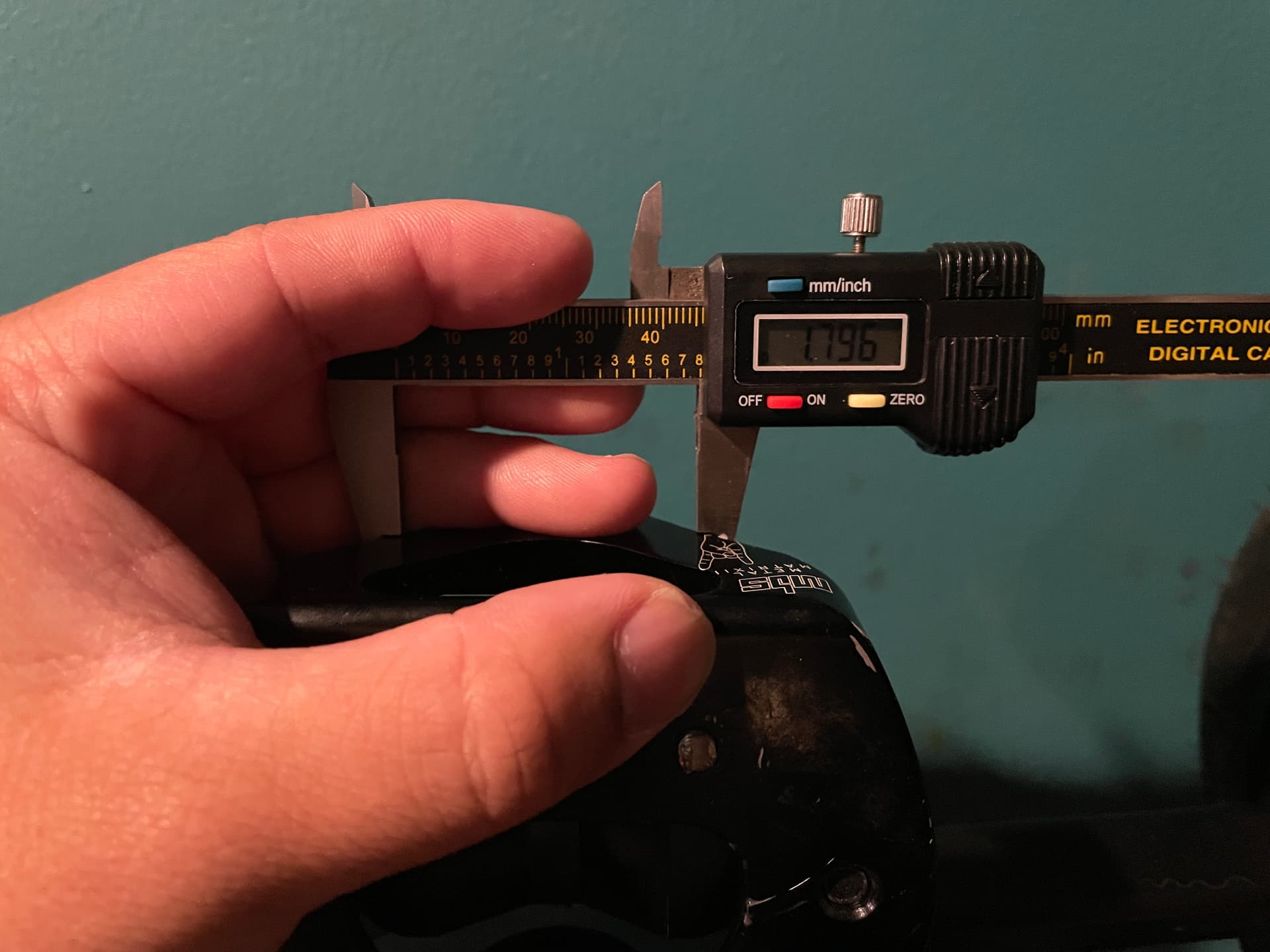

It seems like the etoxx baseplate will be too wide the the hypertruck hanger if you do not use additional spacers. I suspect that is what those brass washers are in that image.

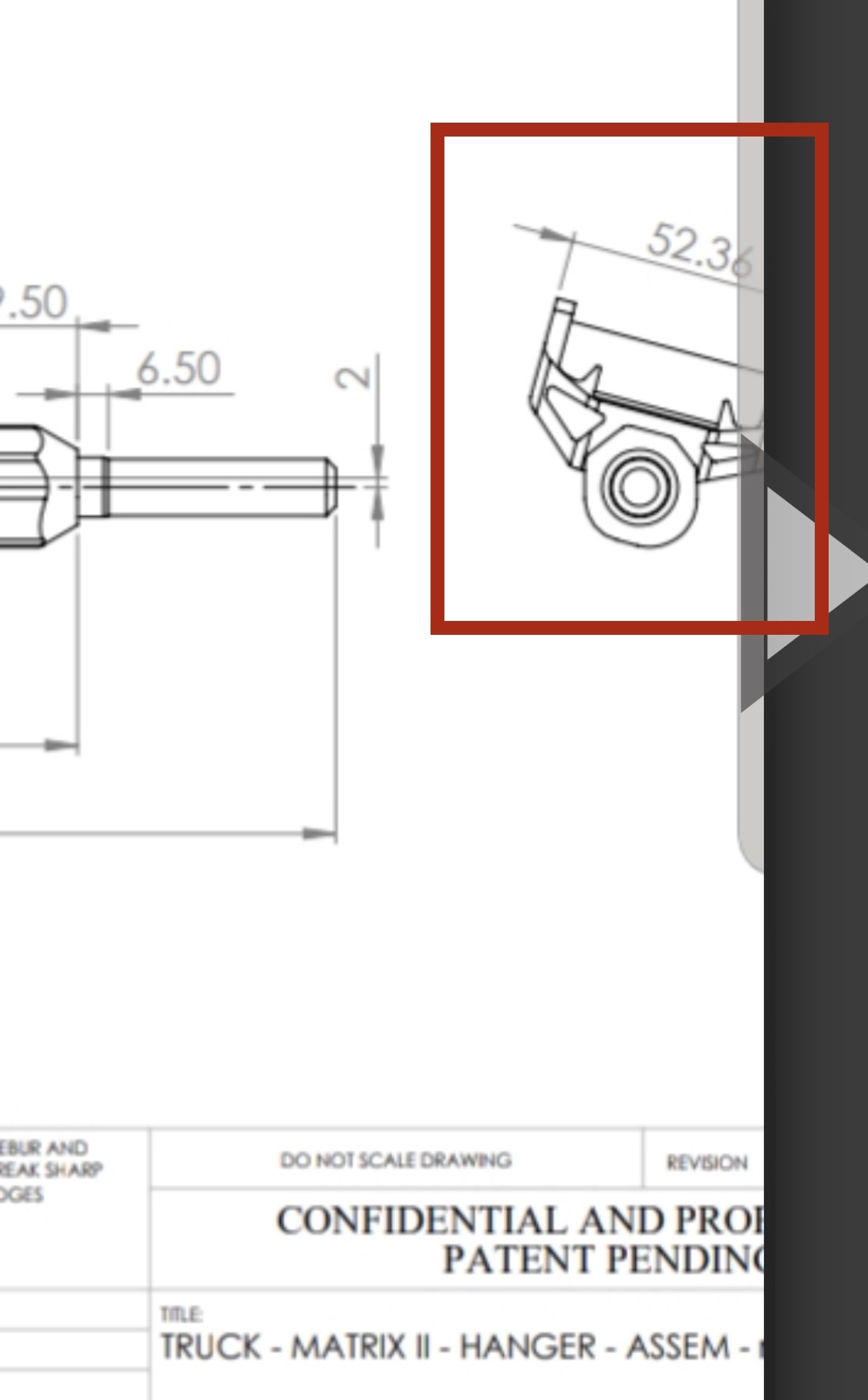

Perhaps someone can share the washer to washer distance on a matrix ii to confirm?
  • matrix ii = ~58mm. (52.36mm + 2.8mm + 2.8mm (for nylon washers) )
  • hypertruck = 53.85mm (nylon washer to washer)
@Skyart @bboybowzer
10char
My measurements suggest that it’s not going to fit unless you add some extra washers to take up space on the axle. I didn’t get any farther than that because I went with some SKP 3d printed angled baseplates instead.
Can confirm you need a a .5mm washer on each side of the kingpin depending on certain tolerances…:it can be made to work tho

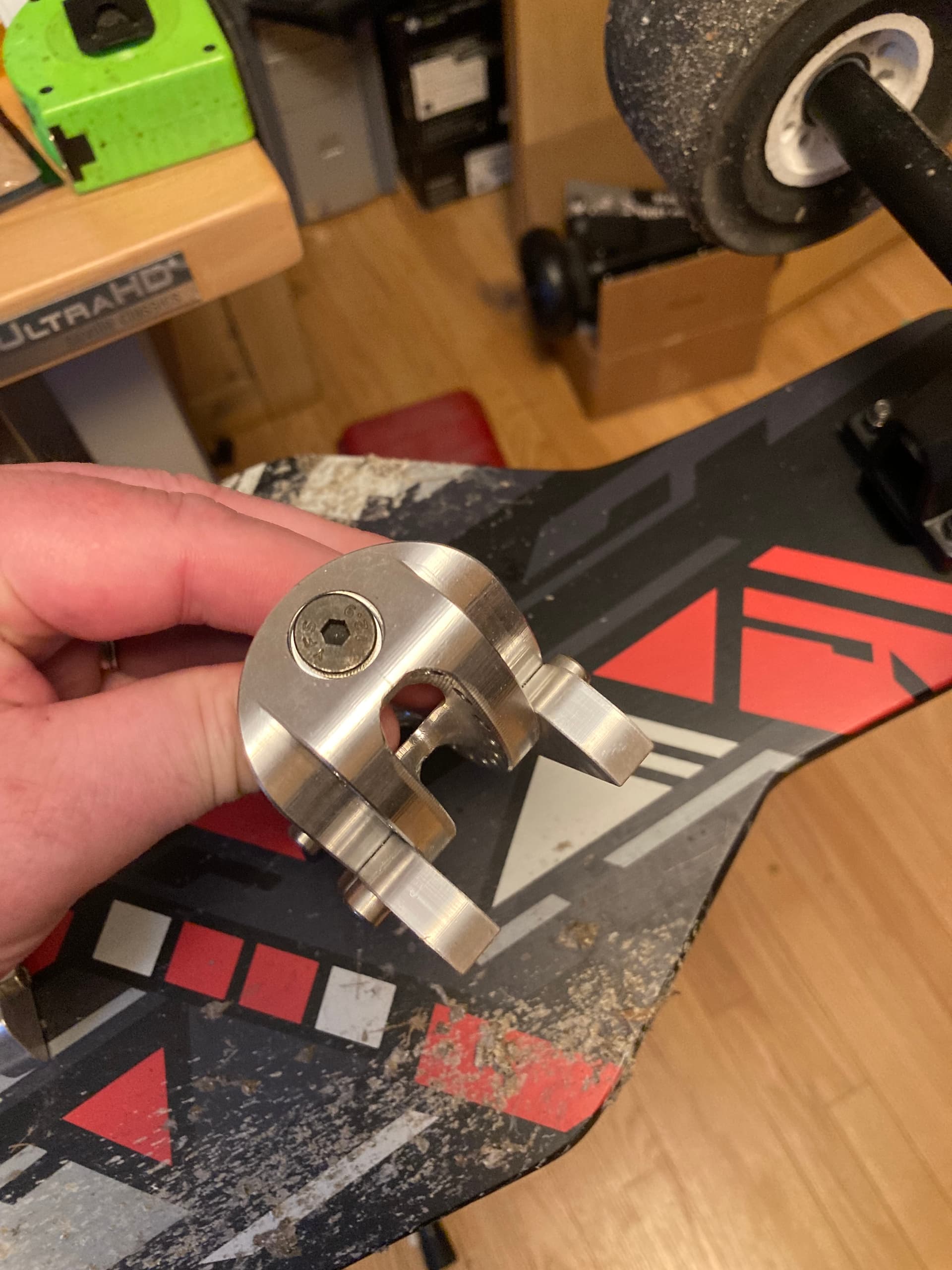

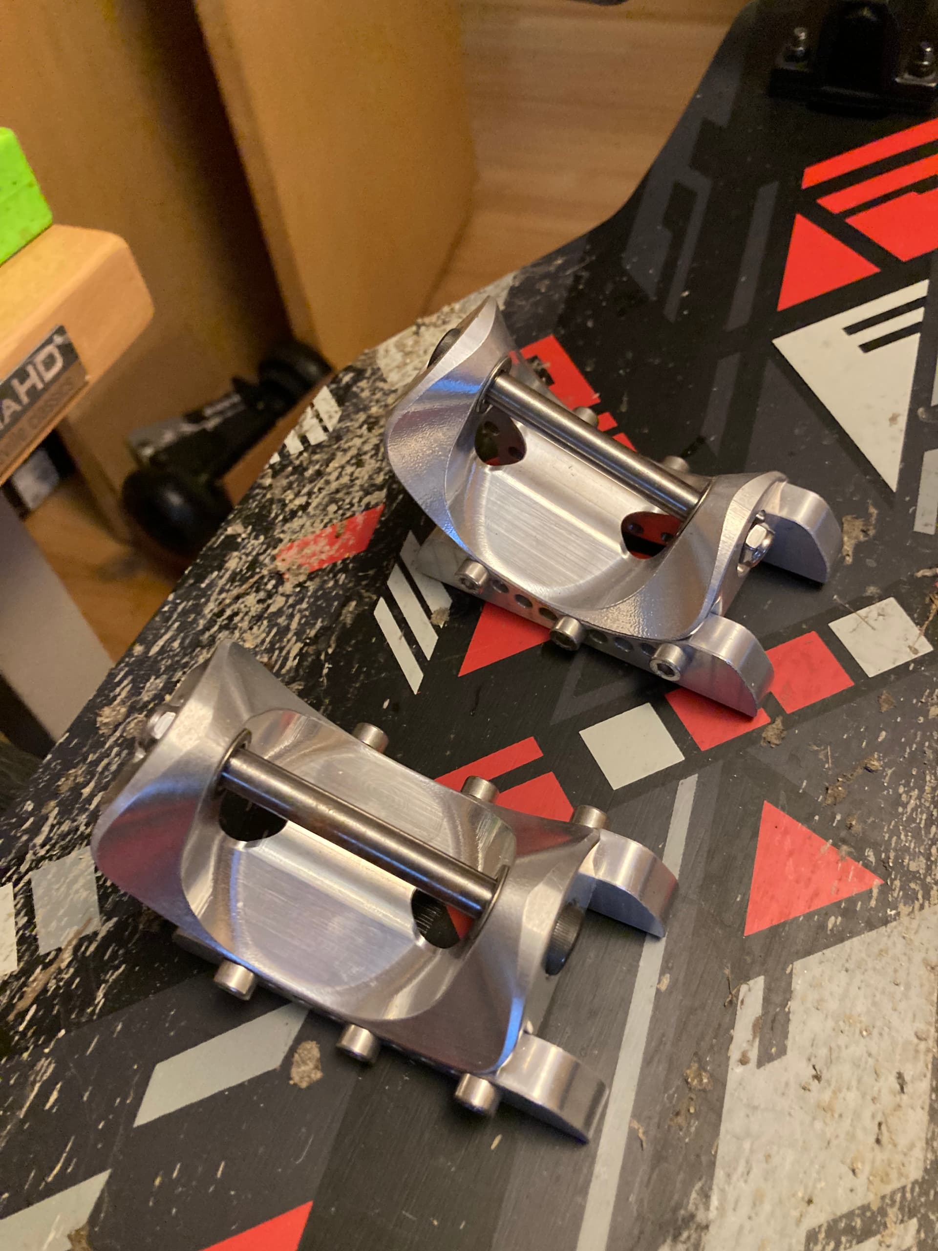

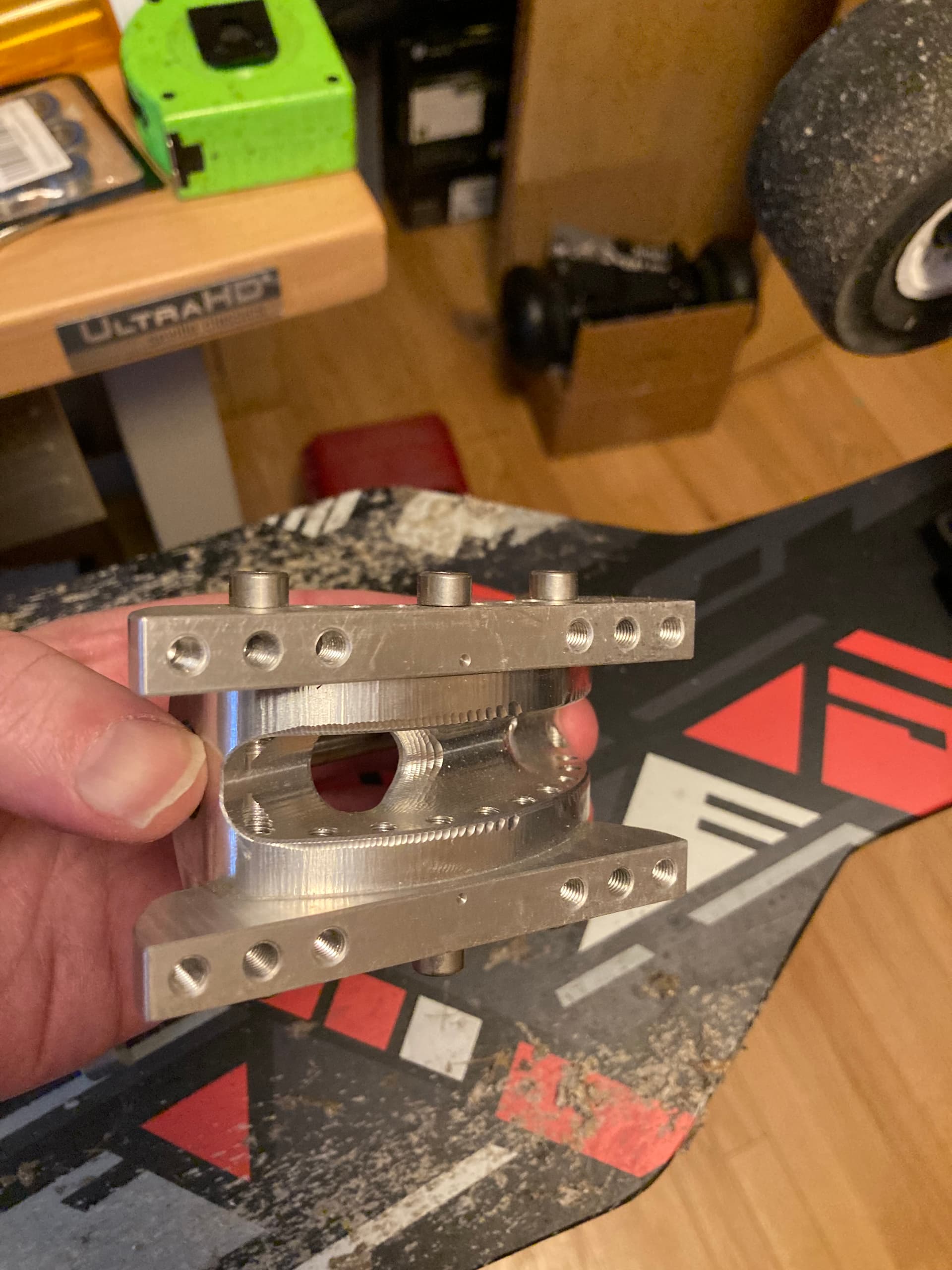

I think I actually have a pair of these that the OP was looking for. I will get a picture tonight to verify.
10char
I think these are them, @dskate you want them ?
Appreciate it, I’m going to pass but thanks for the heads up.
@m_oliver1 dm sent.
Very doable. My pair of baseplates I could force on or shave down one kingpin bushing a smidge and it would fit perfect.
