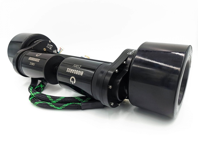

What about this kit?
Would the torque be worse with this?
you would have rougly twice the torque and around 50km/h.
Only 50km/h with the Bioboards kit?
They say 65km/h but will it be lower cuz I chose a smaller battery then?
