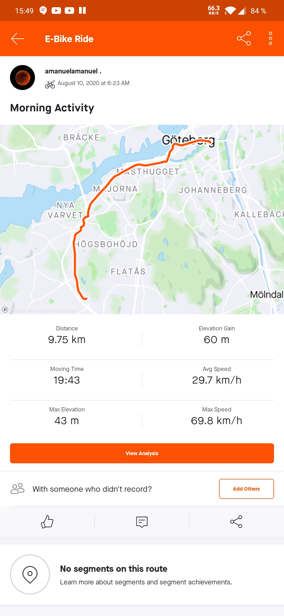

Here’s part of my usual route to work:
I was running a bit late this day :eyes:
