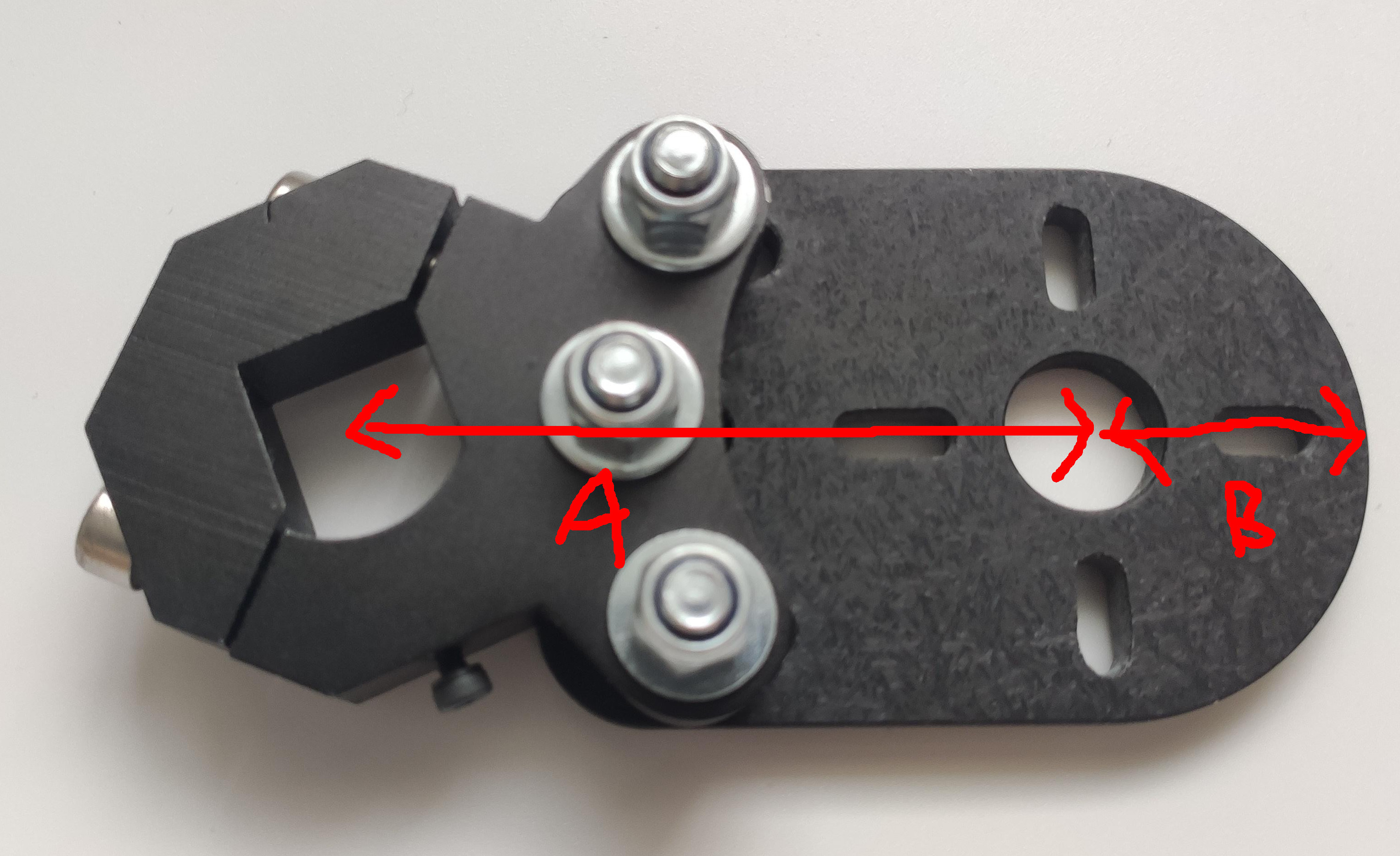

I’m currently using a TB motor mount on a TB truck (from the V6 single drive kit) but now because I’m changing the deck and enclosures I need a smaller motor mount to be able to fit everything (reason ).
I’m looking for something like this:
(please let me know if someone know the length of this type of motor mounts)
atm the options that I know are only these two:
None of them have a good reputation on this forum, moreover I tried to contact both of them about the length of the product but still with no answer…
Can someone recommend a short/small motor mount from some serious vendor from EU?

Do you just need one?
I have one in the uk. I’m away from home for a week but can measure when I get back. It’s an enertion type mount.
Yes, only one.
Thank you, I’ll wait your reply if i don’t get info sooner.

the center to center distance isn’t so small…
I think that the enertion type mount’s is even less.

Maybe the mounts offered here are a little smaller
i have 2 mounts.
One is about 69mm (nice)
center to center
the other one is about 63ish mm center to center though it’s missing the clamp.
~69mm ish
but it also won’t fit i think.
oh, damn… Thank you for the comparison.
How much it measure the length of that motor mount?
Center to end 95mm minimum which can be extended to 103mm or 110mm depending on what screw you use.
xsynatic:
95mm minimum
do you refer to this measurement?
Yes.
Middle of the axle to end of the mount.

The enertion mount is the closest I’ve used.

I just bought an Enertion style motor mount from @infiniteoffset who contacted me via PM.
Anyway, thanks for your time!!
The A dimension is 64-72mm and B dimension is 28mm.
The best belt’s length for this should be 265mm, do you agree?
https://www.bbman.com/belt-length-calculator/
Use this instead of my wonky ass brain trying to make sense of numbers in calculations.
@edoardoconti you have to click on “metric” twice so the window for the center distance appears.
I tried, with 64mm of desired center distance (shortest config) I get a belt length of 262.0mm
So 265 is the best one imho
