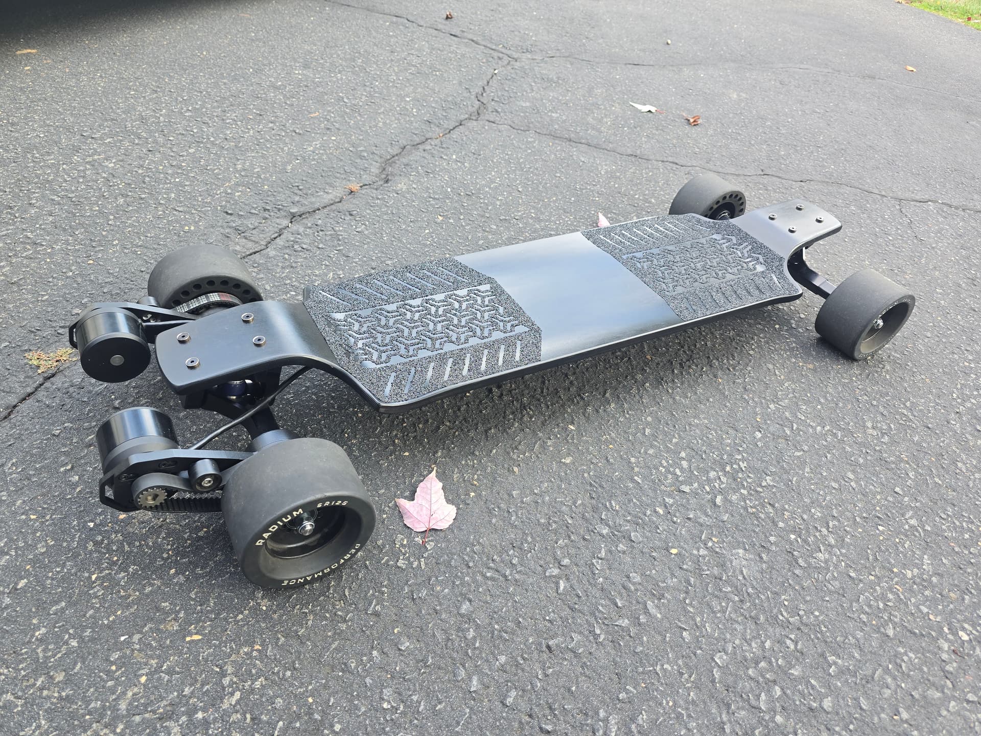

@andoug has Dualitys and SR125 going. But on an angled deck.
Hoyt Tabor deck/enclosure might fit this, depending on the battery construction. Hit up @jack.luis for more info, i heard he used to work for Hoyt.
I actually have them on a flat deck now. But this deck can’t house a 12s8p.
Edit: I guess actually this is angled, but not like a mtb

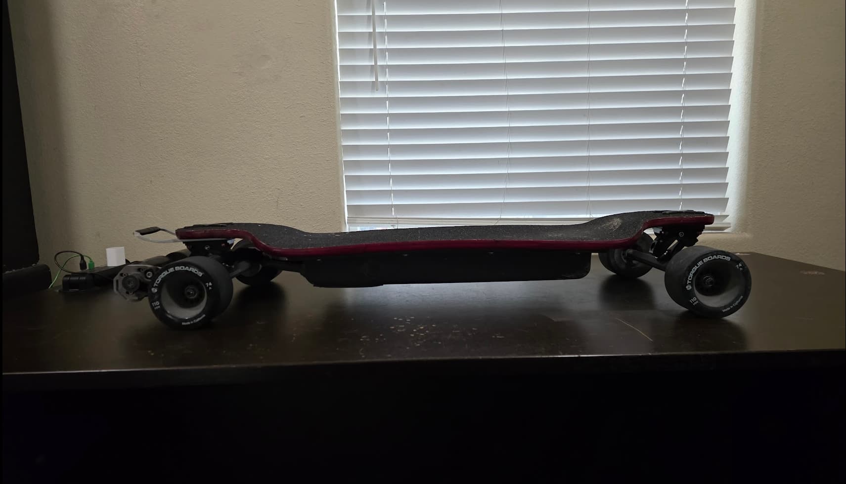

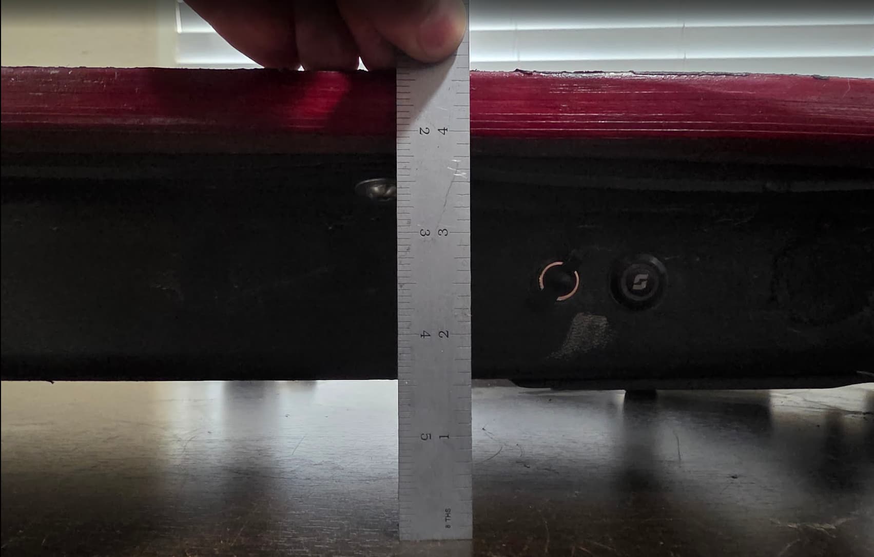

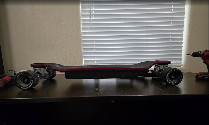

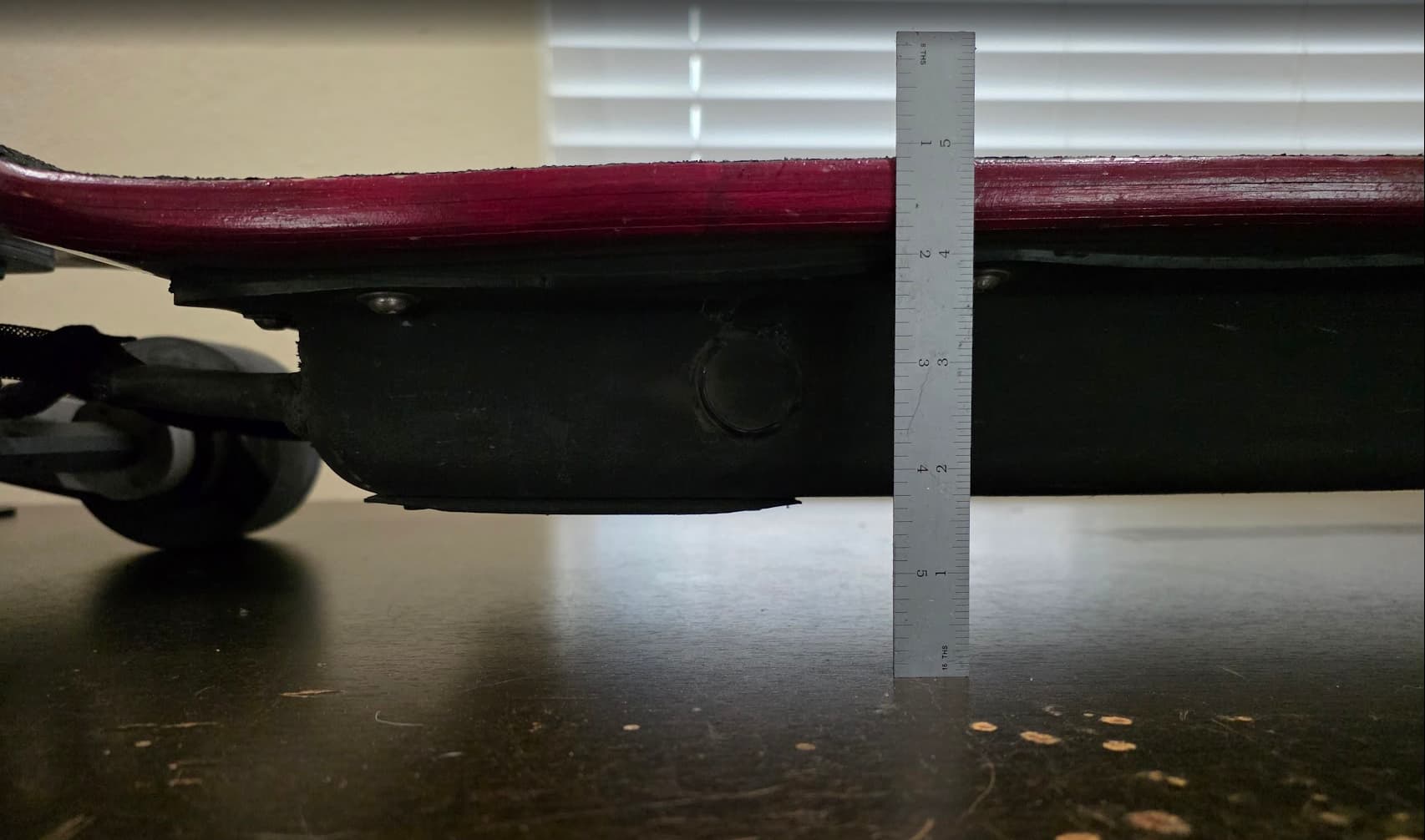

Are your Duality trucks the street version? If so, I’d be careful pairing them with a double-stack enclosure and a deck that has even a small drop, like the Tomiboi Liquid Sword.
I’m running that deck with one of his double-stack enclosures (might be for sale soon), and the street Dualities turned out quite a bit shorter than the BN adjustable baseplates and hangers I’ve got on it now. I already get a little scraping with the BN setup, so the shorter Dualities would probably make it worse.
I’m on Torque Boards 110s, so 125s might clear fine. I can probably throw one of the trucks on to give you a better idea if you want.
That’d be great, still in the early stages of planning this build so this is very helpful
Yes they are the street version
Im planning on running 1/2 inch risers at least, potentially more if needed
You got it, bro. I will get you some pics later this evening.
I should have noted that I have 1/2” risers installed already, as well.
Here ya go!
With the current BN setup, I get a little scraping on my ESC heatsink from time to time (mostly when hitting rough/damaged bike paths). You can see some plastic that sits slightly lower — that’s the cover for it — and it’s about as low as the metal bottom. I have a 1/2” riser installed on both setups.
Boardnamic’s:
Tito’s:
My Tito’s are meant for a different deck I have on the way, but if they were for this one, I’d probably still run them — just a bit more carefully. Hope these photos help!
