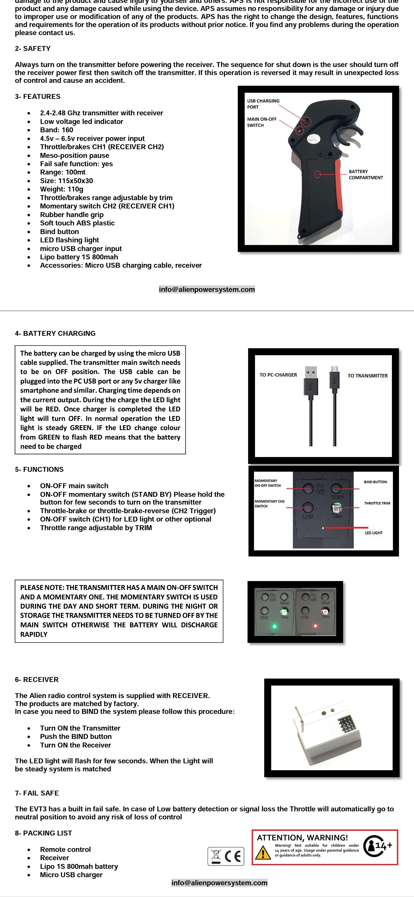

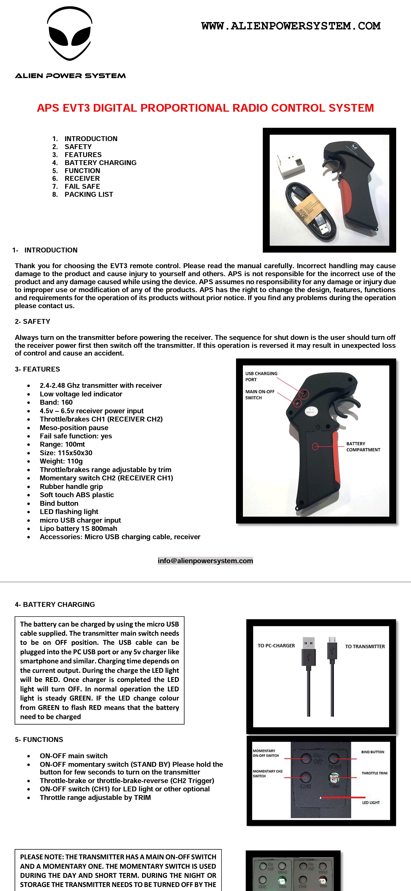

Just throwing this out there. Might help someone.

This doesn’t tell you what channel on receiver to use or anything. Its really not a very good manual. First thing i did when I got the remote was read this.

Ch1 throttle
Ch2 button on top
Ch3 bind
(I have one I ain’t giving)

I tried all the channels and wasn’t getting a ppm signal.
