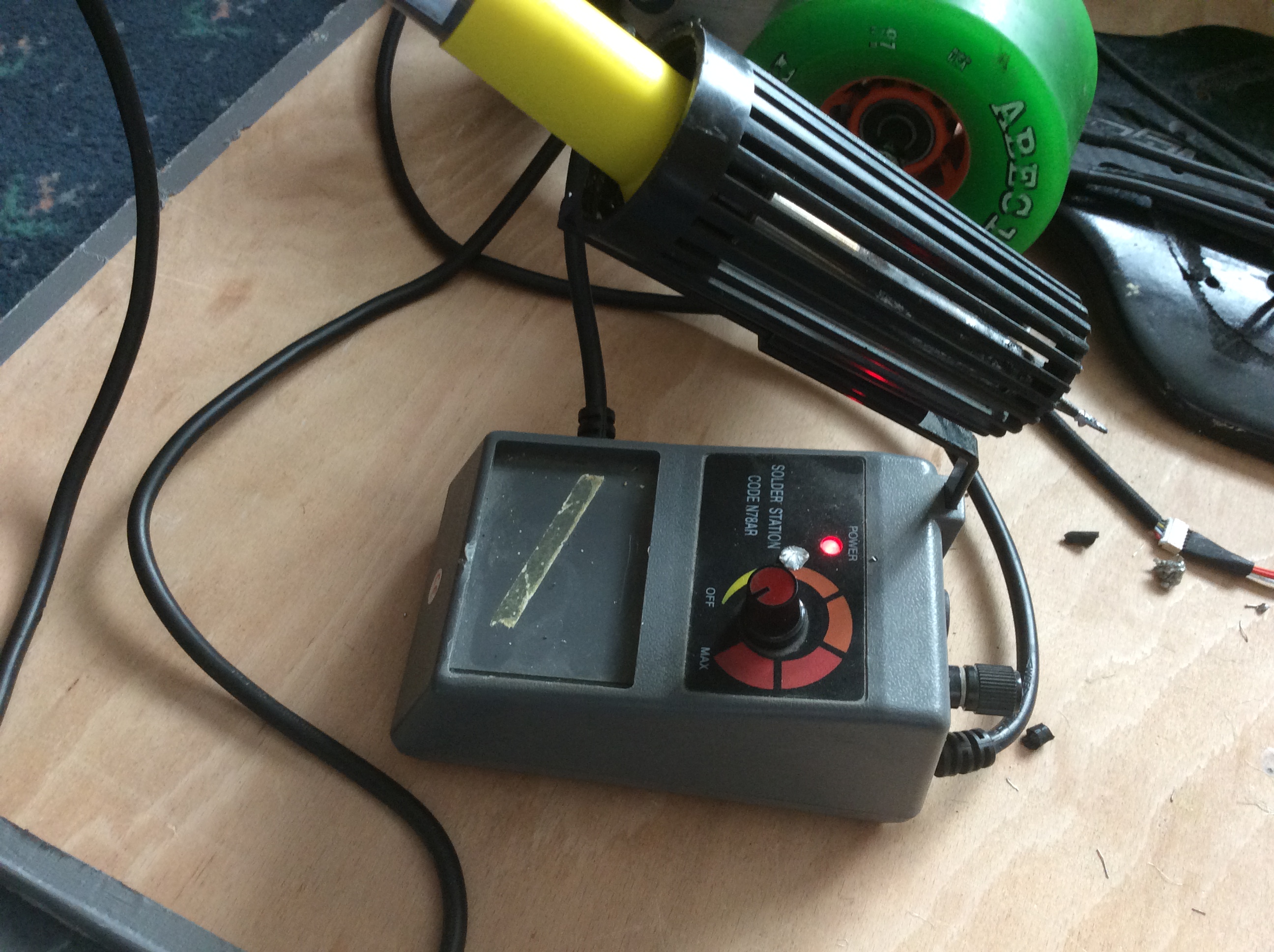

The phase wires are held on well the problem is with the xt90 that I can’t get it hot enough to melt the solder

Xt90 are much harder to solder than bullets
Please check out some videos on YouTube your soldering is absolutely awful, you will get hurt or destroy your bord. You need to properly heat it and fill them upp completely. Just because to stick to the bullet when you pull them doesn’t mean they will stay there. Crappy soldering is a weak point that under stress will loosen or generate heat.

what soldering iron / station are you using?

THis one
Also when soldering connectors that have no housing, don’t hold them with a metal tool. You will transfer the heat from the connector to the tool and you will have a much harder time getting the solder to mealt.
It could be the case, that the tip is worn out and he have to consider, to buy a new tip. And I clean my tip ervery time with a soldering sponge, when i had done a soldering joint.
Before you start soldering when the tip is hot, clean it of on some wet paper and apply a small amount of solder so you maximize the heat transfer. Do this before ever solder you make
above both valid, also could be this unknown mystery brand soldering iron just doesn’t have the wattage to get up to temperature.

Clean the tip of the iron regularly with a tip cleaner (copper tangle?) and a damp sponge.
Use Flux on both wire and connector.
Pre-tin the tip, the connector and the wire.
Use helping hands.

Yes its probably to weak to do the XT90, with a solder iron with a small tip like that it will take at least 30 seconds before you even can start trying to apply the solder. You will need solder flux also so it fills the connector properly if you don’t have really good solder with a proper core of flux.
You need to put the solder iron that has been cleaned and prepped with solder so it touches both the wire and connector at all time until you are done, don’t remove it until you are completely done.
Use a plier to hold the XT90 and put as many rubber bands as needed on the hendkes to get the force to hold the connector steady.
