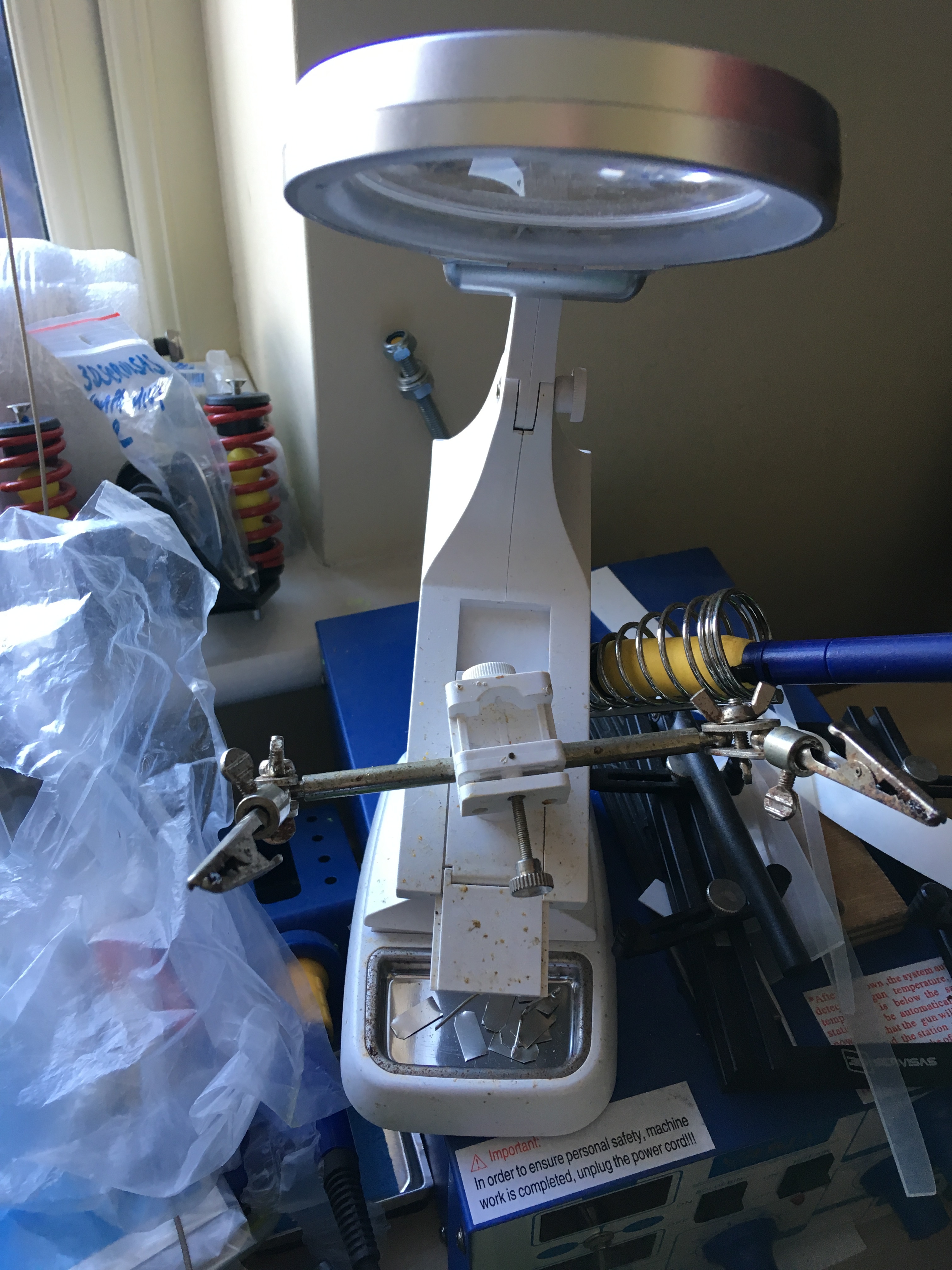

Yes it’s unusable as is. Also get some ‘helping hands’ or a connector/bullet soldering jig, you have a lot of learning to do before being able to just throw a wire into a bullet on the loose and get a good result

Ok I’m maybe not being as helpful as possible I’m just having a little fun with the answer since I think that you would know that yes you need to reheat the connections in order to liquefy the solder and separate, this is where helping hands really help
The solder hardens very quickly so better if one hand is holding the iron and the other one pulling on the wire…so the other side needs to be secured sonehow
With this much poo on the bullets they would benefit from a mop up with copper braid, get a piece and have the tip of the iron on one side, the bullet on the other
