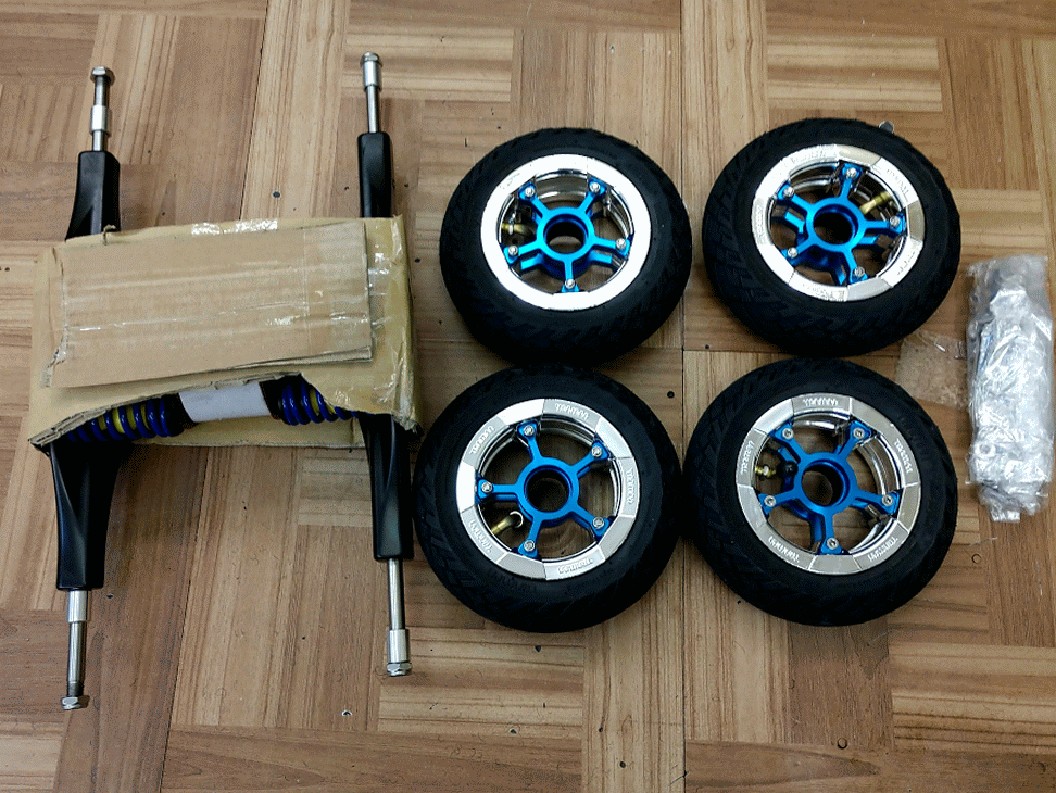

Trucks: Front ULTIMATE ATB Hanger - 9.525mm TITANIUM Axles, Rear VERTIGO E-MTB Hanger - 12mm HOLLOW Steel Axles
Wheels: Superstar 6.5 inch wheel - Pimp Chrome SUPERSTAR Rim with Low Profile 6.5 Inch URBAN Treads Tires

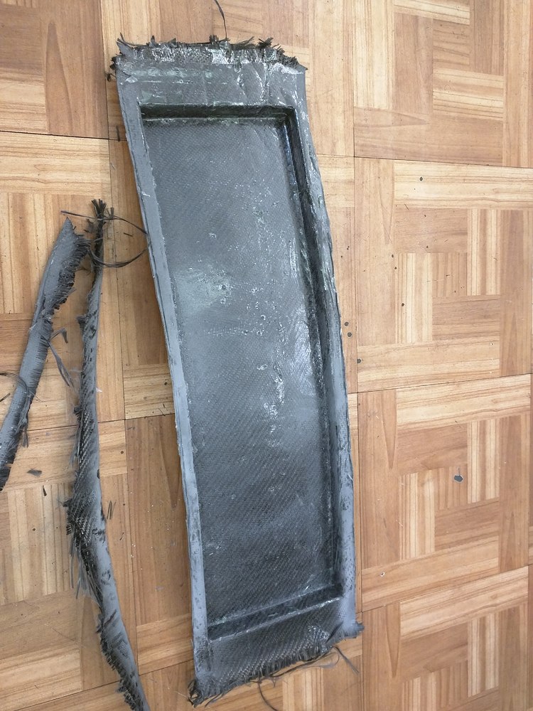

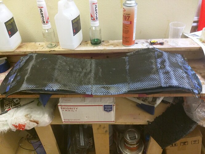

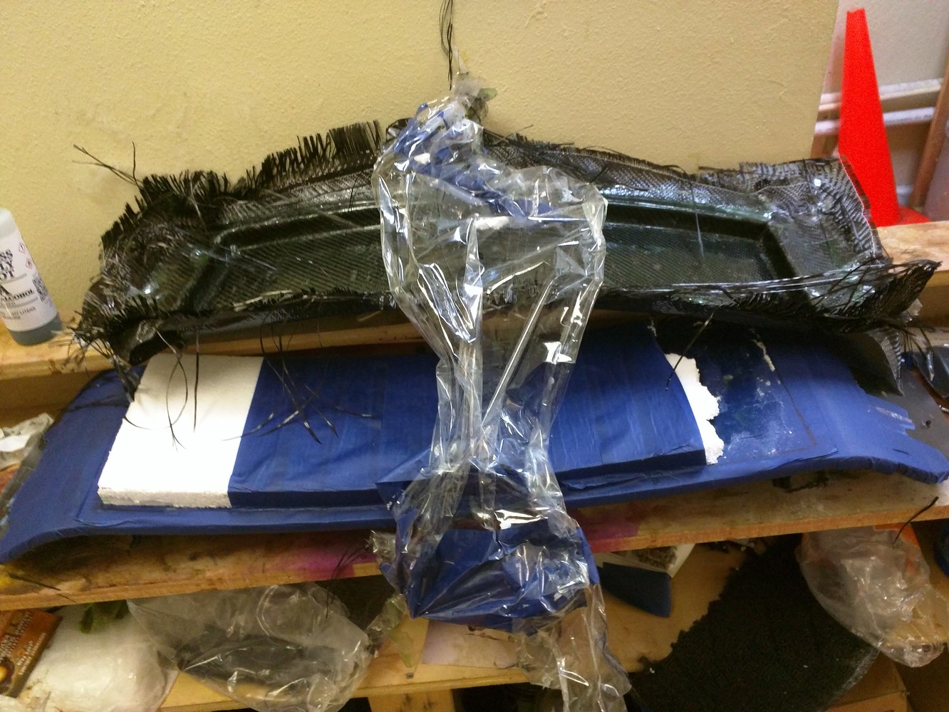

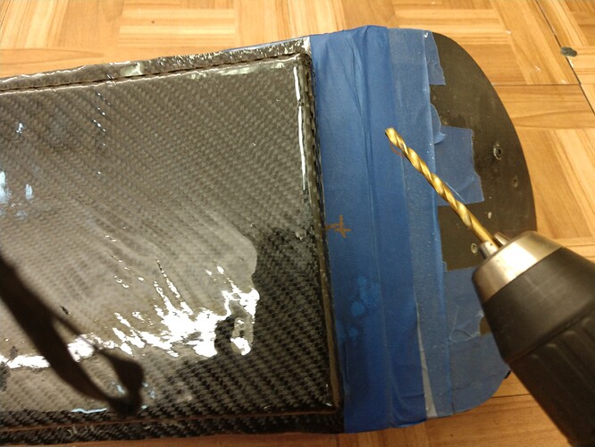

Making of the carbon fiber enclosure.
Taping the board so I can lay carbon fiber and epoxy over Styrofoam.
Measuring and cutting Styrofoam.
I use headliner adhesive to stick to tape as mold. But not to much cause adhesive will eat the Styrofoam.
Taping Styrofoam with masking tape then going to lay scotch tape as barrier.
Then spraying release coat and let dry before laying epoxy.
After release coat is dry lay carbon fiber.
Let carbon fiber and epoxy set and cure.
Trucks came in.

Pulling and seperating enclosure

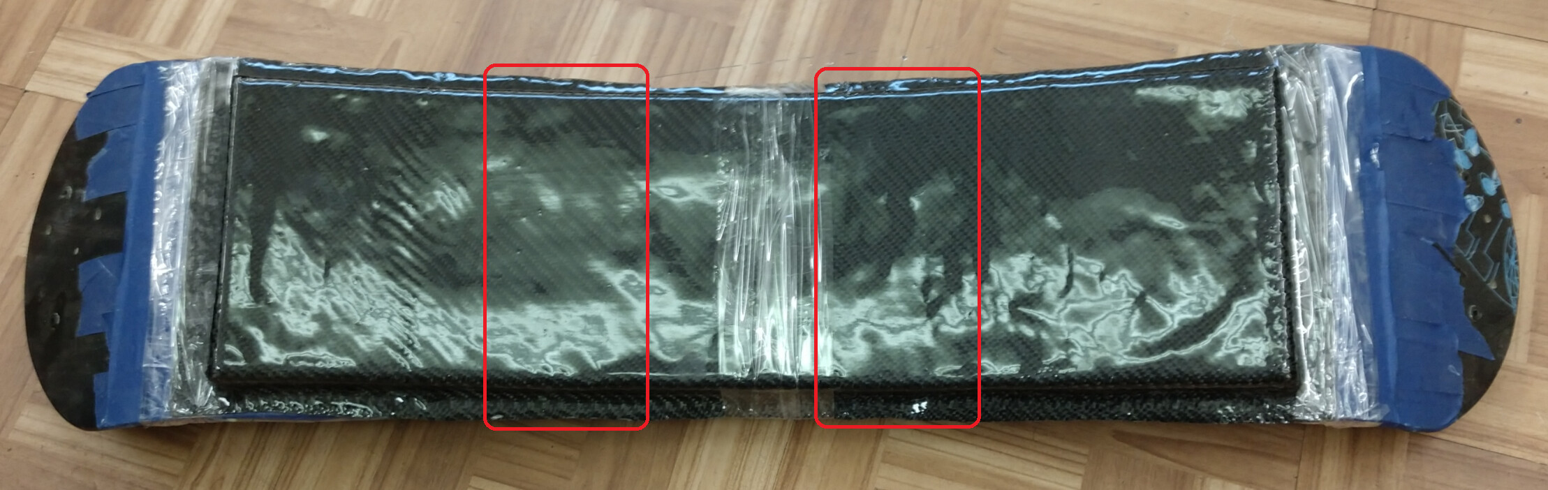

I don’t know how flexible are those decks (I would say quite a bit), but a single segment carbon fiber enclosure will be very stiff and offers no room for flex. My guess is too much flex and the enclosure will crack. :neutral_face:

Thanks for the concern. The board is extra stuff and the segmented enclosure doesn’t fit to the contour of the board as I would like to. I do understand.
I meant to say extra stiff. The board doesn’t flex at all. But I have extra custom enclosures. If that seems to become a problem I also have the segmented enclosure as a contingency plan.
Yea I got you the first time don’t worry. :slight_smile:
You could try “jumping” (foots not leaving the board) on it and record that if you want to be sure. :+1:
The board does have some flex. Tell me what you think.

The carbon enclosure will make it more rigid but I would personally advise against going this way.
The issue is that the enclosure have no way of moving with the flex, putting the stress on the inserts and the middle part of the enclosure. It might works until it doesn’t.
Maybe I’m too cautious. If it breaks, you could make a segmented carbon enclosure for the next iteration. :slight_smile:
Thanks for the concern. I have considered the implications of going that route. So I’m in the process of rethinking my development. I might make a carbon segmented as you suggested.
