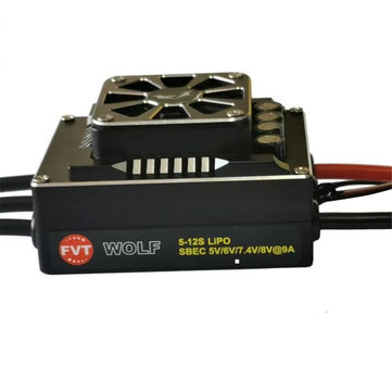

WOLF 200A PRO Aluminum Alloy Fully Waterproof Brushless ESC

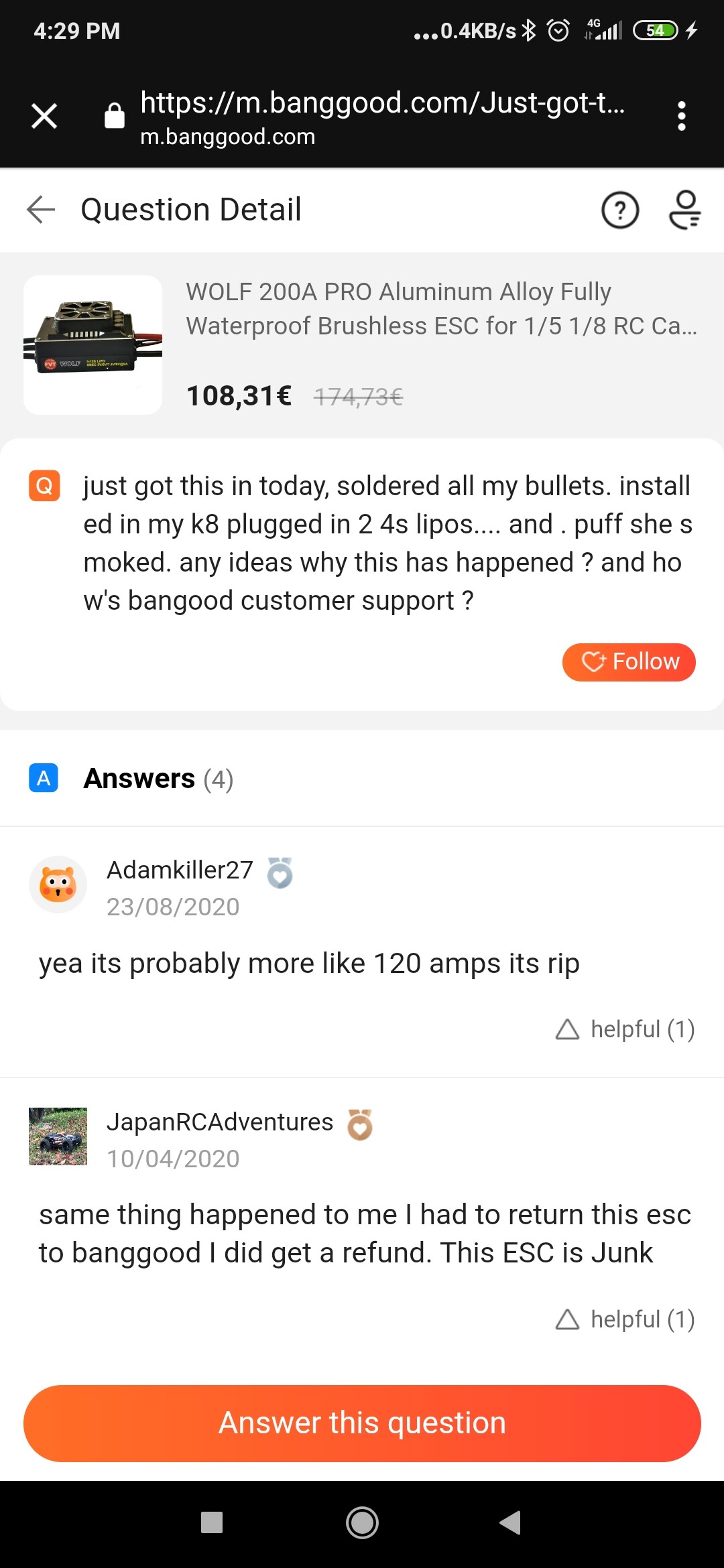

So just curious if anybody has tried this ESC from FVT, specs seem kewl and pc programmable, gone from 170 to 108 euro on BG (not saying much lol)
Its rated up to 14S on FVT website :flushed:

I tried using RC car ESC… It was not good.
battery usage was 25-50% higher than Vesc based, and the no matter the programming (including replacing the firmware with stuff I wrote) the braking was always too weak or too strong.
my opinion is the processors just aren’t good/fast enough to handle the response that a human rider expects
