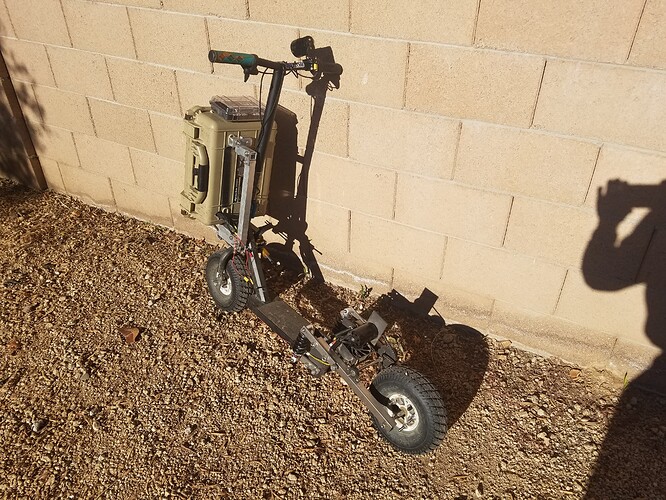

I started off with this:
And turned it into this:
Specifications:
Top speed: 35.4mph
Range: about 90 miles cruising at 28mph | 75 miles with lots of stops and accelerating
Battery: 12s1p LG chem N2.1 60ah
ESC: ZTW Seal 150a HV
Gear ratio: 99/2380 (11 x 9, 68 x 35)
Tires: 4.10/3.50-4 mounted on MBS fivestars
Inside of enclosure:
Tons of space left for more batteries if needed
Conclusion: Overall this build met most of my exceptions. This small motor paired with the boat esc really packs a punch. The scooter has about 150 miles total with only a few minor hiccups.
With that being said here’s a few things I would change:
If it wasn’t obvious enough, the build is really ugly. I need to organize my wiring and redesign the enclosure mount. At least everything functions as it should.
The deck is a bit skinny and the handlebars are a little short so i’ll have to get a welder and modify them a bit.
The primary reduction stage is a bit noisy due to the high rpms, so I’ll be changing that to htd5 belt drive soon.
Oh my god lol sometimes it surprises me what people come up with to get themselves around. That range is crazy
Congrats on your build haha although I think you’ve got a ways to go aesthetically. How does it turn with all that mass on the handlebars? I imagine it being very odd
All the weight on the front end helps a lot with gravel patches in the road. Specifically when turning.
Hm very interesting. How heavy is the battery?
about 24.5 lbs. Total build weight is 60lbs.
The double gear reduction and self-made suspension is really cool!
Edit: wow, you even have a stabilizer on the front
Thanks man. I wish it looked a little less ghetto though. Y’all make such clean looking builds that make mine look like it was built with a box of scraps.
I’d watch out for your rear suspension.
Doesn’t look like theres any bearings?
Just screw on aluminum?
That’s not ghetto bro. @ShutterShock is just really pretty.
It’s an industrial look! And, it has massive range lol
Everyone can improve on aesthetics with experience
Both the threaded rod and plate are hardened steel coated with marine grease. I checked yesterday and nothing has worn even slightly so it would probably take thousands of miles before any slop were to occur
