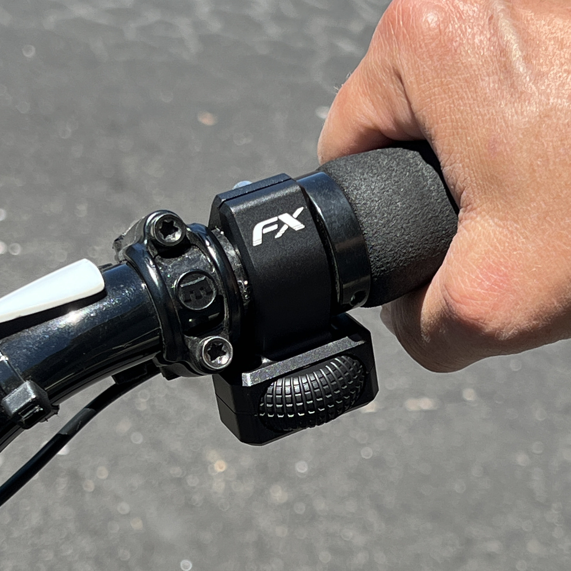

In the discussion of what one can actually buy today in the way of a nice remote, someone pined for a wired remote. Why is this not a thing today?
Having really enjoyed a test ride on a scooter with a beautiful knurled aluminum bi-directional throttle/brake, I’d like to carry the same at the end of a bar stub, at the end of a coiled phone cord.
If it goes tumbling, who cares? Skating past Lollapalooza? Who cares? Cord rips out by the roots? Who cares? (You’ve got a new $3 cord in your pocket.)
I swear I saw such a beast for $50 several years ago, now crazy folk are asking $150-200 for a fancy wheel. No idea what this one costs, but sawed-off, this is the general idea…
I intend to make & try this out, in lieu of blowing $200 on another pair of Pucks.
[Expecting Crickets] Who’s with me!?
Noodling on failure mode when cord severed… No way can ADC be used. What happens if a PPM signal suddenly disappears completely? If this can be treated as mid-throttle (neither braking nor power) by VESC, the circuit to make PPM from a pot or hall sensor is already sold as a commodity part for under $7 = a servo tester. Consider teh phone cord to carry PPM, +5V, Gnd. I need to see what happens & if I can force coasting when PPM wire disco. Can anyone who’s had a ppm remote wiring or receiver failure speak to what happens? (Not counting dead remote battery)
How about using a Magsafe connector like on Macbook chargers, or a similar connector designed for breakaway.
You could install a pull-down resistor on ADC at the controller input, cord breaks, ADC=0v
I don’t know what happens when VESC looses PPM, I have some servo testers and VESC e-bikes I could test on.
I know there is a setting for brake current when the remote disconnects but idk if it works for plain ppm. Should do
I think it’s same as what happens when it loses UART remote. it keeps the last throttle signal it received til the timeout (500ms default). then goes neutral.
