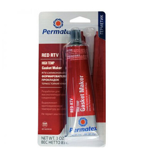

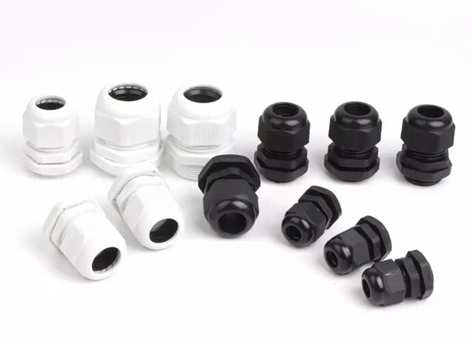

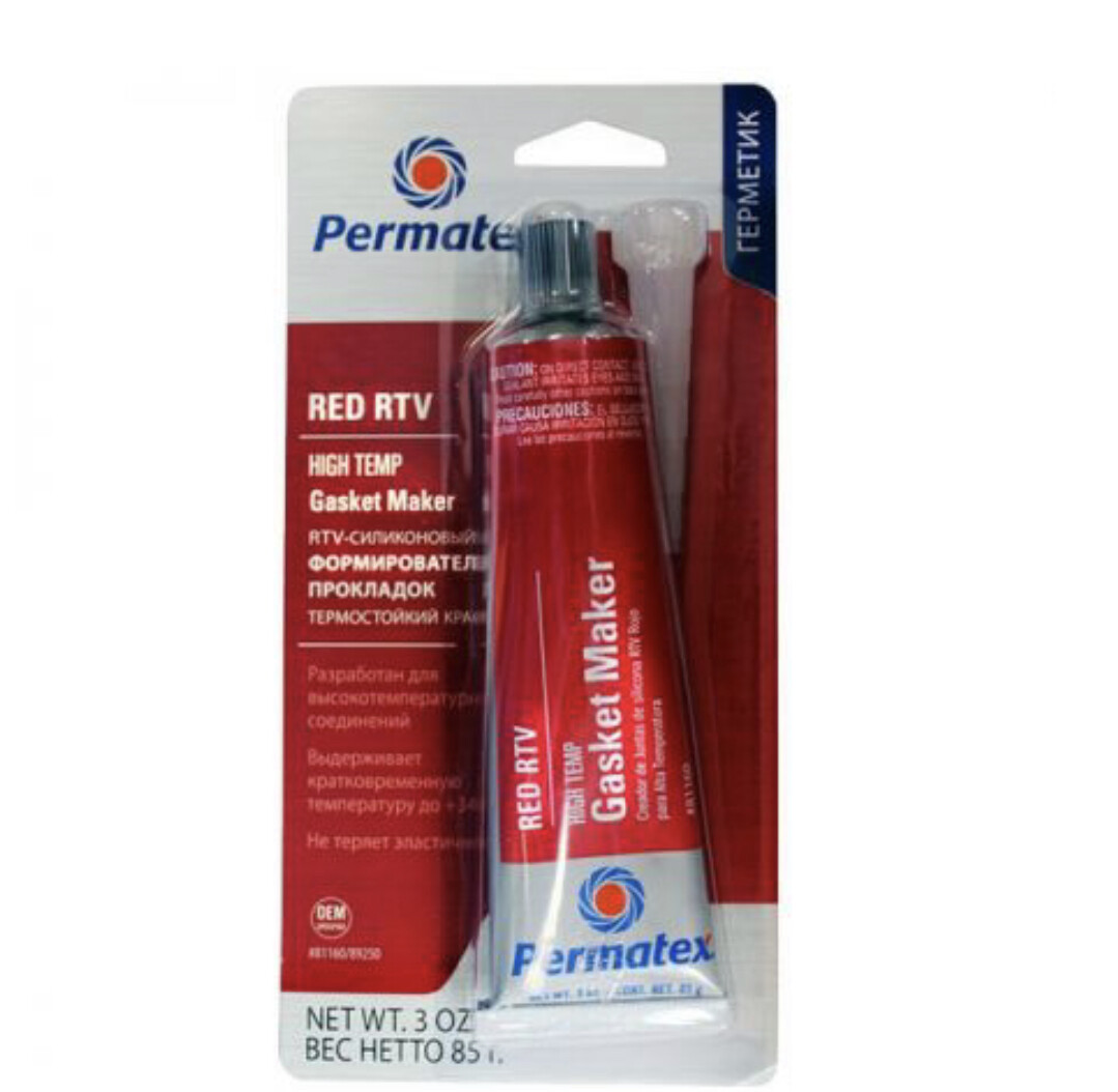

I usually seal both sides with silicone or liquid tape. During riding in snow there shouldn’t get much water inside anyways. I do clean cables from snow with a brush directly after I come home. If there still getting a bit water inside the box I don’t see a big issue as long as it’s getting dry before switching on the board again. Different story with a battery box but there you could probably use something like this
Also I’m lately trying out gasket maker.
Something like this
Seems to work well but did not do too much of testing with it yet.
