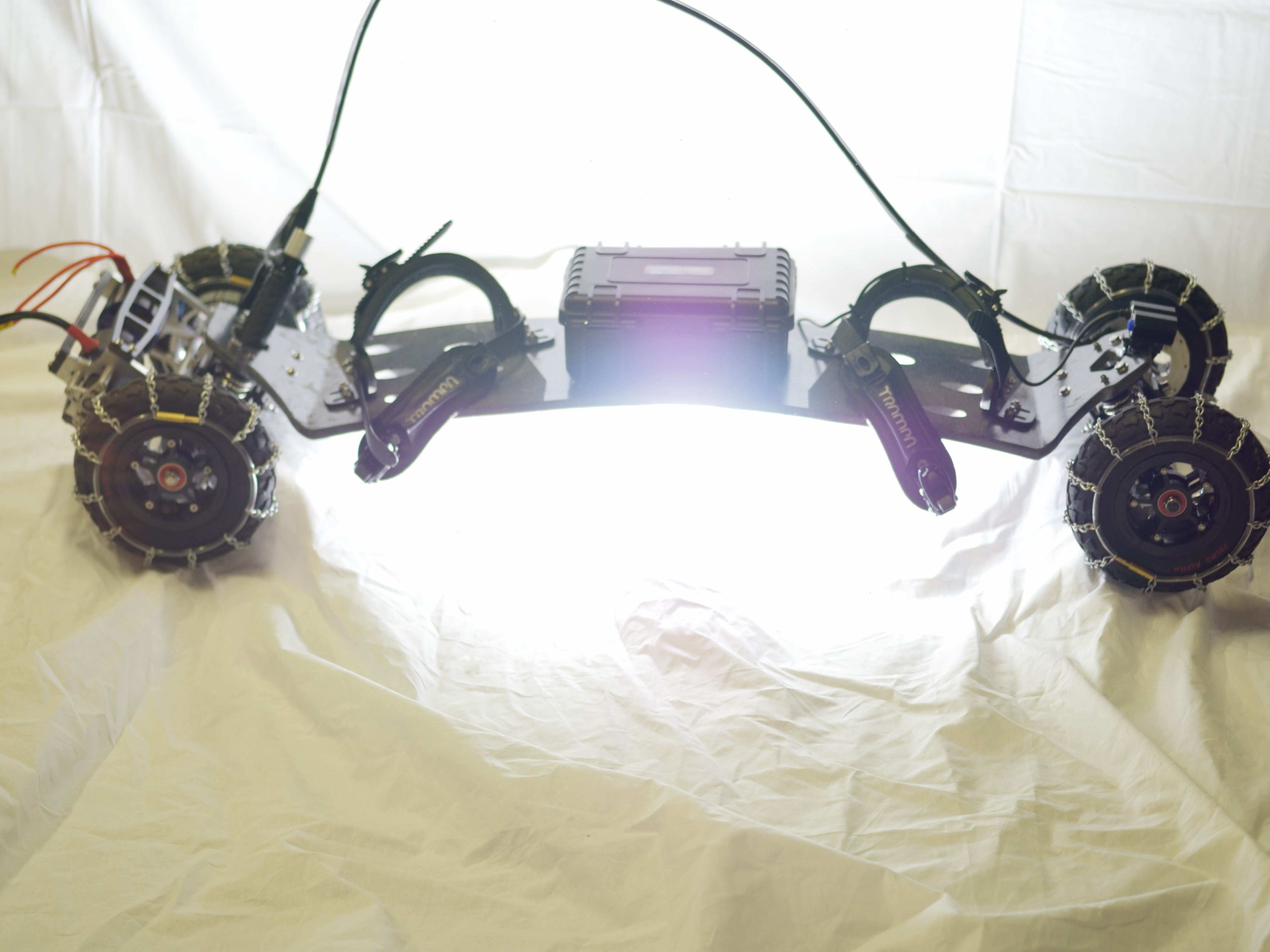

@Mainflow Have you seen/heard of someone successfully using custom tire chains on an esk8/MTB?

I don’t think it’s been done but don’t let that stop you from being the first!!!
I’m honestly wondering if it’s possible to do it while working around whatever drive system is in place. Hub motors would be the easiest to work with, but I’m gonna have to work around a gear drive. Still, definitely something I might try out. I’m getting some inspiration from this style of shoe chains… maybe there would be two rubber rings with chains between them that could easily be put on to pneumatic tires… but I don’t know anything about fabrication, so I’ll have to do some more research :stuck_out_tongue:

If I remember right @Chibatterysystems made some chains for 8“ wheels back in 2016 or 17. Haven’t been cheap thou and I don’t know if they really worked out.
Found it @T-Nomad
Nice! That thread led me to this link http://www.slipnottraction.com/ where you can order custom sized ones! Awesome.
