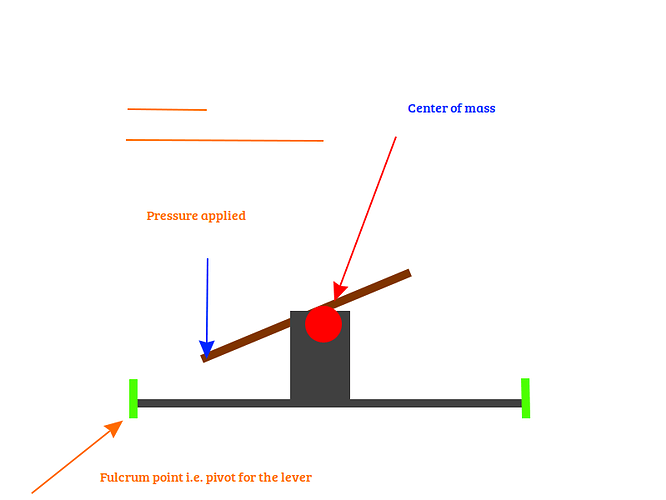

Think of where the kingpin is located and you have the answer. If you’re leaning enough to get your opposite wheel off the ground, I’d say you’re almost certainly on your way down.
To me it seems like the lever has 2 arms – 1 from the wheel against the ground (fulcrum point) to the center of mass of the skateboard, and the arm from the fulcrum point to the edge of your deck where you put your force to turn the deck. If your hanger was 0mm wide, the skateboard would tip over instantly, because of infinite leverage.
And I believe that in my drawing, where the trucks are wider than the deck, it should be impossible to tip the deck over, as long as you apply the force directly downwards. If you’re already falling to the side, and put force on the deck from the side as well, then maybe? you can tip it, although I think your wheels need to slide out for that.
Just playing around with my board I can’t get it to tip unless I pull the deck to 1 side with friction, or if I apply pressure to the part of the deck that’s wider than the wheels.

I think the width of trucks is also related to the wheelbase length, and to the baseplate angle through a magic formula. Just a matter of geometry.
Leaning on a truck at a set angle will define a curve radius. You want the 2 trucks to be essentially in sync with that curve. And that’s where the wheelbase comes into play. Any significant mismatch and you’ll have something with a tendency to oversteer or understeer, and that just relies on the traction or slip of the wheel to make that curve. And for a given duro and contact patch, those are speed dependent…
