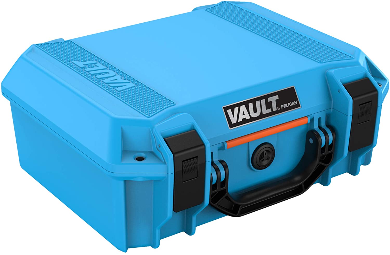

I actually like the look of the “peli” style cases. I’m not saying the homemade ones could look better but like Alan @eBoosted said already they are cheap and have all the features.

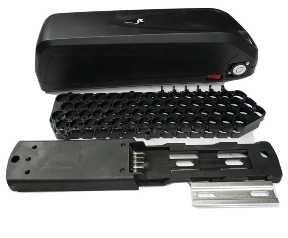

I was thinking about using e bike battery enclosures so I can use the same battery’s on my e bike and e board. If you stick to the same mounting type you could also easily switch between light jump packs and bigger long range packs.
Aren’t most of those 13S or 14S though?
I saw these slide on one’s and was super pumped until I remembered I have bindings in the way :expressionless:
I really like how my 60v lawnmower battery slides in and spring clips in. Idc as much about the slide in prong contacts but if I could unplug the battery cable from the enclosure box, undo the spring clip or buckle clamp, and take a whole enclosed battery off in under 10 seconds, I’d be in heaven.

There are also ones that slide in sideways
their key latching method of locking the battery to the mount is actually not bad

from an ease of design standpoint, why not simply make something that looks good, and covers an existing, functional box, like a pelicase?
I had planned to make or buy a Pelican battery pack and plug it into whatever board I’m riding. Would save some money over multiple packs. Make sure there are USB ports so the box can be used for other stuff too.
I mean it’s more weight, but aesthetic mods could be cool. Pelican cases are pretty bulky to begin with

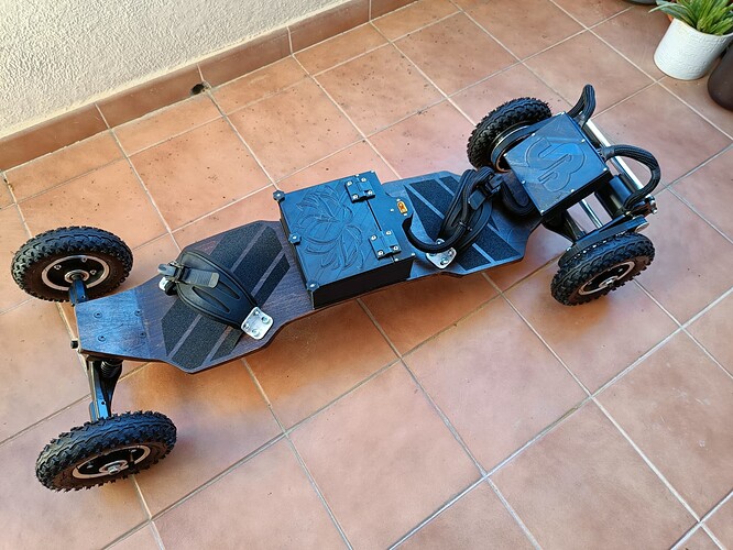

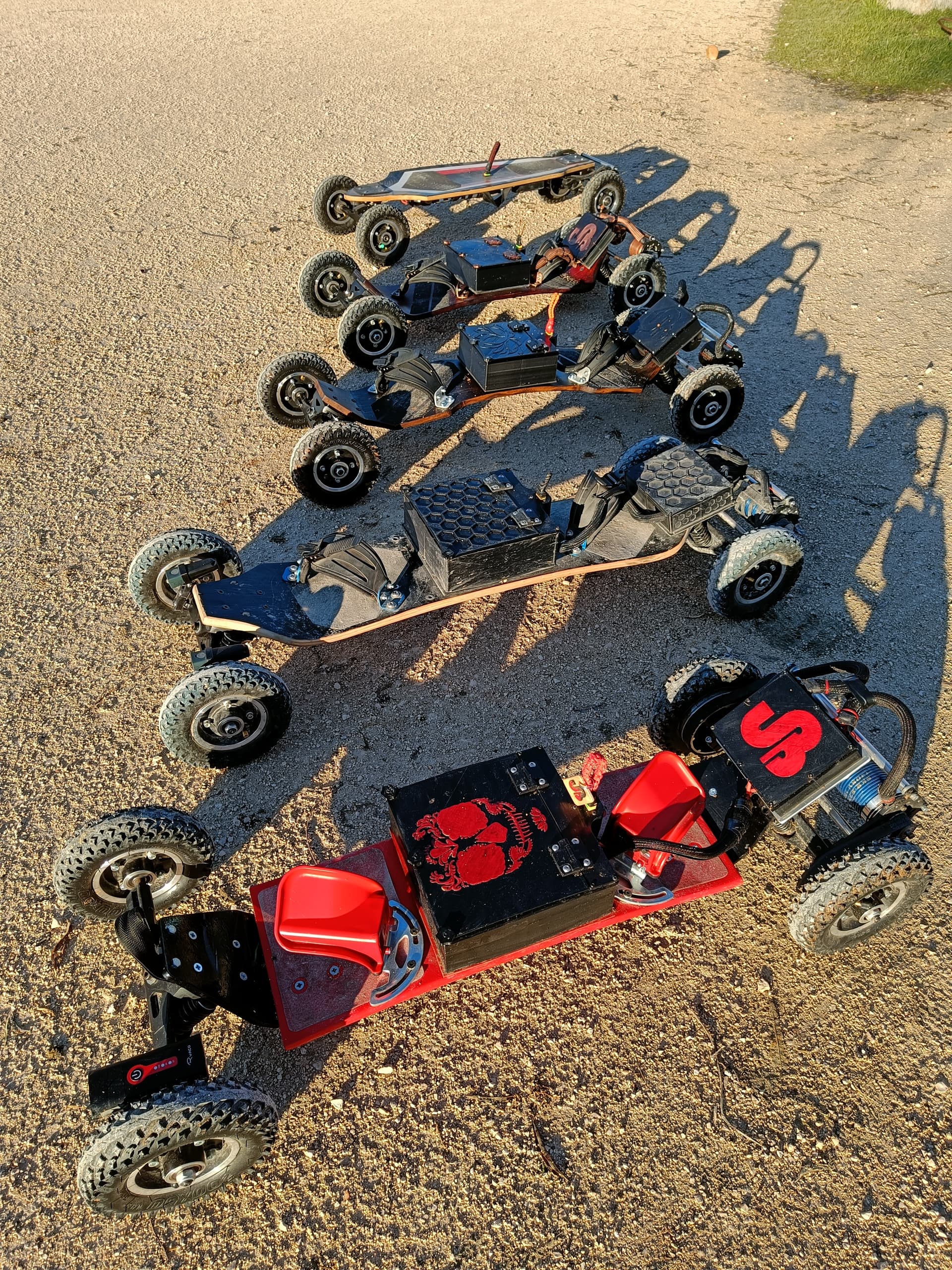

My 2c:
Same concept, four boards.
  • 3D printed sides, loopkey holder, hinges and lid.
  • TPU gasket all around (splashproof)
  • Thumbscrews go into brass inserts, easy to open to charge LiPos
  • Wooden bottom screwed on to the walls, silicone between them.
  • Inserts in the deck, 4x M5 screws, 4x washers and 4x TPU spacers, done.
It’s cheap af, I let my friends customize the lid and it’s proven to survive hundreds of km. I know it’s not for everyone, but I’m pretty happy after several iterations.
