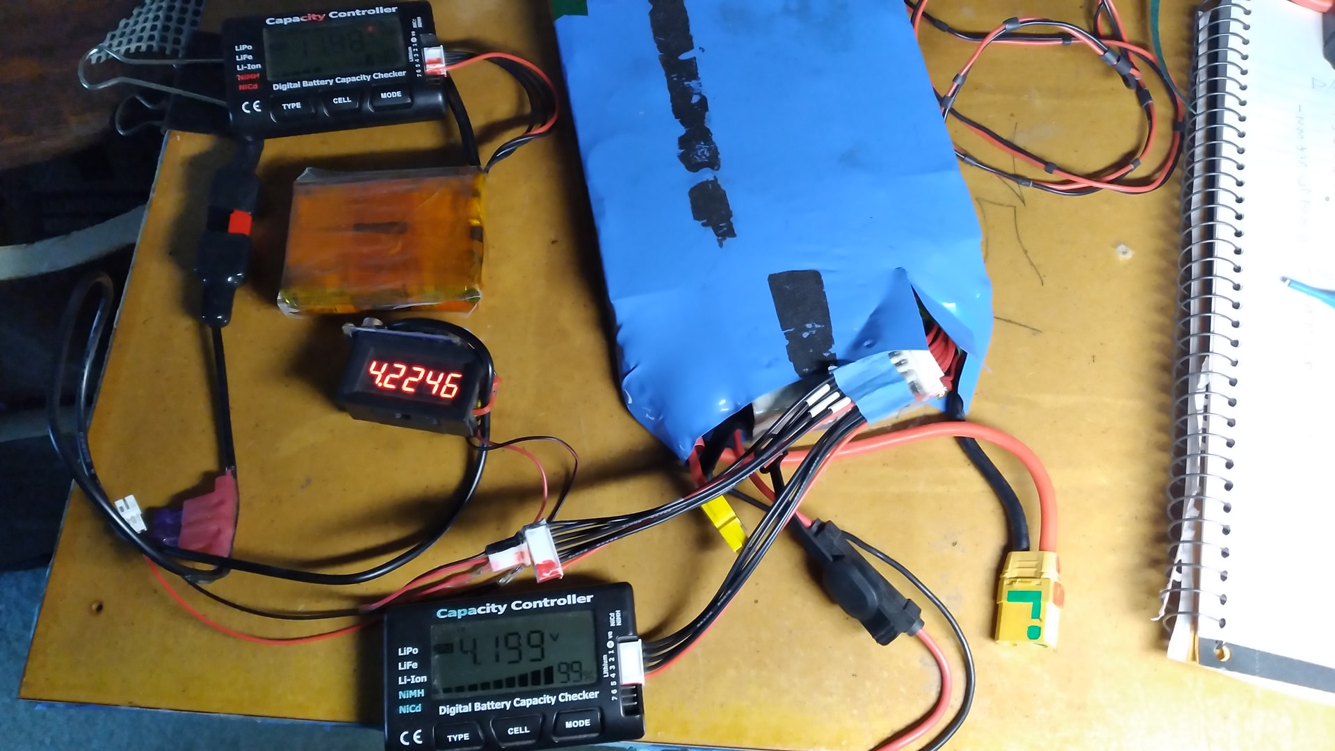

I was recently using this as a top mount range extender pack, its XT90s into a parallel ESC feed, and it was not getting too hot in this shared duty.
Pulling it out, I pulled balance connector and hooked up my dual 7S capable ‘capacity controllers’, 6 cells on one unit and 4 on the other.
100mv delta at storage voltage, and delta was the same at near full charge, and 500mV out at ~32 volts.
Twice, I charged it to near 41.6v when I choked max current to 0.22 amps then bumped up target voltage to 41.8v, and then, when amps read 0.00 on my inline wattmeter, bumped up voltage by 0.03v, in 5 or more stages, and some of those stages lasted overnight.
When i’d wake up to piss i’D turn it up 0.03 more voltage and amps would increase back to 0.14 again, and be at 0.00 next time I looked.
The order of the groups from lowest to highest never changed, and the Delta was almost exactly the same after these ‘balancing charges’
Still 100mv delta. Both times. Slow 1 amp charges to 41.6 v, then 0.22 amps to 41.8v, then bumped voltage up in no less than 5 stages to 42. This should allow 30ma bleed resistors to at least do SOME balancing.
It did twice disconnect the charging source when cell 10 hit 4.25 volts( group 7 was 4.149, both times)
I have since manually injected groups 7, 1, and 2 with a 4.2v supply set to get them closer to the other 7 groups.

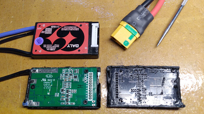

I still have the BMS which spent 20 minutes submerged in the bay while smoky bubbles emerged from enclosure and my Supraspinitus was torn in 2.
Wonder if I should chisel it open for science?
The BMS, not my shoulder.

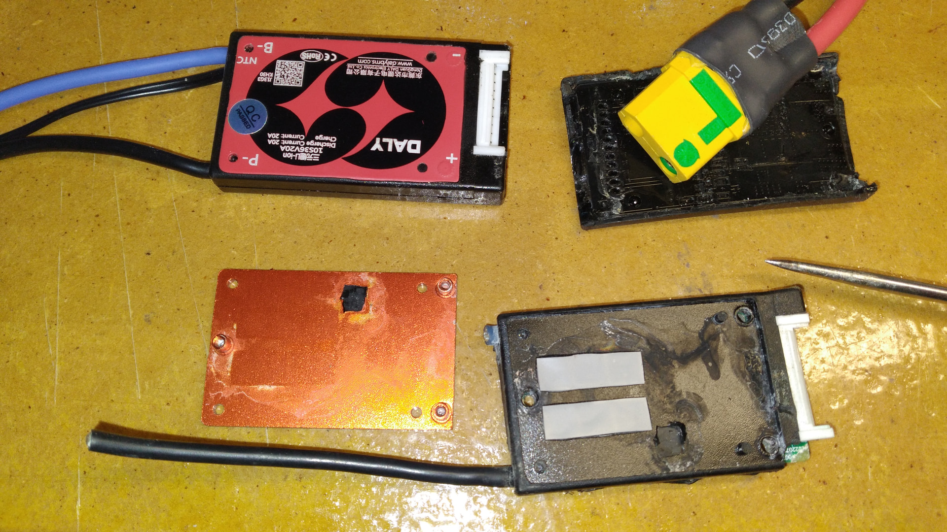

The submerged Daly BMS next to my newest one.
Their attempt at waterproofing needs some work.
Looks like it seeped inside around the P- and B- wires, and around the balance connector pins.
it also got down around the sides of the red heatsink and onto the thermal pads.
Granted this was submerged about 2 feet under water for 10 minutes or so, before I was able to lasso the front truck ‘s floating pneumatics and pull it out.
I can take better pictures if requested.

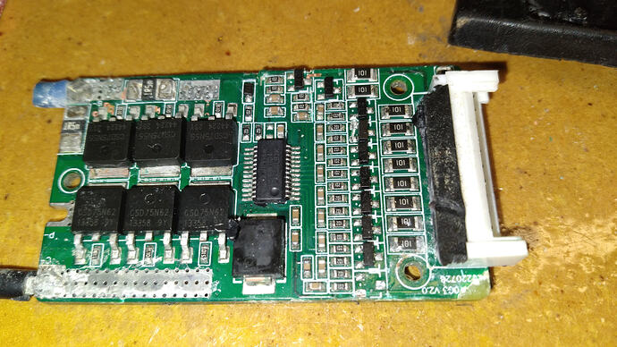

If it means anything that last image shows that the BMS has the ability to balance using two 100Ω resistors which is about 21mA at 4.2V ONLY if the balancing current is at 100% duty cycle. If an adjacent channel needs balancing the BMS will typically alternate between the two channels to prevent overheating and that = 50% duty cycle.
That averages out to about 10mA balancing current.
10mA should have been able to have changed the imbalance on my Dmegc pack, considering I had it connected for well over 24 hours above 4.18v and under 4.25v, but it didn’t.
So either this specific BMS’s ability to balance properly was faulty from factory, or my hooking up the B- wire, then the balance connector, in the opposite order as listed in the instructions, somehow neutered its ability to balance..
I do not have tools which can measure 10mA of current, so i have to observe whether imbalance changes when balancing conditions are met and held for long enough to have an effect.
