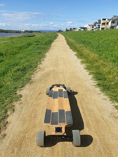

Ive been looking for a slighly bigger Abec wheel to get a bit more clearance on my gear drives. My top end is going to be screaming if i get these I’m on a 2:1 ratio now with my 107’s.
What gear drive can you use with 107s? How much do those even clear the drive?
I have Idea’s gear drive that he made for the Evolve trucks. 20x40 tooth straight cut gears.
This is a older pic. Its still the same today except i dont have the light in the center and my wheels are chunked abit.
Neat, I never knew a gear drive existed for evolve trucks.
They’re nice drives but the 2:1 ratio kinda sucked for me.

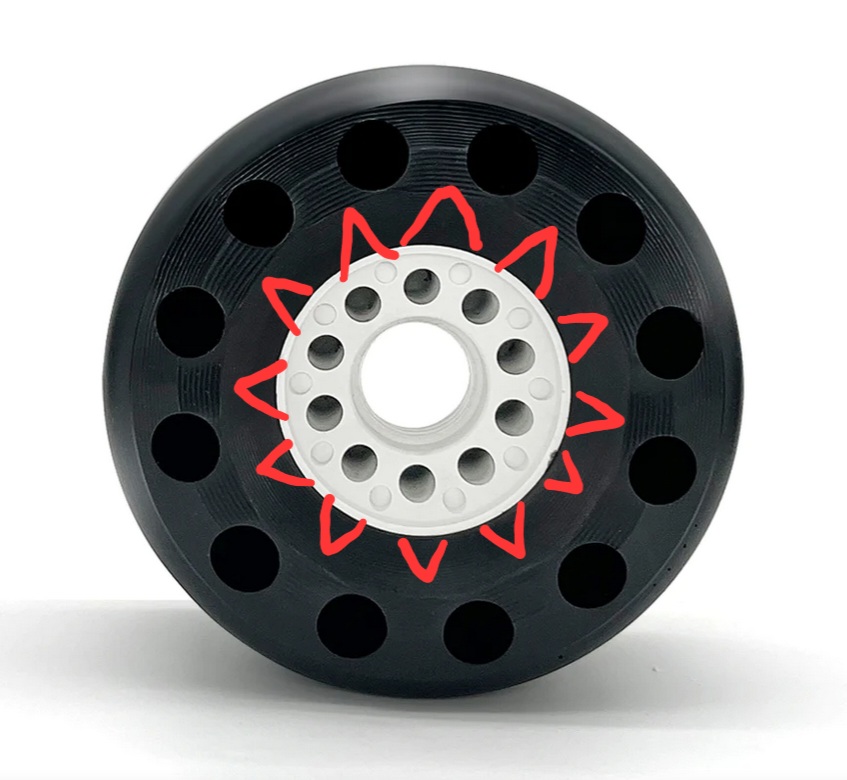

I always wondered why most cores don’t have a better “lock” with the urethane. I guess it’s because traditional downhill riding doesn’t put much rotational torque on the core… mostly sideways loading instead.
For a dedicated esk8 wheel, I wonder if adding something like this to the core
Would prevent this type of failure
TB110_delam
