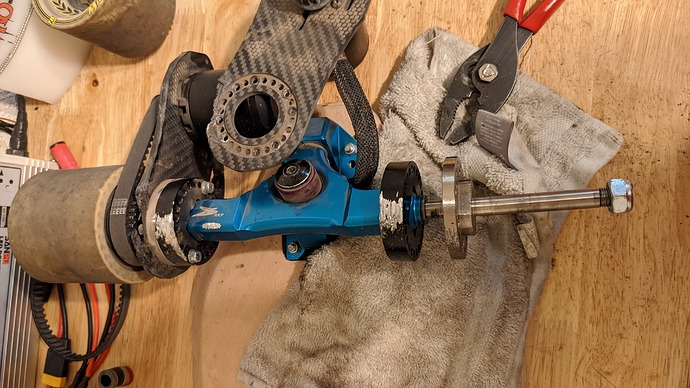

Ok update time. I took the other axle out. This one was cracking too. If you own a set you should check.
Wow, that’s crazy. You can see the crack! Was the axle bent as well like @Saturn_Corp?

Couldn’t see any bend in mine.
Yeah definitely if you own a set, take them apart and check each one especially @Saturn_Corp. That bent one didn’t look too healthy. I just don’t want someone getting fucked up is all.

Went to check the ā€œmore bentā€ axle today. Have trouble getting it out of the hanger. Super difficult to rotate out, and at this point it’s just rotating and rotating and won’t come out the rest of the way. Might have fucked the insert when switching from 5mm to 2 mm spacers and cranked it in.
Wd-40 helped a little with making it rotate easier but no dice getting it the rest of the way. I wouldn’t think the axle is still threaded into the insert but it could be since it’s not coming out.
No sign of cracking but not sure if it’s bent yet. I keep thinking yes, and no. I need to completely remove it.

Almost certain this is both material and design flaw
That corner is way too sharp, even a 0.5 mm fillet do wonders to reduce stress concentration and thus fatigue

If you have a drill press and a tap kit you can drill it and then tap it then put some long cure 2 part epoxy in it and then a bolt. Come back tomorrow and use a wrench to remove it.
That’s assuming the helicoil isn’t shredded. I’d that’s the case you might scar up the inside so much that you cant put a new axle in it.
That being said, I have 2 sets of Matt’s axles with 100s and 100s of miles and have had zero issues.
I suspect theres a burr or something on the inside. Or debris or corosion. Anti-seize helps this
You need to get pulling pressure as you rotate. Rotate the axle by hand or with a drill while pulling on the axle. You can use lots of things to allow rotation while pulling, but that should do it. If it spins, itll probably come out.
