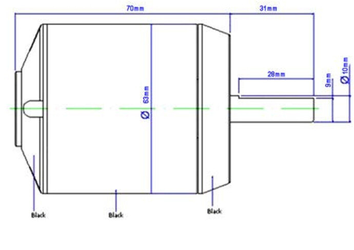

My old motor pulleys is:
15 Teeth, 15mm wide, D shape 9mm x 10mm.

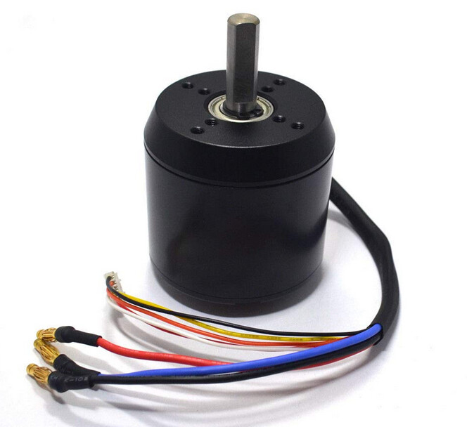

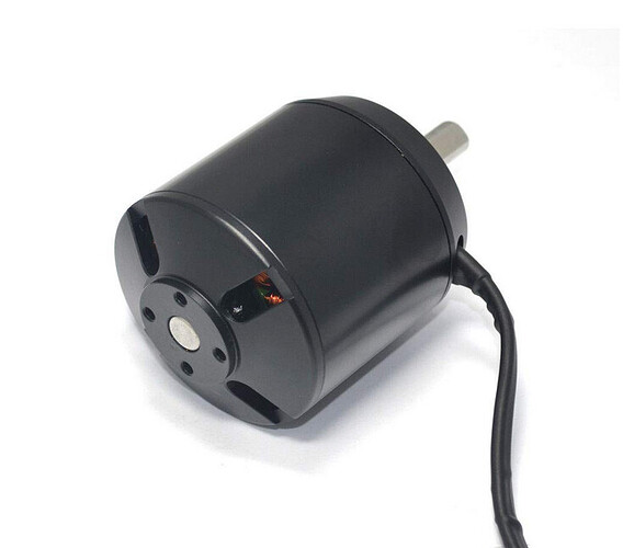

Motor:
C6374 170KV Efficience Brushless Belt Sensored Motor for Electric Skateboard Longboarding (C6374, 170KV)
Link: https://www.amazon.com/gp/product/B07PNMYHFT/ref=ppx_yo_dt_b_asin_title_o08_s00?ie=UTF8&psc=1
Pics:

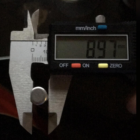

Interesting Do you have calipers to verify that the shaft size is actually 10x9?
BRB

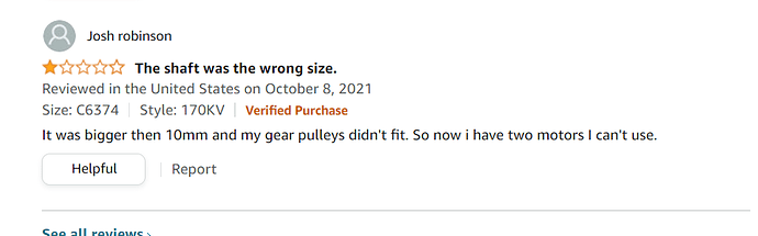

Here was one of the reviews, which is why im asking

That’s because… It’s not designed for flipsky motor pulley.lol The dimensions for the shaft is always 10mm x 9mm. I did contact flipsky about their motor pulley. Their motor pulleys is proprietary. I didn’t know.
