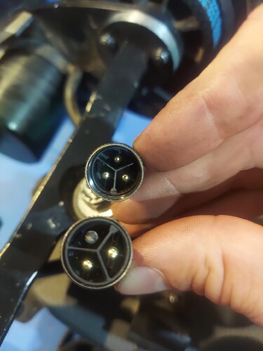

Wheel lock 1 motor in Backfire Hammer-Sledge 4wd. Please Help

bro if it’s not long enough just unscrew it off the motor mount and hold the wire by hand, try to plug the side with issues with another motor and do the same with the ESC. This will tell you which part of your system is damaged and then you can contact backfire for a replacement, which is what you should be doing in the first place, not seeking ā€œhacksā€ on this forum. The price premiere you’ve paid by getting a production board includes the service.

So if i were to plug the faulty motor into the other side and the same thing happens, what would be at fault? The ESC?
Inspect the connector, look for any deformations or signs of a burn (compare against a known good motor)
Swap the motor with a good motor, see if the problem is with the ESC or the motor

If you swap the motor (just the motor) and the same wheel has the issue then it’s the ESC, if the other wheel has the issue it’s the motor
1 burnt out prong in the faulty motor
Either you ran the board without the connector seated and that caused it to arc and spark, or something melted (phase short inside the motor, or blown gate in the ESC)
Do the motor swap test and report back to us, also sniff around the motor and ESC for smoke
