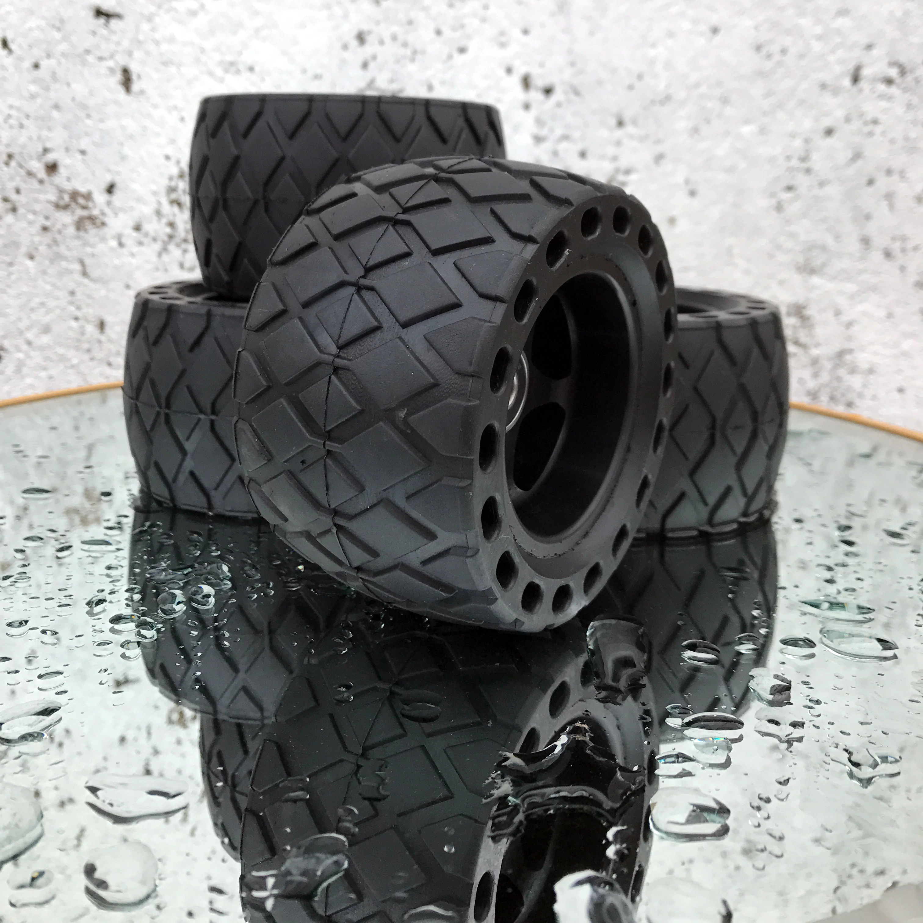

Hey, just found these wheels on aliexpress, 1st time i see them.
Anybody heard anything about those ?
Not sure how we could fit standard pulleys on those, might not be to hard to 3d print an adapter tho.
But do you think it’s very different?
Or just kinda meh?

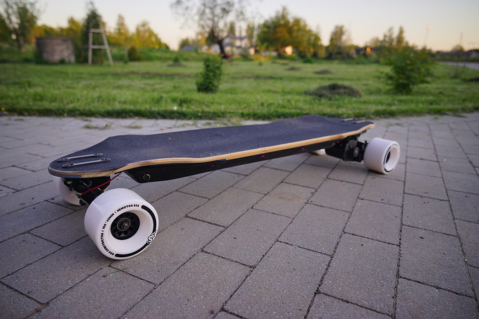

Finally got my 100mm Boas. Switched my brother’s board off the Popoca 78A 90mm wheels to these.
My thoughts:
  • Definitely look a lot bigger.
  • Weight difference – can’t tell once they’re on the board.
  • Softness – both to the hand, and on the board, feel like 78A.
  • As such, vibration dampening while riding felt basically the same.
  • Because they are bigger, they do go over debris easier, but because you are higher from the ground, I feel less in control of the board. Maybe they would be better on an even wider hanger. Because of this reason, I actually prefer the Popocas.
  • They look so nice when they’re clean. I recommend getting a dyed set from nexusboards.co.uk if you don’t like dirty white.
Conclusion: The clearance these wheels give is quite necessary for my brother’s board due to how low the motor mount hangs. But because he doesn’t ride as fast, I think I will get him soft TB wheels instead. I will be using these wheels on my Neo deck, if it ever arrives :eyes:
