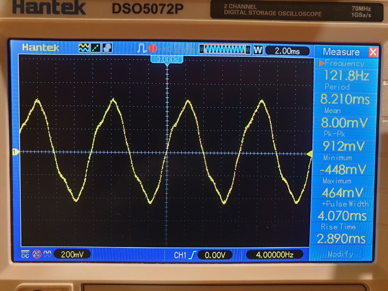

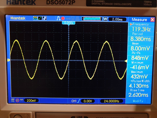

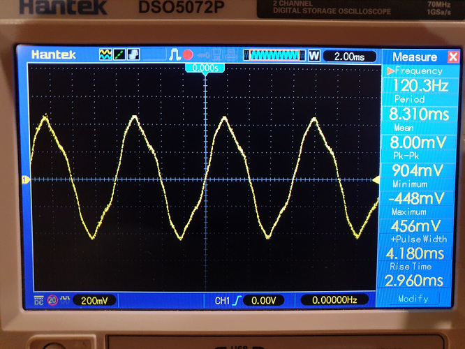

A friend helped me and tested the motor with an oscilloscope, adding photos of the 3 phases tested with it. The motor was spinning with a driller.
Phase B is the only one that looks clean, WDYT ?
Phase A:
Phase B:
Phase C:
You’ve got substantially different results for inductance and resistance in the test results u posted above. Different between the green and white. Don’t know which is which but very different. Shows badly there.
Surprised the oscilloscope showed such a clean sine-like wave for the phases as mostly they’re more trapezoidal for these type motors. I don’t know much bout that but ur R and L results say enough to know the motor is not right.
