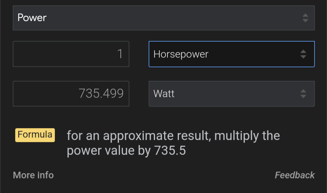

Anyone know what the official or estimated HORSEPOWER the Lacroix’s offer? The new SKP boasts 27 horses so just wondering about Lacroix’s.
Horsepower is just watts / 745. Invented to communicate steam engine power or some shit like that. Ironicallly the HP unit was invented by James Watt.
Uhhh taking a guess here… 130a (battery amps total) x 18 x 4.2 x 0.95 = 9336w or 12.5 ponies.
The better way to calculate this would be to use the ultimate esk8 calculator for both setups to give you the max launch force for both boards.
Edited to correct typo
I’m getting this from Google, but it seems like it’s slightly different everywhere I look??
Nice. You may be the 2nd smartest person I know. Lol I just read that the new SKP eboard has 27 horses so just wondered about Lacroix but that makes sense.
SKP builds the most powerful esk8 completes available on the market. Nothing else really comes close. The combination of 4wd, 18s, and high amp esc results in crazy top speeds but also a lot of force available at the wheels.
