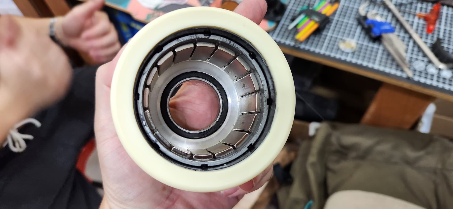

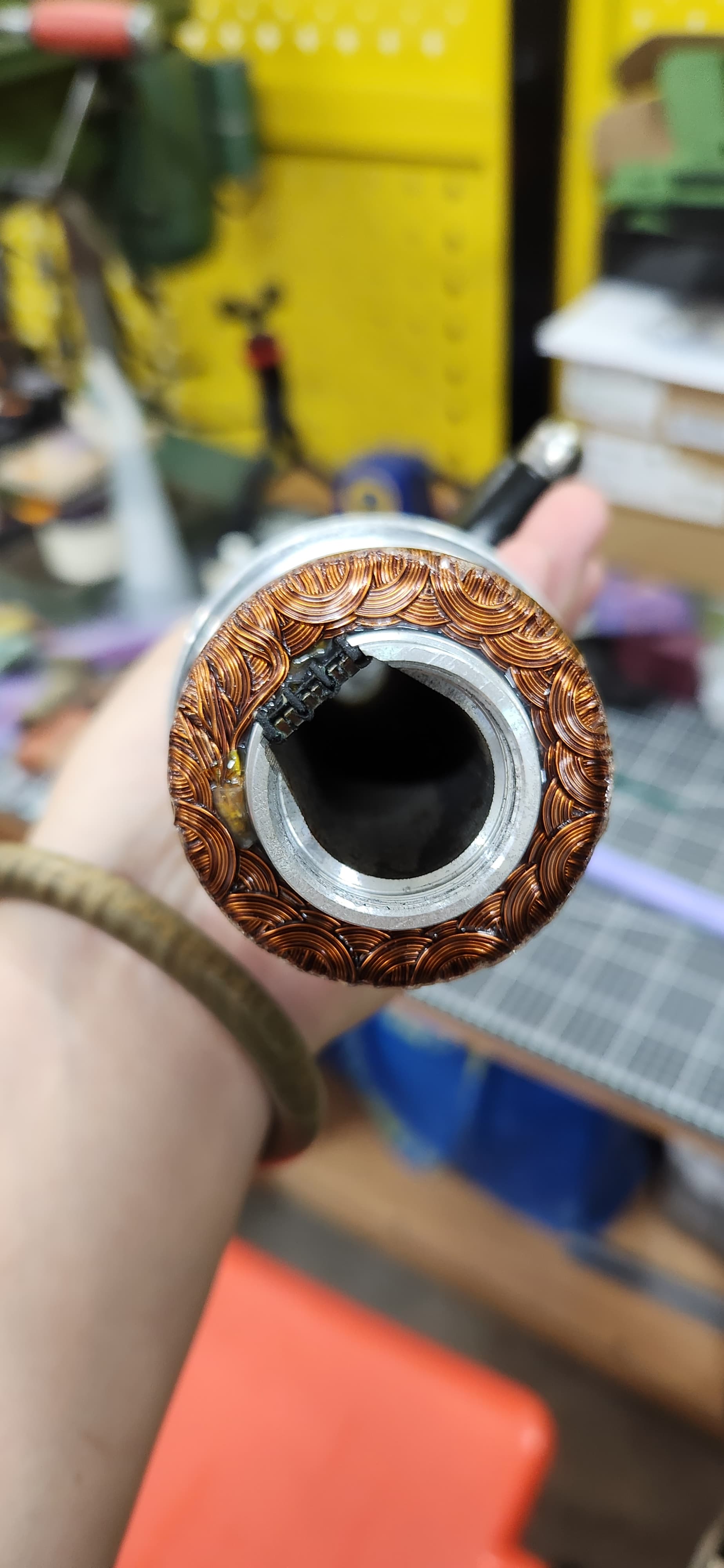

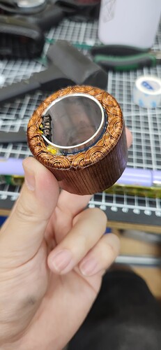

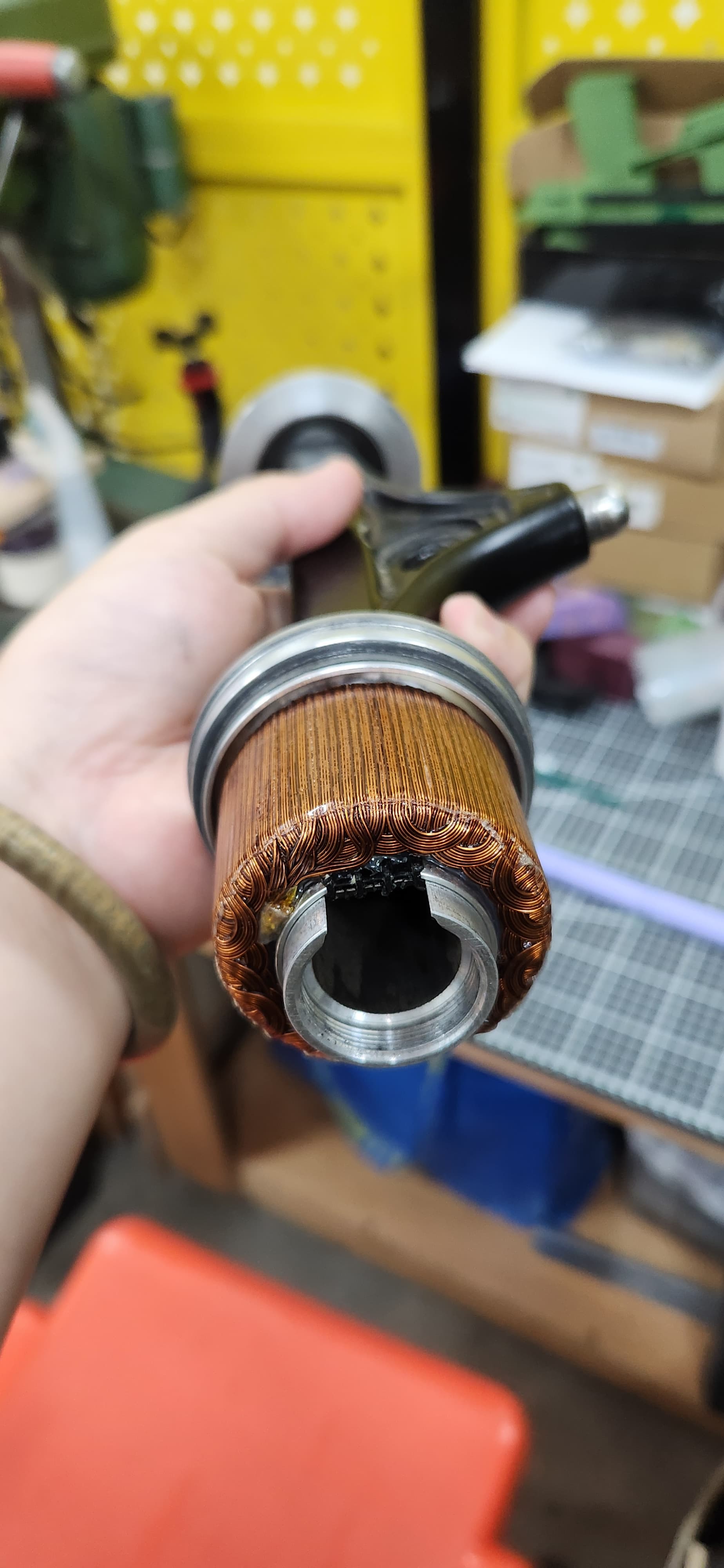

A friend got a set of these Jaykay trucks. For the uninitiated, these were the true stealth components for a stealth build.

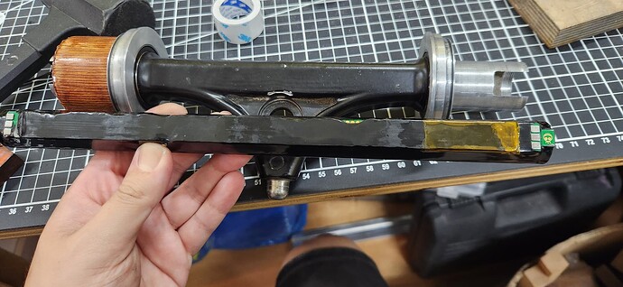

Four cells fit in the truck hangar, and two hubs connect to the hangar. You could do a 4wd with 8 cells too.

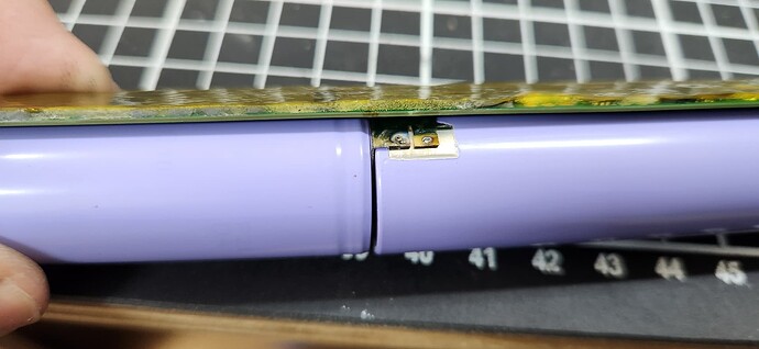

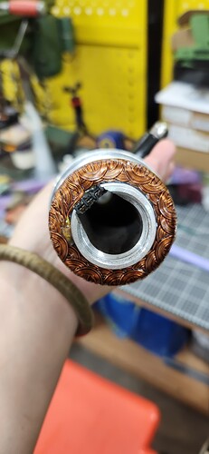

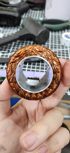

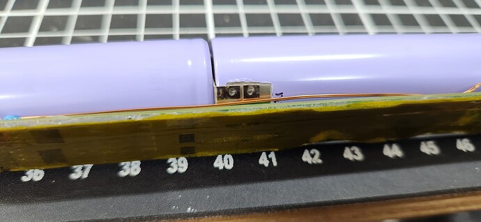

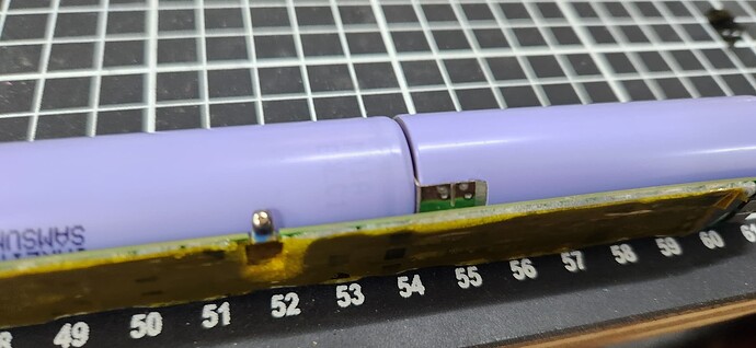

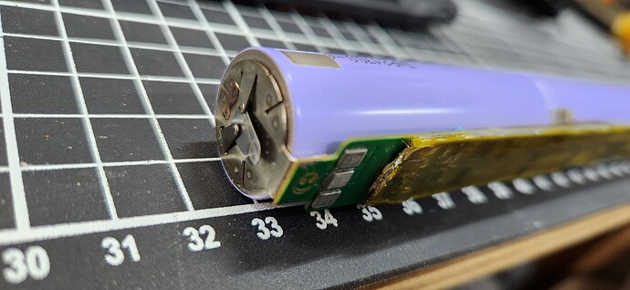

So after a few years, the battery is dead dead. I was given a chance to try and save it, so i opened it up.

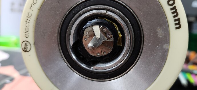

The cells seem to be spot welded in a 4s1p to a custom PCB. Both ends of the PCB has 3 pogo pin tabs where i believe it connects to the phasea of the motor. Also, the PCB then has a raised nickel button where it connects to a pogo pin on the inside of the hangar hole, which then connects to the pivot cups pogo pin, to the baseplate where the USB C is to charge. I have to be very careful on making sure that they align properly when putting it back.
I am going to see if a P42A cell can fit in the hangar slot. If yes, i will carefully dismantle the Samsung 40T cells and replace it with those.

Where’s the BMS and ESC in that thing?
I think both are that PCB going along the length of the cells

21700’s have been growing in length and width.
The series connections on the sides of the can suggest there is little room to stuff them inside the hanger lengthwise.
Even if the cells will not approach their CDR in this application, I’d personally still want one which runs cool, which the Samsung 40t is comparatively not known for.

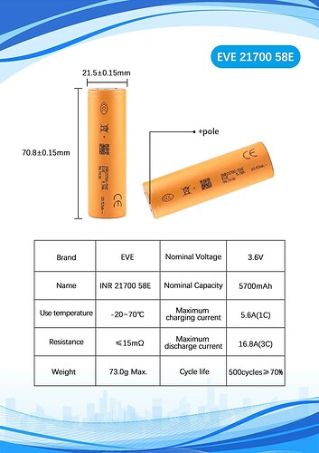

If capacity is more a concern than temperature or CDR/voltage sag, the EVE 58E could be a good contender, but 60C max.
But how much extra length and width can be fit inside?
If it doesn’t fit, it doesn’t matter how it performs. I also wouldn’t want reliability or safety compromises because the cells are too big. Clearly, this isn’t designed to have extra space.

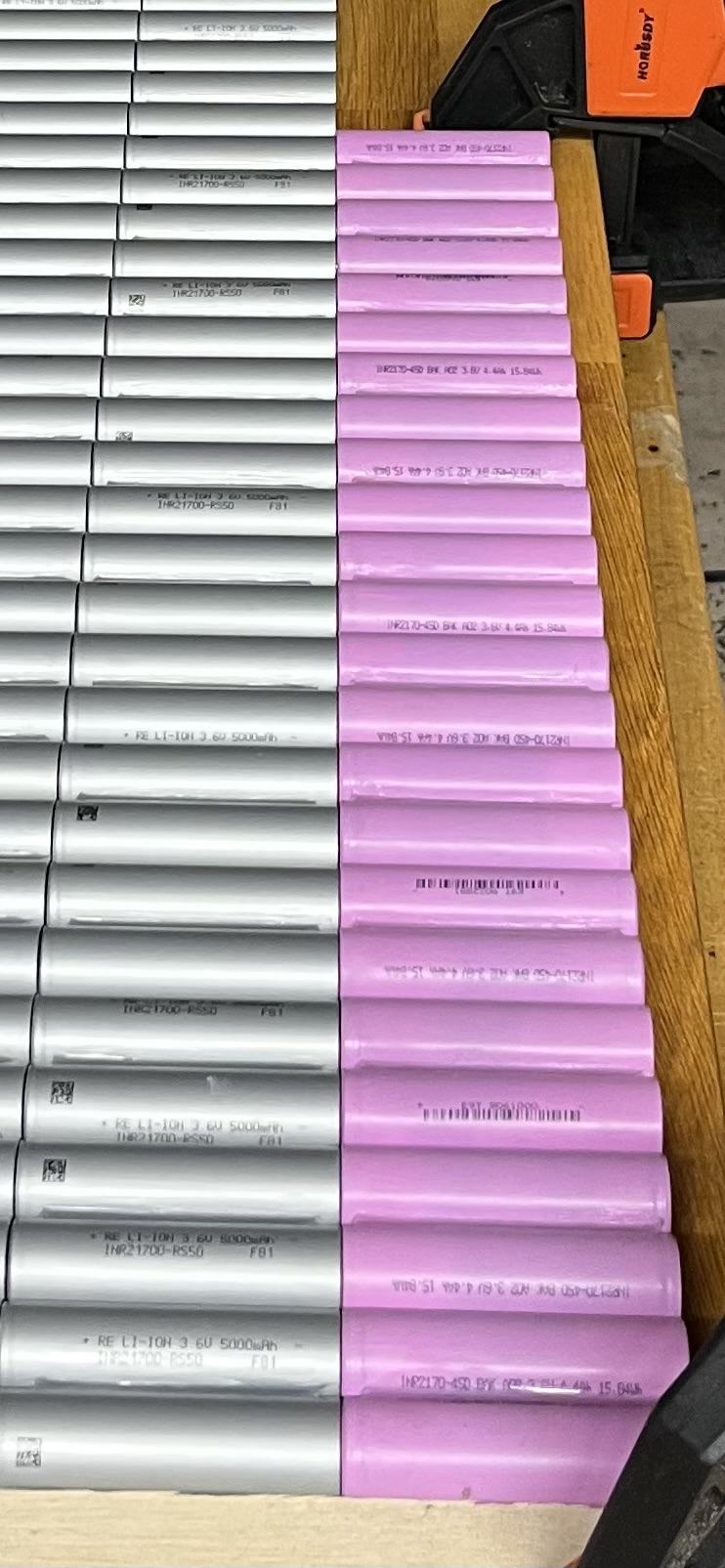

Just my observation, the rs50 are smaller than the bak45d in circumference. Stacked side by side
Rs50 left grey. Bak45d pink right

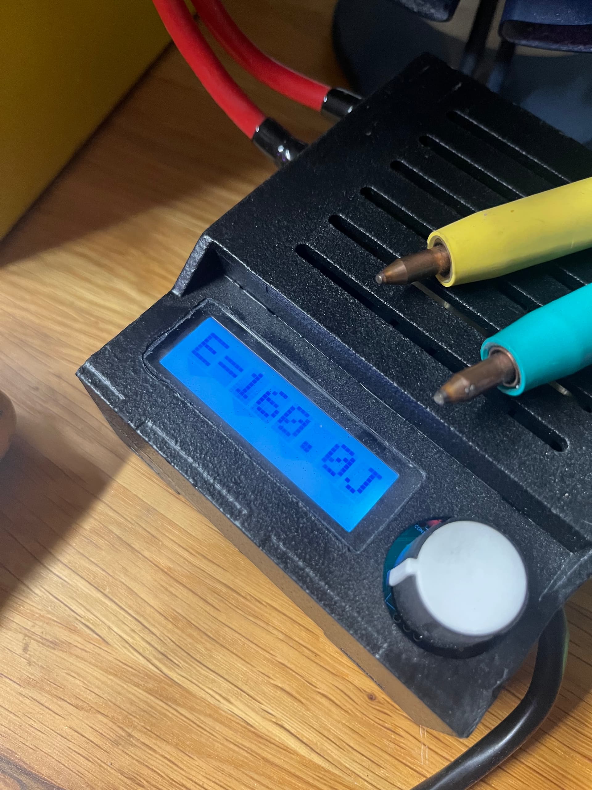

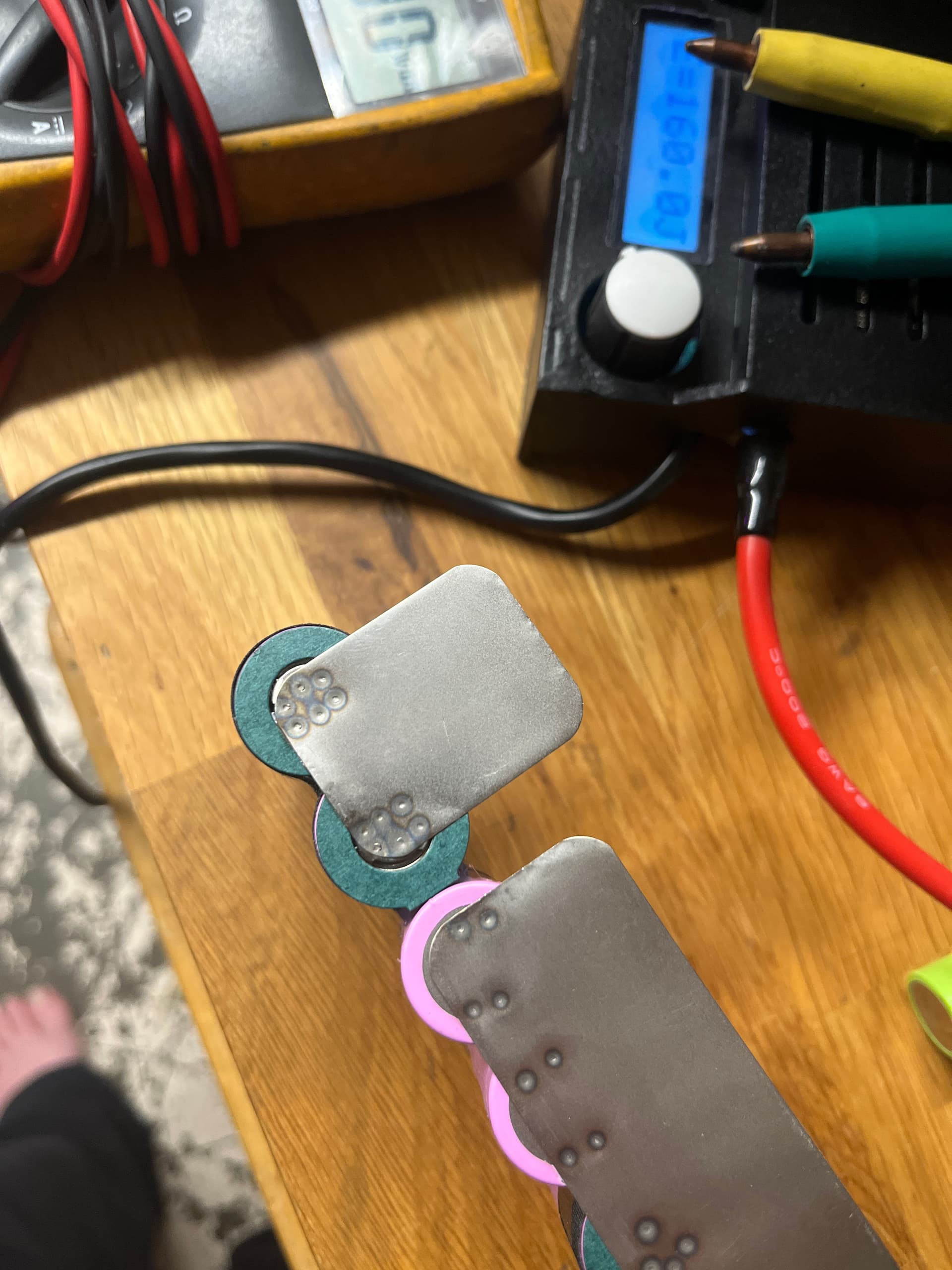

Another concern might be the heat of the weld. I found out the bak45d cells require a huge amount of energy to weld well.
I have test cells of the rs50 showing up soon to test as well but i was blasting the 45d cells at 160j to get a good tear off on .2mm nickel that welded p45bs at 32j. It was absolutely baffling and amazing how quickly the heat was dissipated by the cells but the welds were look hot af. Further evidence that a good spot weld is about the test and not the look

When I welded My 10s2P BAK45D (non CCC) I used 0.1mm copper and 0.1 Nickel plated steel sandwich and a cheap welder with a cheap 3s weld LIPO that basically failed on the last few welds, leaking electrolyte. I was nearly maxxing the welder pulse duration out, and it seemed the positive tabs required more pulse duration than the cans did, and that was ~15 to 20ms more than on P42A and DMEGC-26E, which I wrote off to the well aged Lipo, but 32 compared to 160 joules is a huge difference.
Samsung 40T(5) on 18650bs says 70.00 mm long and 21.4mm diameter.
This information is good, thanks everyone! Ideally i’d like to choose a cell that is similarly sized to the 40T or smaller by a bit. I had to lightly tap the battery pack with a soft hammer to get the pack out, it’s a very snug fit.

Am retracting my 58E ‘possibility’ at as much as 70.95mm long and 21.65mm in diameter
tightest enclosure ever.
