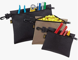

- Compact tool bag
Reinforced bag, set of 3 - $8 - CLC Custom Leathercraft 1100 Multi-Purpose Clip-on Zippered Poly Bags, 3 Pack - Tool Bags - Amazon.com
The middle size (7"x 6") has just enough space for a small amount of tools.
