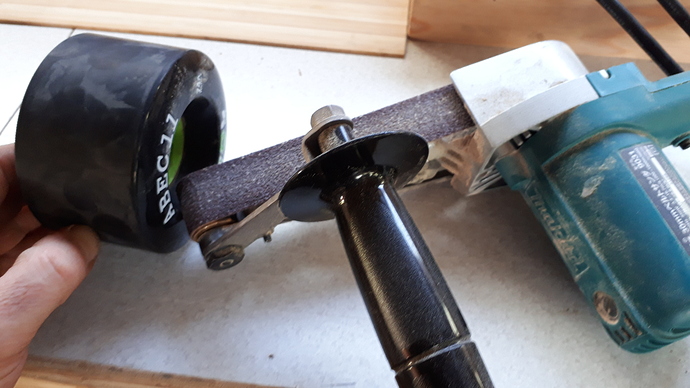

I would actually describe the feeling of my slide as a density slide. The wheel is too dense and bounces over the top of the road surface, kind of like a skimming rock. Im tempted to grind the sidewalls out on the abecs to prove it
If I hit it like this I believe I can transform the way these wheels ride to suit they way I need them to ride, which Im completely aware is not how everyone needs them to ride.

Also, @mmaner was correct, your wheels still are not broken in… it’s clear as day from your picture. Before you go cutting your wheels up work on breaking them in. I thought the same thing with my set of superflys, even though i’ve been doing downhill, sliding, and riding flywheels since 2004 and reflex urethane since ~2006 and it still caught me off guard the unpredictable chatter and slipping out until I realized I probably just needed to break them in more. Trust me, break them in more… slide them, carve them… if you wash them with water and there is still any bit of shineyness they aren’t broken in enough. Once they are broken in, they will not have the same chatter / unpredictable breaking looose. You will eventually have much better grip and progressive loss of grip into slides as opposed to sudden loss of control.

Today I will rough them up some more on the running surface and report back but trying to carve with them until surface is broken in is a fairly dangerous pastime lol.

Your picture, I mean its hard to tell without it being a super close up, but it still seems to be a bit glossy with the smooth texture from the mold.
