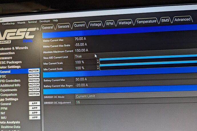

My previous build- 12s8p, would get like 30-40 miles depending how hard I was riding. My current build 18s6p I’m lucky to get 20+ miles on a charge. What is everyone else getting. I know there are plenty of variables, but I’m just curious and thinking my mileage is pretty awful.
What motor kv and gearing are you on
138kv and 72/16
And what are your amp settings
have you changed wheels or riding style? pneumatics eat power like nothing else

I don’t think the calculator does much for my matter. It currently tells me I should get 64 miles. Unless I am doing something wrong, which is also possible

this is 12s though. you can drop the amps maybe?

Those tires are actual junk. I ran them for years. That’s not the cause of your range issue though. What wh/mi does your vesc report?
