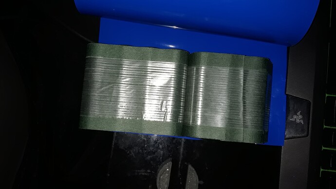

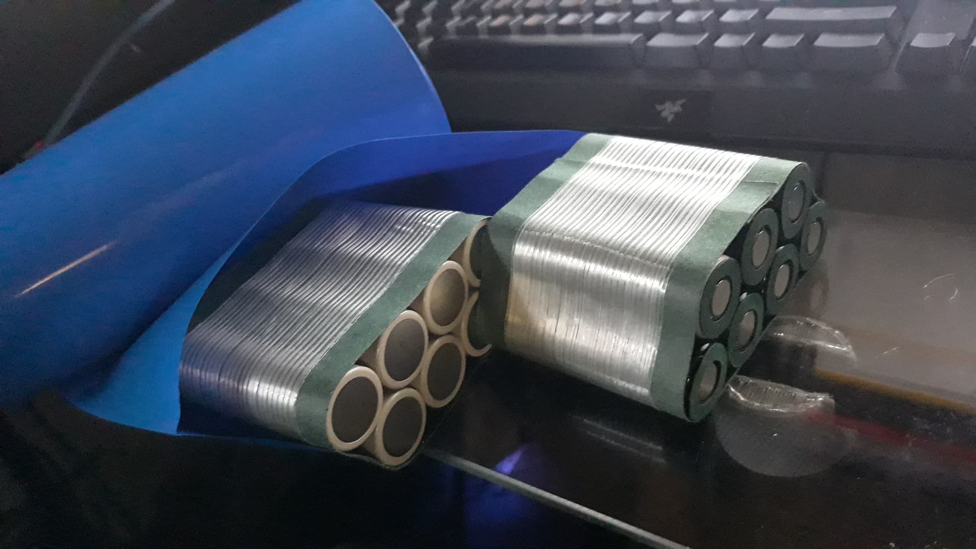

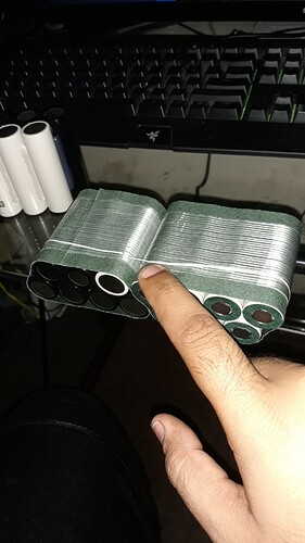

So I made a mistake on my heatshrink size.lol I’m using 21700 and it doesn’t fit.lol I need to order it today, so I could get it tomorrow. It’s 12s 7p. Here is some pictures.
7 1/8 in heatshrink.
